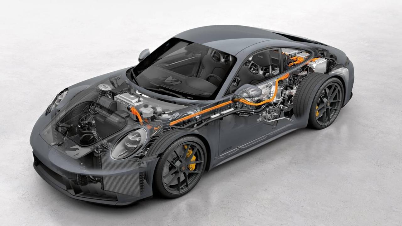

The new 911 Carrera GTS is the first road-legal 911 to feature a particularly lightweight high-performance hybrid powertrain. The newly developed, innovative engine not only allows for another significant increase in power and improved acceleration – it is also readying the vehicle for future emission standards. “We developed and tested all kinds of ideas and approaches in order to choose a hybrid system that’s the perfect fit for the 911. The result is a unique engine that fits with the overall 911 concept and significantly boosts its performance,” says Frank Moser, head of the 911 and 718 series.

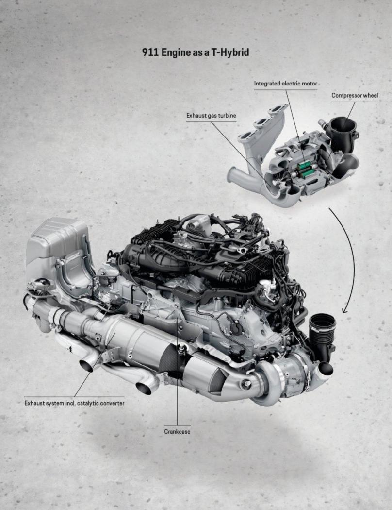

At the heart of the technology is the electrically assisted turbocharger. There is an electric motor between the turbine powered by the exhaust gas and the compressor. Its function: to hit high speeds in a flash upon acceleration and build up boost pressure immediately without any delay. The turbocharger is given wings, as it were, by the small electric motor. “The technology enables responsiveness similar to that of a naturally aspirated engine,” explains Matthias Hofstetter, 911 Combustion and Hybrid System Project Manager. “And the acceleration figures are comparable with those of our all-electric sports cars.”
The acceleration at lower speeds is sensational, confirms Thomas Krickelberg. “We couldn’t have realized the intended performance increase with conventional technology while also complying with future emissions legislation.” Multiple measures led to the desired outcome. The displacement has increased again from 3.0 to 3.6 liters, while the combustion engine now only needs one rather than two turbochargers thanks to its electric assistance – coupled with improved responsiveness and greater dynamism.
“This saves weight and keeps the engine compact,” explains design engineer Reustle. As a result of the high-voltage system, the alternator and air-conditioning compressor could be powered by electricity, meaning that the fan drive was no longer needed. The 20 percent flatter crankcase creates space for the additional components, such as the pulse-controlled inverter feed and DC/DC converter. “We didn’t want to make the 911 any longer, wider, or heavier,” says Hofstetter, “we wanted to make optimum use of the existing package.” This means weight management coupled with a noticeable performance boost. The engine with electrically assisted turbocharger initially being offered in the GTS version delivers 398 kW (541 PS) and torque of 610 Nm. The powertrain also includes a permanently excited synchronous motor incorporated into the new, reinforced, eight-speed dual-clutch transmission (PDK). This assists the boxer engine right from idling speed with drive torque of up to 150 Nm and provides power of up to 40 kW.
All-electric locomotion as with a plug-in hybrid was not the objective with the 911 as a T-hybrid. “Because we also didn’t want the battery to be too big or too heavy,” says Hofstetter, explaining its capacity of 1.9 kWh.
Instead, it benefits from a system-based advantage of the electrically assisted turbocharger: exhaust energy recuperation. The electric motor in the exhaust gas turbocharger also works as a generator. It generates electric power of up to 11 kW (15 PS) that it extracts from the exhaust gas energy.
This is a principle which is both simple and fascinating. The electric motor works like a speed control. As soon as the boost pressure spikes due to higher revs per minute, the motor decelerates the turbine. This generates electricity, which is then fed into the battery or the electric engine. Thanks to this efficient energy recuperation, the relatively small battery is more than adequate for day-to-day usage, especially as the cell chemistry has been specifically designed with the T-hybrid needs in mind. “The technology allows the battery to deliver a lot of energy in a short space of time,” explains Hofstetter, “and be recharged relatively quickly.”
Another advantage of the electric turbocharger: the familiar waste gate is superfluous. This makes it a world first in this form. “The energy that once bypassed the turbine used to evaporate unused,” explains Hofstetter. “The pressure regulation now generates electrical energy.” That has a positive effect on the engine’s efficiency and therefore also on fuel consumption.
