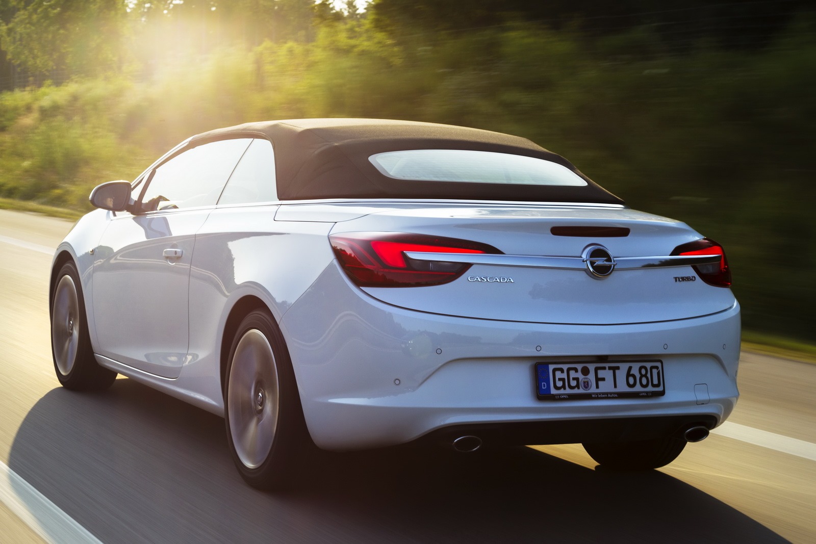

Rüsselsheim. 147 kW/200 hp, 300 Newton meters maximum torque and 235 km/h top speed – the especially powerful version of the new Opel 1.6 SIDI turbo engine generation makes its world premiere in the Opel Cascada at this year’s Frankfurt Motor Show (IAA) from September 12 – 22. This is the first time Opel will show the high-performance version of the new mid-size convertible that tops the Cascada gasoline portfolio, and that is also clearly recognizable thanks to two exhaust tailpipes. The engine is one of the completely newly designed Opel four-cylinder units with gasoline direct injection (SIDI = Spark Ignition Direct Injection) and in this second, new variant it marks the power peak of Opel’s 1.6-liter class. It joins the 1.6 SIDI turbo with 125 kW/170 hp that was already introduced during the Cascada’s market launch in the spring. Both new engines are released for unlimited usage of regular and super gasoline fuel.
