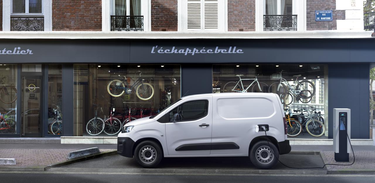

Variante elettrica anche per la variante panel del fortunato nuovo Berlingo, che a piena carica percorre 275 km (WLTP)

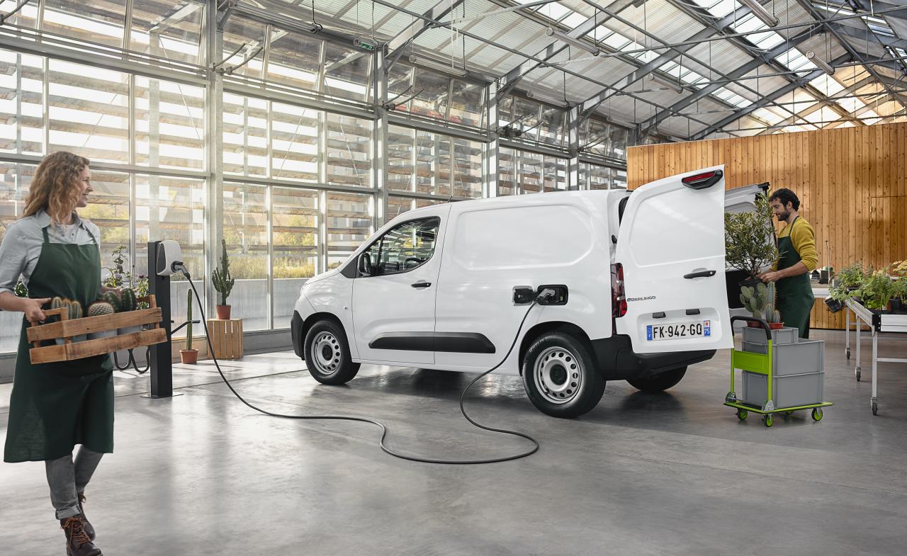

RECHARGING TIME SUITABLE FOR PROFESSIONAL USE
There are three charging possibilities, from simple standard socket charging to super-fast charging, which enables 80% of the battery to be charged in 30 minutes. However, a simple Green’Up socket enables a large proportion of the battery to be charged overnight, making it operational for a day's work.
  • Domestic charging, requiring a mode 2 cable (mass produced in France) for use at home or in a place of work or vehicle park. This charging mode is compatible with a standard 8A socket or an enhanced 16A socket (Green’Up unit + socket), which halves the recharging time, and enabling a 100% charged battery to be obtained in less than 15 hours, or 5 hours 30 minutes for 100km.
  • Private or public fast charging, requiring installation of a 3.7 to 22 kW Wallbox fast charging unit, and a mode 3 cable (optional). The charging time from 0 to 100% is then 7 hours 30 minutes (monophase 7.4 kW Wall Box) or 5 hours (triphase 11kW Wall Box).
  • Super-fast charging at a public station, up to 100kW with mode 4 cable integrated in the charger. Enables 80% of the 50kWh battery to be charged in 30 minutes. ë-Berlingo Van is in the first rank of its market segment in terms of fast charging time.
AN ECOSYSTEM TO FACILITATE ELECTRIC DRIVING LIFE
ë-Berlingo Van offers delayed charging functions, so that electricity can be consumed when it is least expensive, and thermal preconditioning, enabling the temperature in the cabin to be adjusted when the power is still connected to the mains, meaning that power is not then drawn from the battery.
Using the My Citroën application, battery charging can be managed remotely, the vehicle's charge level and autonomy can be seen remotely, thermal preconditioning of the cabin can be controlled remotely, and finally delayed charging can be configured from a smartphone or tablet, or directly using the vehicle's touchscreen, using connected browsing, in the "Energy" menu. This operation is possible for domestic charging (mode 2) or fast charging (mode 3). Delayed charging can be modified instantaneously.
Another available application, Free2Move, which facilitates charging and parking (in France), giving access to over 220,000 stations, and enabling the best journey to be planned in light of the vehicle's range, and the charging stations present along the route (including recharging breaks, total charging time, type of socket, means of access to the station, etc.).
To go one step further in offering support for its clients, for ë-Berlingo Van Citroën offers a customised charging solution, including the devices (standard socket and enhanced Green’Up or Wallbox socket) and installation in your home or in the workplace. The Company has chosen a recommended partner for each European country; for France this is ZEBorne and Zeplug. These solutions are available for individuals and professionals, both in individual homes and for collective housing.

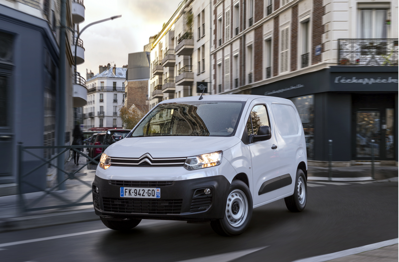

SPECIFIC FEATURES OF THE Ë-BERLINGO VAN
ë-Berlingo Van is a fully-fledged version of the Berlingo range, which differs externally only in that it has a monogram symbolising the electric "ë" before its name on the left rear door, and in its charging flap, which is located where the fuel-filler flap was.

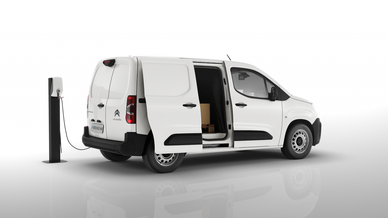

New Citroën ë-Berlingo Van has all the assets of the architecture of the internal combustion version. This commercial vehicle is compact, but provides modularity, ergonomics, an internal space, storage units, and an optimised loading capacity, making it an ideal working tool.
ë-Berlingo Van can transport two or three persons, and comes in two sizes: M, measuring 4.40m, and XL, measuring 4.75m. It comprises two families of commercial vehicles: small van, available in M or XL size, and small van with lengthened cabin, available in XL size. The vehicle is 1.84 m high, and can enter all parking locations.
It is easy to handle and agile due to its compactness, but nonetheless has a long loading length, due to the possibility of folding down the passenger seat in the Extenso® Cabin, releasing up to 3.09m in the M Size and 3.44m in the XL Size
With an effective width between the wheel arches of 1.23m, ë-Berlingo Van can carry two Euro pallets one behind the other. Its load volume, which is the same as in the internal combustion version, is 3.3m3 (XS without Extenso® Cabin), and up to 4.4m3 (XL with Extenso® cabin). The payload, up to 800kg, and the towable load, up to 750kg, in all versions, match precisely the needs of professionals in this category.
