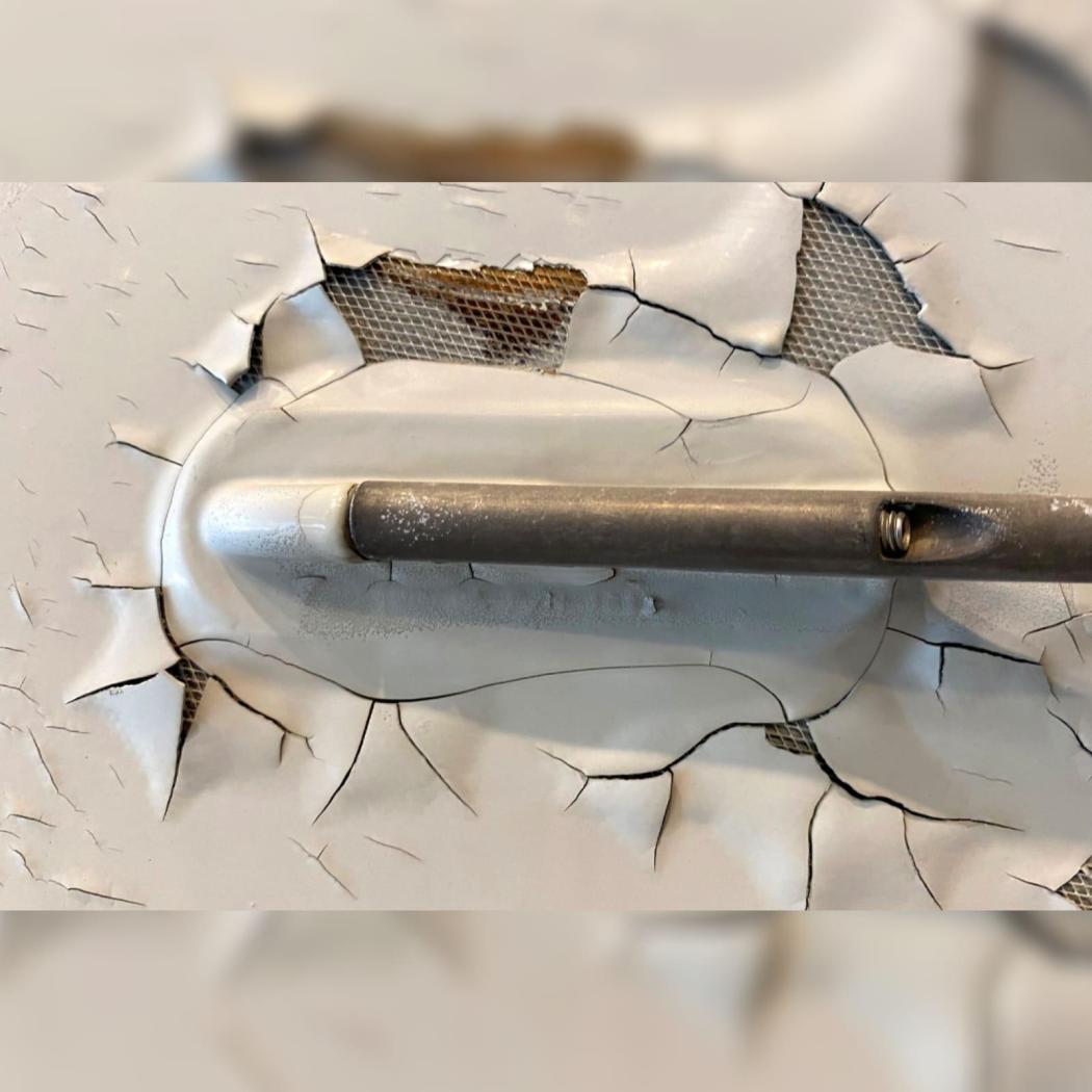

[...] Qatar's national carrier has grounded 20 of its 53 A350s, saying it is acting on orders from its local regulator, until reasons for what witnesses describe as the blistered and pock-marked appearance of some of its A350s can be confirmed.
Airbus says there is no risk to the A350's safety - a point echoed by the other airlines, which have not grounded any jets and describe the issue as "cosmetic."
The planemaker said in response to queries from Reuters there had been some problems with "early surface wear" that in some cases had made visible a sub-layer of mesh designed to absorb lightning, which it is working to fix.
 Three people with direct knowledge of the situation said that at Qatar Airways and at least one other airline the mesh had in some instances itself developed gaps, leaving the carbon-fibre fuselage exposed to possible weather or other damage. [...]

The European Union Aviation Safety Agency (EASA) has issued a proposed airworthiness directive (AD) that relates to the Expanded Copper Foil (ECF) on 13 Airbus A350s. The regulator has preliminarily warned that the material that offers lighting protection may have not been installed properly on these widebodies’ wing covers.
Fonte ed articolo completo su: https://simpleflying.com/easa-a350-paint-problem/

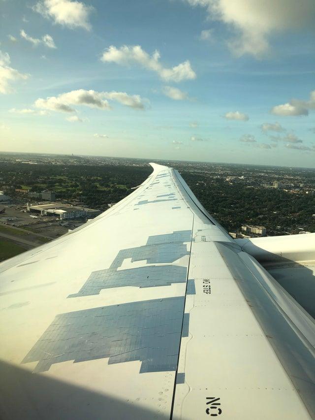

Anche il 787 ha un problema simile.
https://simpleflying.com/air-new-zealand-787-paint-flaking/
E anche in questo caso, non comporta un problema di aeronavigabilità.
