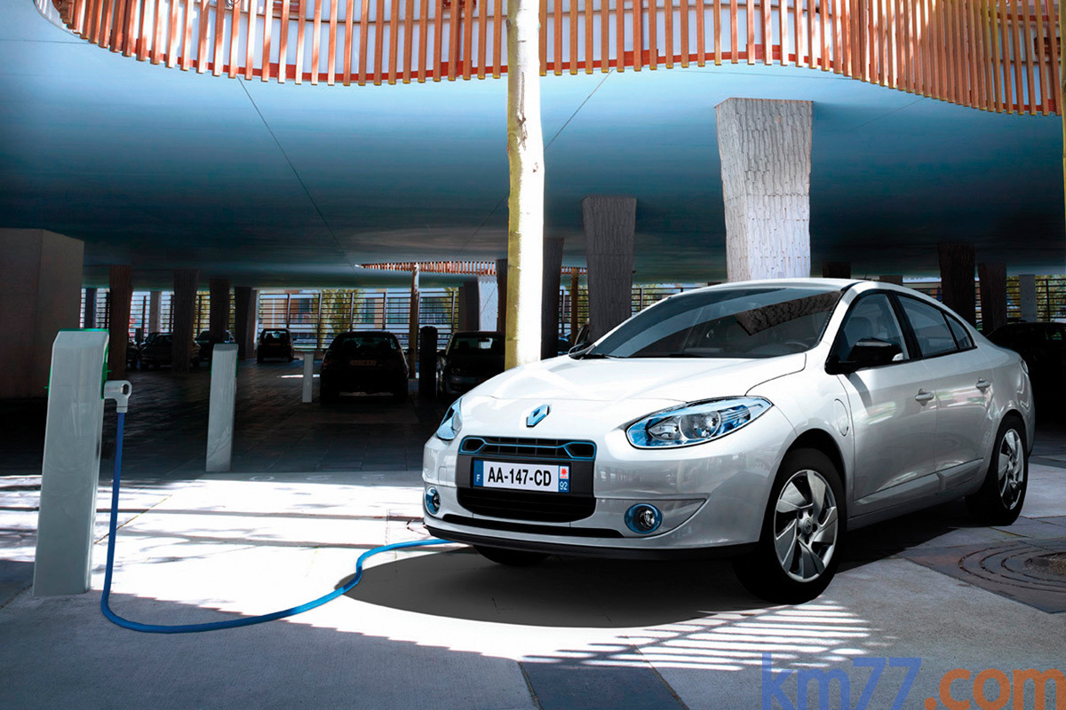

RENAULT FLUENCE Z.E.Following the unveiling of Fluence Z.E. Concept at the 2009 Frankfurt Motor Show, Renault has taken the wraps off the finalized design of Fluence Z.E. which is due to go on sale in Europe and Israel from 2011. As the C segment's first production saloon electric vehicle, Fluence Z.E. targets motorists and fleet operators who are looking for a status-enhancing vehicle that is both economical to run and respectful of the environment.
Fluence Z.E. will be manufactured at the OYAK-Renault factory in Bursa, Turkey, on the same production line as the internal combustion engine-powered versions of Fluence. Production is due to begin in the first half of 2011.
Immediately identifiable
As the compact segment's first saloon electric vehicle, it was imperative that Renault Fluence Z.E. should be recognisable at first glance. To distinguish it from the internal combustion engined-version, it comes with a package of specific features and details that unmistakably associate it with Renault's electric vehicle range.
The electric version of Fluence stands at a length of 4.75 metres, which is 13 centimetres longer than its internal combustion-engined cousin in order to accommodate the battery behind the rear seats. At the same time, the lines of its flanks have been revised in order to maintain the same overall balance as the original version.
At the front, the Renault logo, foglamp surrounds, headlamp brows and lower part of the headlamp mask are all picked out in a blue-hued colour. The upper air intake is traversed by a gloss black strip incorporating a blue chrome trim that links two similarly-finished circles situated either side of the grille. Finally, the lower air-intake incorporates a body-colour strip that runs between the two foglamps.
Renault Fluence Z.E.'s lines are taut and fluid, while the rear quarter panels have been harmoniously extended in order to absorb the additional length resulting from the longer rear overhang. This design encases the rear screen in a way that recalls the rear-end styling of prestigious sports coupés, while a gloss black trim at the bottom of the screen emphasises the rear's harmonious proportions. The design of the rear lights, which extend forward either side of the car, also contributes to the overall balance of Renault Fluence Z.E.'s lines. The clusters themselves feature a pattern made up of backlit blue-hued lozenges.
Gloss black exterior mirror housings, body-colour painted side protective mouldings and the battery charge flaps on both wings add the finishing touch to Renault Fluence Z.E.'s uniquely expressive looks, as do the boot lid's blue-hued panel and the Fluence Z.E. badge. Last but not least, the rear bumper incorporates a black diffuser which is engineered to reduce aerodynamic drag, while the wheels have been specially designed to minimise turbulence. Several body colours are available, including Energy Blue, a new colour that is specific to Renault's electric vehicle range.

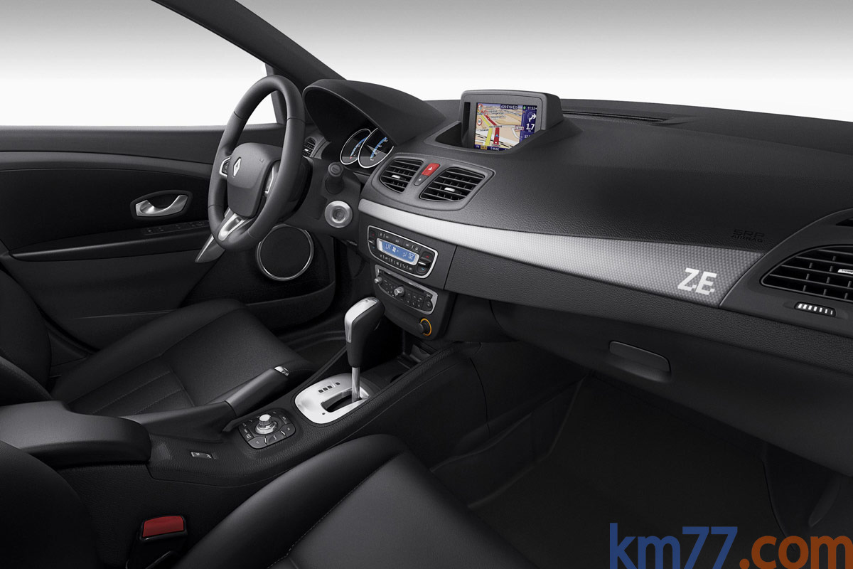

Renault Fluence Z.E.'s interior is based on the same layout as the internal combustion-engined version. Only the rev-counter has been replaced by a bespoke instrument which displays data concerning remaining range and battery charge. The decorative trim of the uncluttered dashboard is picked out in a colour that is exclusive to the model, while the centre console includes the displays "forward", "reverse", "neutral" and "parking" which are the different positions for the transmission control lever.
Fluence Z.E. also packs a raft of useful technologies, including a built-in smart navigation system, Bluetooth telephony and automatic dual-zone climate control, plus automatic headlamp and windscreen-wiper activation.

Questa, al contrario della normale Sedan, sarà disponibile anche per l'Italia.. se non ho capito male.
Modificato da Touareg 2.5
 News al 02/12/2015: Mazda 2.
capisco l'esigenza di sistemare le batterie ma quello sbalzo al posteriore è ridicolo.. :roll::roll:
Chiedete al rospo che cosa sia la bellezza e vi risponderà che è la femmina del rospo.
credo sia una cosa abbastanza facile da mascherare.. basta fare un passaruota bombato al posteriore (stile MiTo o ford focus) e raccordare meglio il lunotto facendo un andamento più da coupè...
Mi sembrava un pò troppo lunga, a veder le foto.
Purtroppo non era un'impressione...
Quoto...... molto quoto.:pen:
In realtà è l'effetto ottico dato dall'accelerazione verso la velocità smodata! :lol::lol::lol::mrgreen:
