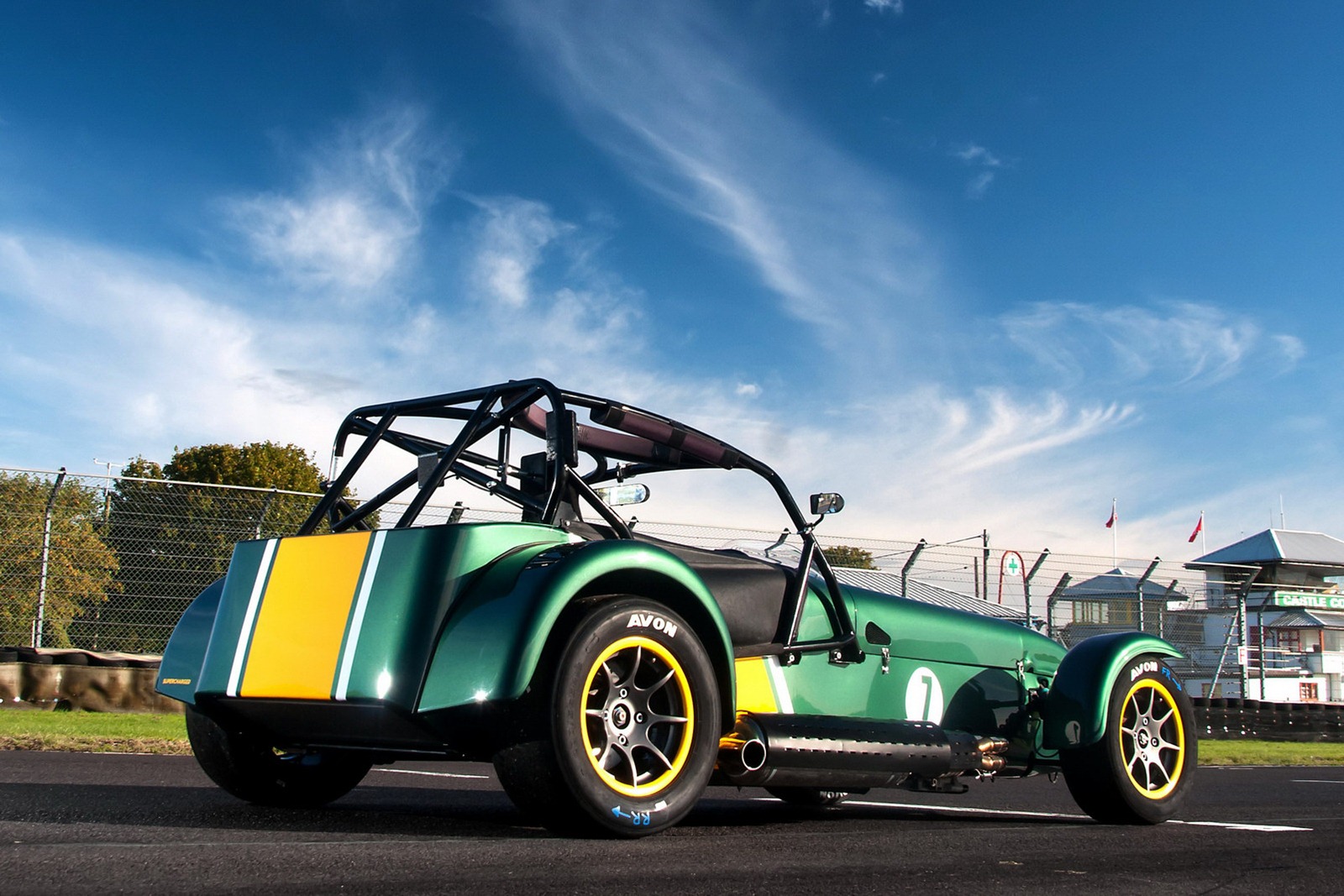

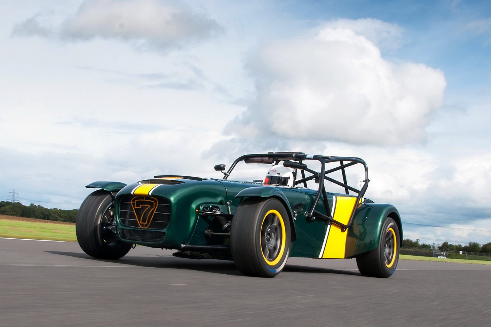

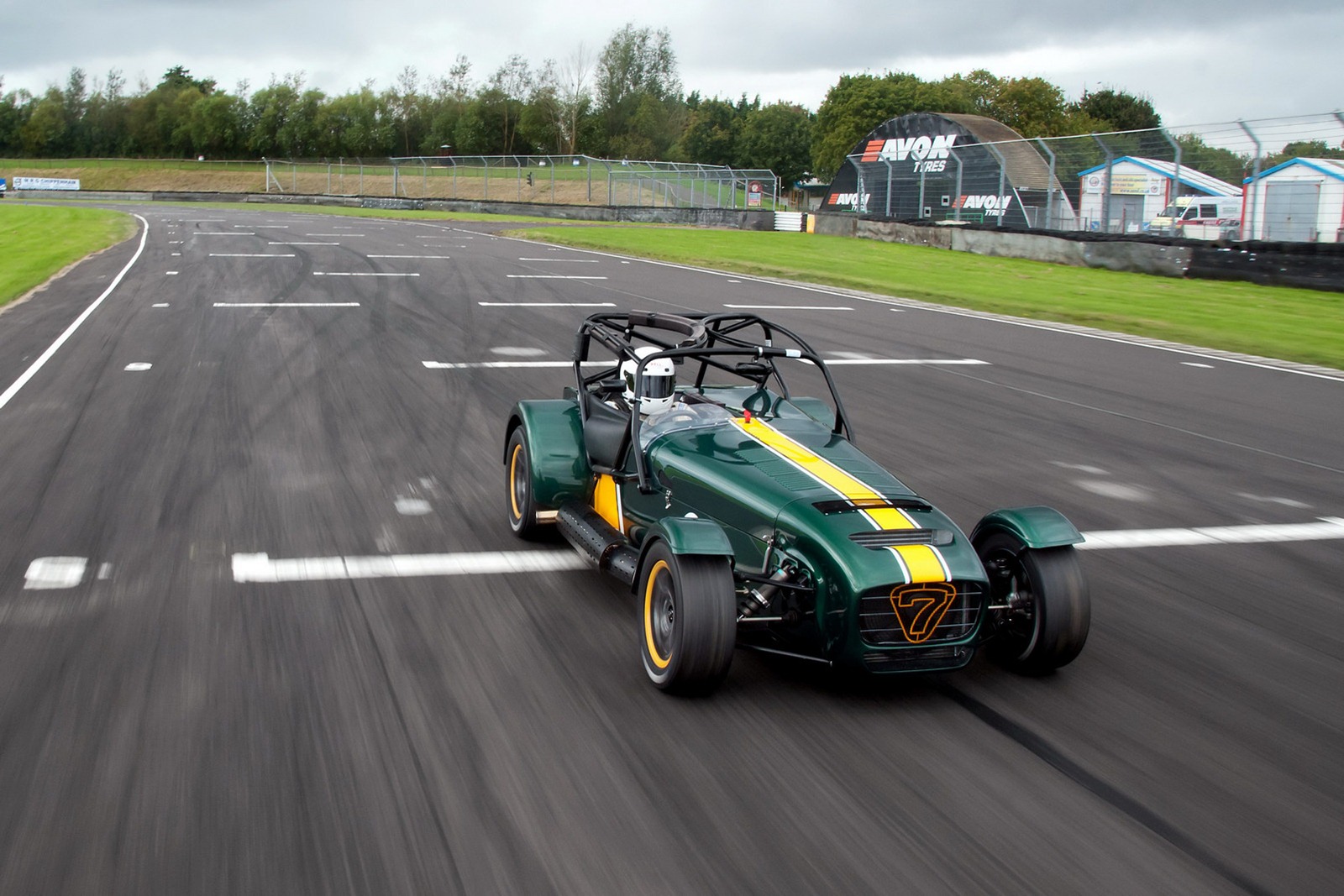

Press Release :
Caterham
2.0 Duratec by Ford con 275Cv e 270Nm . Buon divertimento :mrgreen: !
