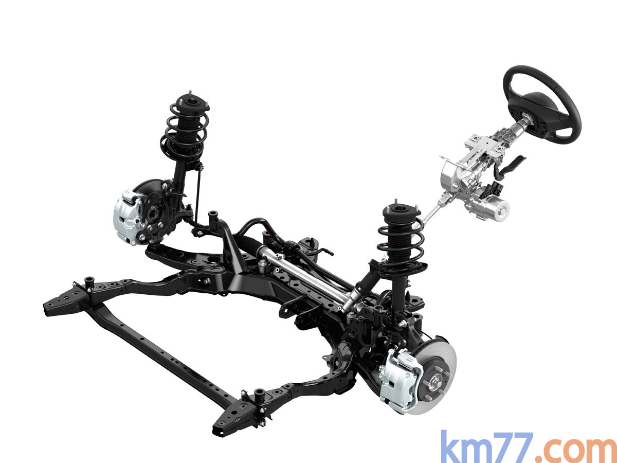

This is my first post, I want to say Hello to everybody. I can see you are leaking a lot of information of the new Giulia. I have a question for you DADO about the front suspension. You have comented that the rear suspensión will be a multilink, it is not clear the number of arms, 4 or 5. But you haven't said anything about front suspension.
Is front suspension Mcpherson or double wishbone?
Here 2 examples of each suspension:
Mcpherson (from new Mazda 3):
The double wishbone (from the Alfa 159):
In the case of the double wishbone you can see an up triangle surrounding the spring and shock absorber. Thanks in advance, best regards.
