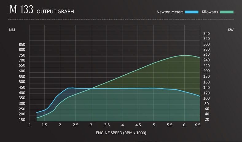

You can't compare CLA to Giulia. One is based on hot hatch and has transverse engine where they can't put V6 while other is in segment above and is RWD.
But Mustang has much less power than Mercedes and has 0.3 liters more capacity. Actually that 2.3 liter Mustang has slightly less HP/liter than 2.0 Giulia with 280 HP.
If you look at premium D-segment than all of them offer 3.0 liter V6 or I6 engine for more than 300 HP. Only exception is Volvo for S60 where they offer 305 HP (same engine exists as 320 HP for even bigger car) but with supercharger for low revs.
Now I will compare power and torque curve of 2.0 Volvo Twincharger, 2.0 Mercedes with single twin-scroll turbo and 3.0 Maserati with bi-turbo.
As you can see Mercedes engine is not even close at low rpm to Volvo not to mention Maserati. At 1500 rpm Volvo has 75 HP with 350 Nm, Mercedes has 55 HP with 250 NM while Maserati has 90 or 95 HP with almost 450 Nm.
For marque like Alfa that power and torque curve at low rpm like in CLA45 is not acceptable. But as I show it's possible to achieve decent power and torque at low rpm from 2.0 engine but not with single turbocharger. Thus I believe that 2.0 with 350 HP for Giulia will use electric or mechanical supercharger for low rpm.
