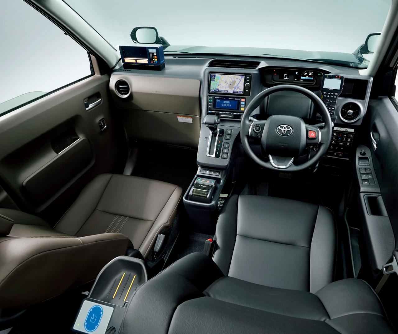

The driver's seat is a functional space suitable for professional use while the cabin is designed to offer a hospitable space and riding comfort to a variety of customers.

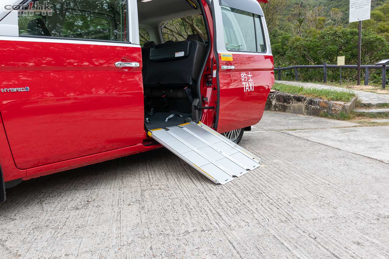

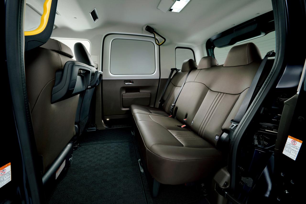

  • A wide-opening rear sliding door (width: 720 mm, height: 1,300 mm), low, flat floor (floor height: 320 mm), and conveniently placed grab handles5 makes it easier for customers to ingress and egress from the taxi.
  • Designed with an optimal point of ingress and egress for wheelchair users from the wide-opening rear sliding door and a seat for caregivers to sit next to the wheelchair user
  • The people-friendly cabin package includes large windows, a spacious front and rear seat area (1,065 mm), a head clearance in the back seat of 230 mm, and the use of the entire cabin width to provide ample shoulder room.
  • Quality riding comfort owing to plushly padded, flat seats and an optimized framework allows passengers to move sideways more easily.
  • Seat belts are easy to reach and pull out thanks to the seat belt extender. Additionally, seat belts in the back seat are lit with LED lighting to make them easy to identify even at night (LED lighting equipped only on the left and right seats)

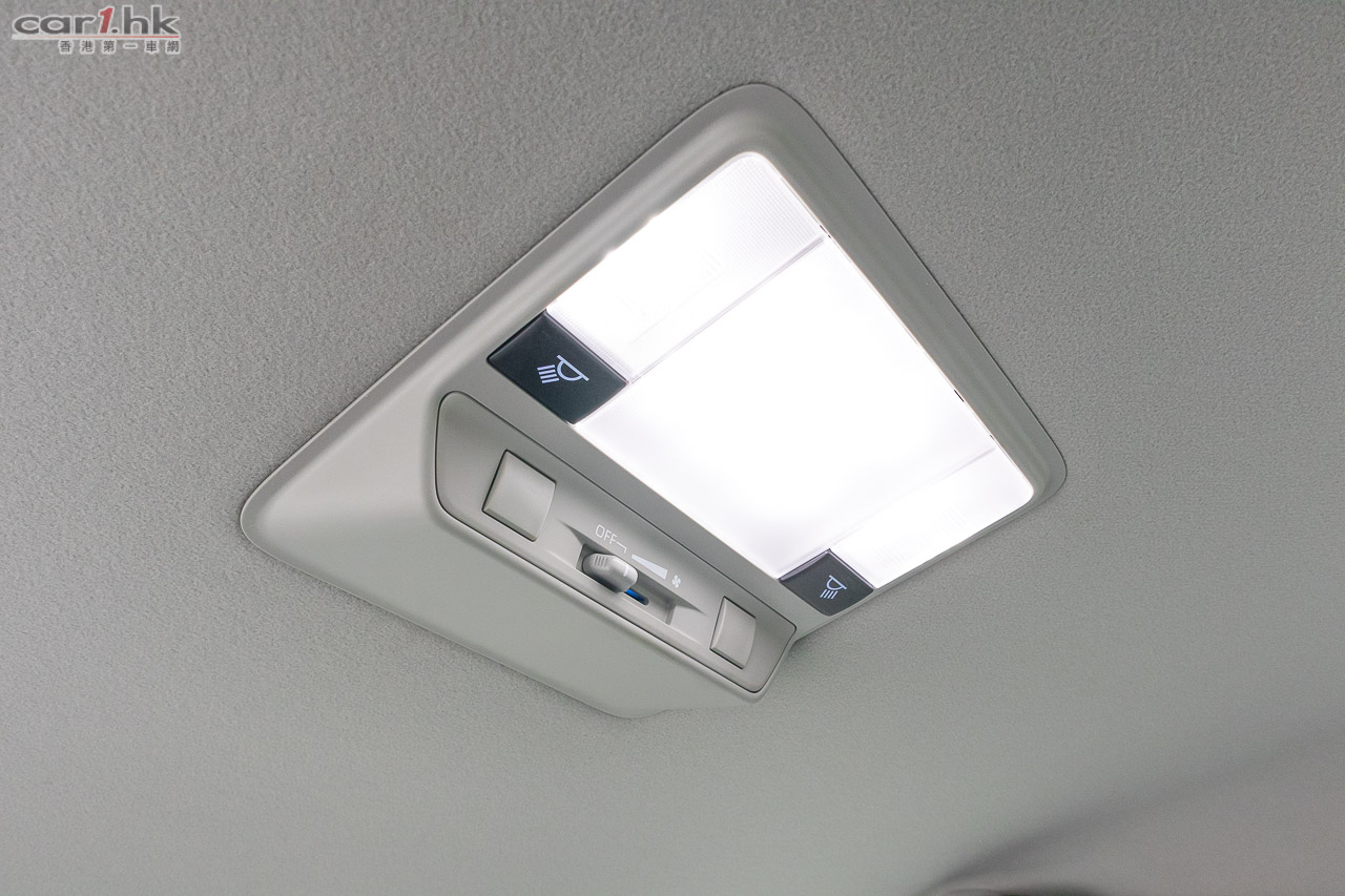

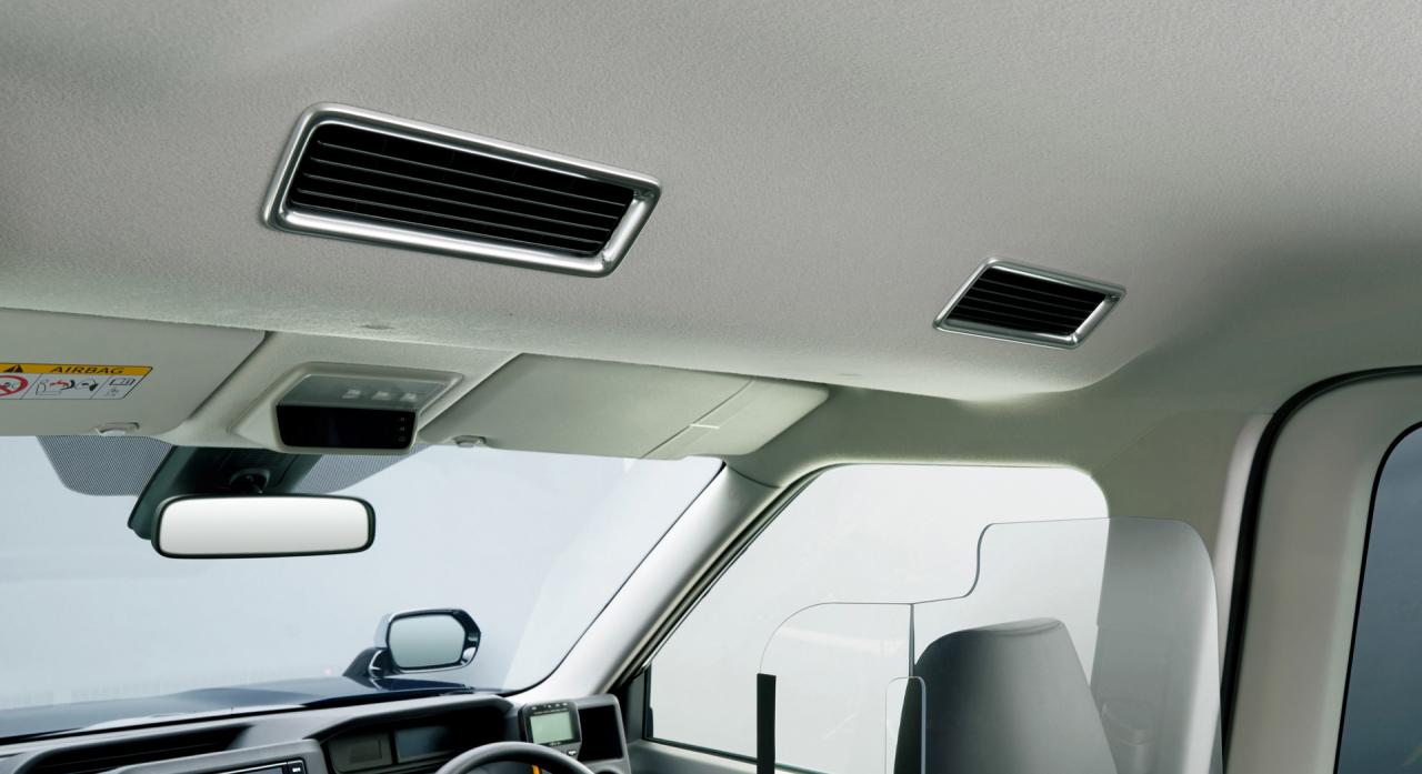

  • The luxury grade Takumi comes with a ceiling air circulator and air vents in the back seat that efficiently distribute cool air from the air conditioner. There is a lever so that customers can adjust the air flow themselves. There is also a back seat heating system that customers can operate themselves.
Driver space

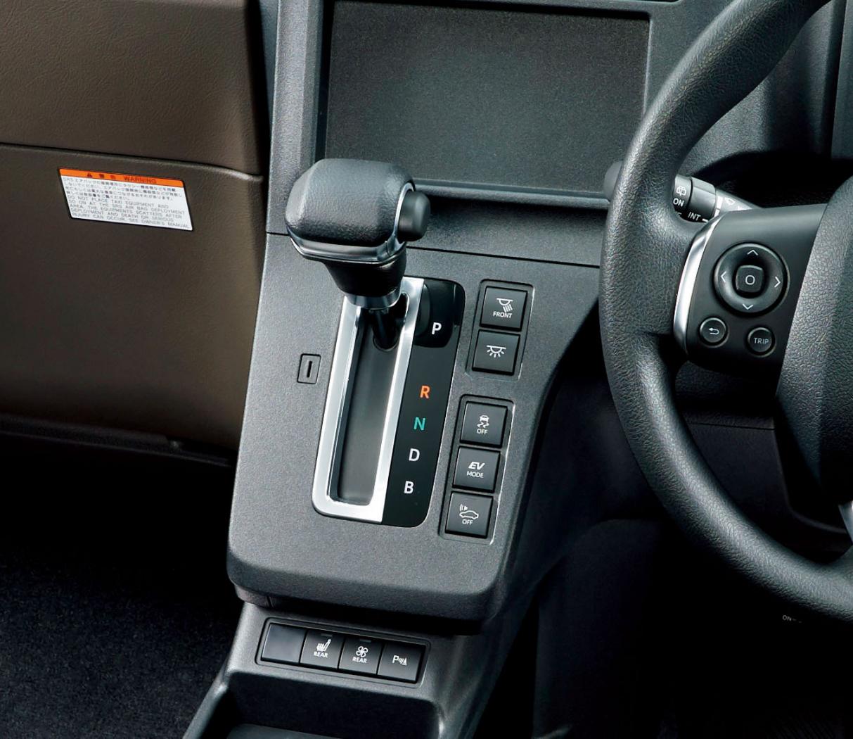

  • The various instruments are grouped by function making them easy for the driver to operate. Specifically, the car dispatch system, air conditioning, and other instruments operated by the driver are positioned on the driver's right side while the navigation (GPS) system, taxi meter, and other instruments are placed in view of passengers. The hazard switch, which is frequently used, is located on the right side of the steering wheel.
  • The storage space is located in an area barely visible to passengers, and additional devices can be stored in a space behind the steering wheel. Owing to this ample storage space and optimal positioning of storage areas, the vehicle is well-suited for professional use.

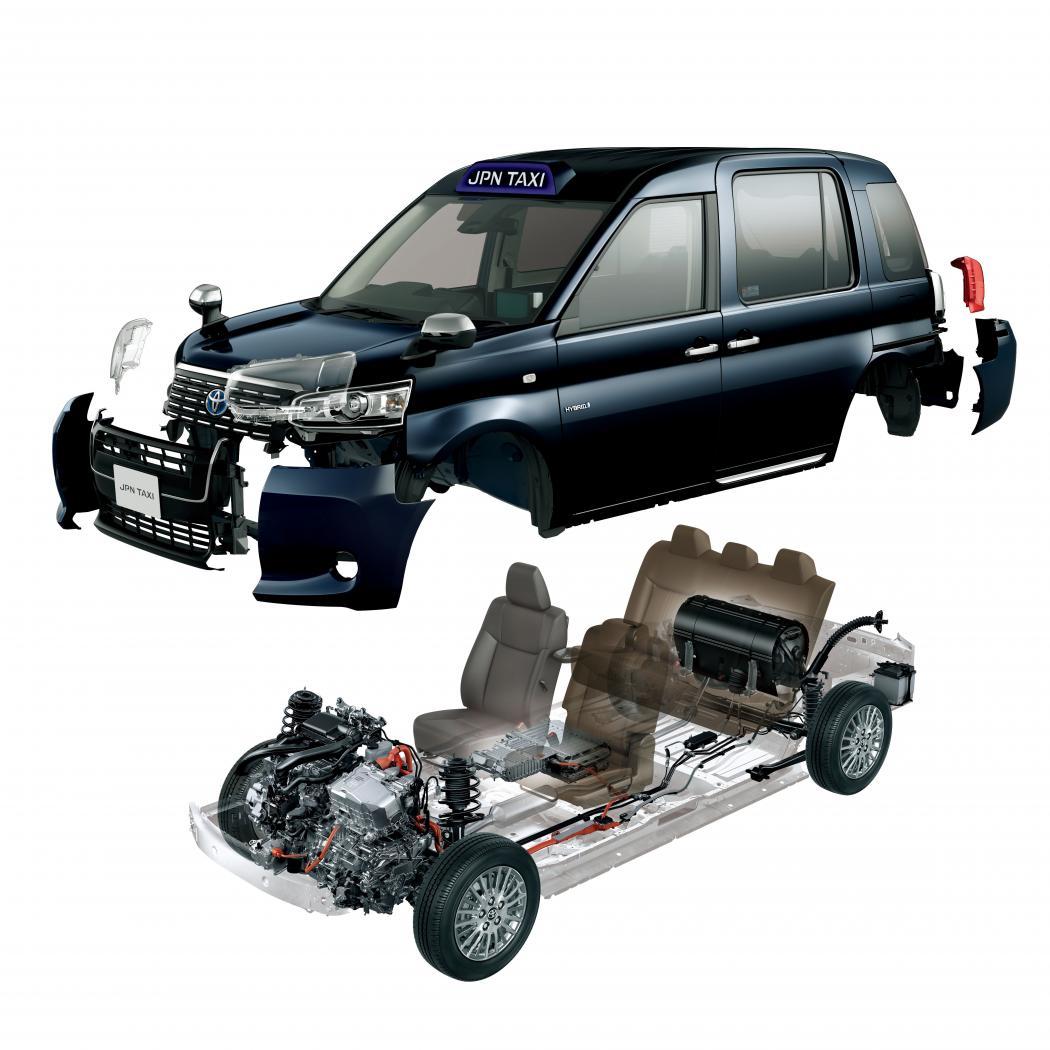

  1. High environmental performance and fuel economy owing to a newly developed LPG-hybrid system
    This next-generation taxi is gentle on the environment and contributes to low running costs thanks to its 19.4 km/L fuel economy performance and its ability to run on LPG fuel, since it is equipped with a hybrid system (THS II) (which was developed over many years).

    • The front suspension adopts the MacPherson strut-type coil spring while the rear suspension employs a trailing link axle-type coil spring (three links), both designed for use in a taxi and to contribute to durability.
    • The side portions of the front and rear 3-part bumper are replaceable. Only the outer lenses of the lights are replaceable. In addition, the superior maintainability of the engine, including the use of a no-maintenance power water pump in the auxiliary belt system, contributes to lower repair costs.
