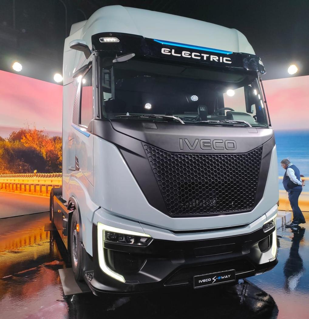

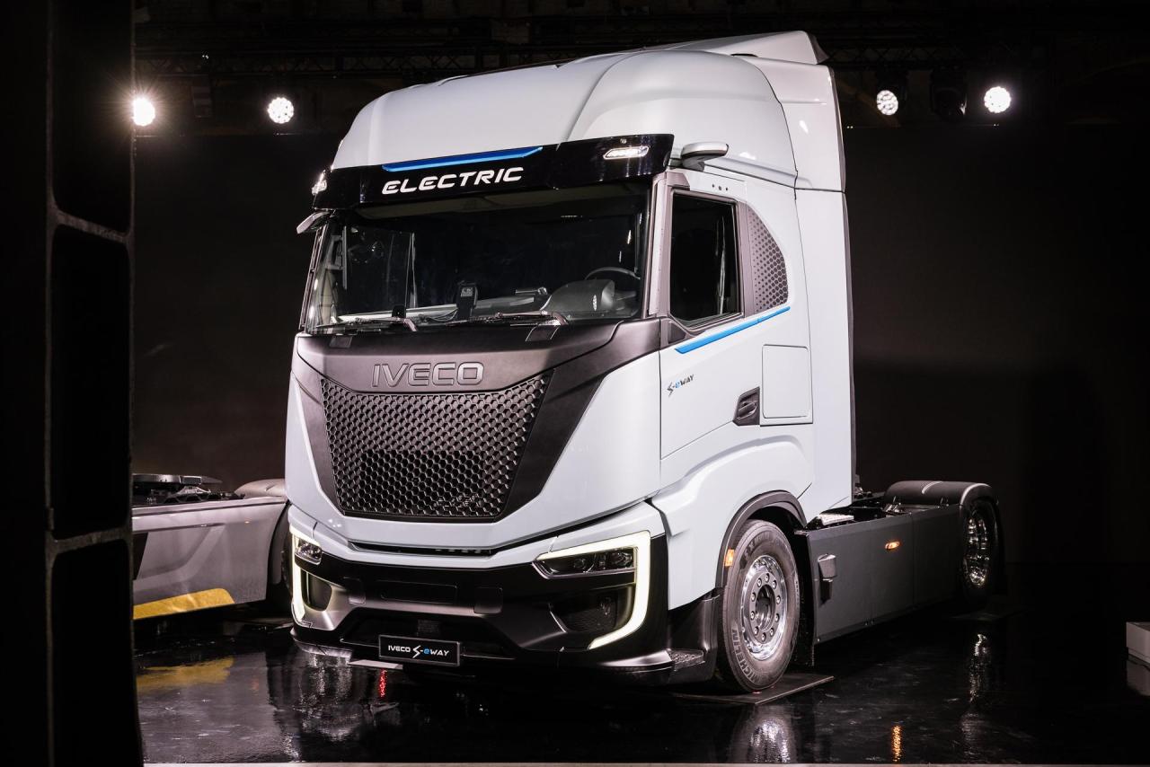

Iveco S-eWay Artic 2025
1749727659130-2.thumb.jpg.a3af3b935d76bdd81c1af5387611735e.jpg50_lecie_iveco_ciezarowki_18.webp.0d81039a6d43e56f5088859a831c1b82.webp50_lecie_iveco_ciezarowki_16.webp.3657f298b8a8eadcf161290a7b9166f6.webp50_lecie_iveco_ciezarowki_15.webp.f9f1bb19972695c6be666a73c588bbce.webp
IVECO unveils the new S-eWay Artic, the ideal vehicle for e-mobility in long-haul and regional missions
Following last year’s launch of the S-eWay Rigid, IVECO takes a further step forward in its journey toward zero-emission transport with the launch of the new S-eWay Artic, its latest electric heavy-duty truck designed specifically for long-haul and regional transport.
  • The IVECO S-eWay Artic features a range of up to 600 km, providing an effective zero-emission solution for long-haul and regional missions.
  • The cutting-edge LFP battery technology delivers a total energy capacity of 603 kWh, with 97% usable energy, among the highest in the industry.
  • IVECO offers an industry-leading battery warranty covering up to 10 years and up to 1.2 million km.
  • The market-proven eAxle by FPT Industrial delivers best-in-class efficiency and energy management.
  • The elongated AeroCab is optimized for efficiency and truck-semi-trailer integration.
  • The S-eWay is fully integrated into IVECO’s ecosystem of services, offering peace of mind with advanced connectivity, a complete suite of tailored services and the expert support of IVECO’s professional network.
Turin, June 12th 2025
The new range combines the proven strengths of the IVECO S-Way diesel version with advanced zero-emission innovation. Central to the vehicle’s electric performance is the state-of-the-art LFP battery system, which offers upper-class energy onboard and an industry-leading battery warranty of up to 10 years and 1.2 million km, setting a new benchmark for durability and reliability in the electric truck segment.
The IVECO S-eWay Artic is the latest outcome of IVECO’s pioneering work in alternative propulsions, and a further effective solution for helping fleet operators to accelerate their decarbonization journey while preserving profitability, productivity and operational efficiency.
“With the new IVECO S-eWay Artic we are providing our customers with a practical, long-distance solution that meets the demands of today’s transport operators,” stated Giuliano Giovannini, Head of Product Portfolio Management. “They are under increasing pressure to decarbonize, and they need solutions that are ready to complete their missions successfully and enable them to achieve their business goals. This vehicle reflects our commitment to walking that journey alongside them with technology they can trust and support they can count on.”
Deliveries of the IVECO S-eWay Artic will begin in 2026.
