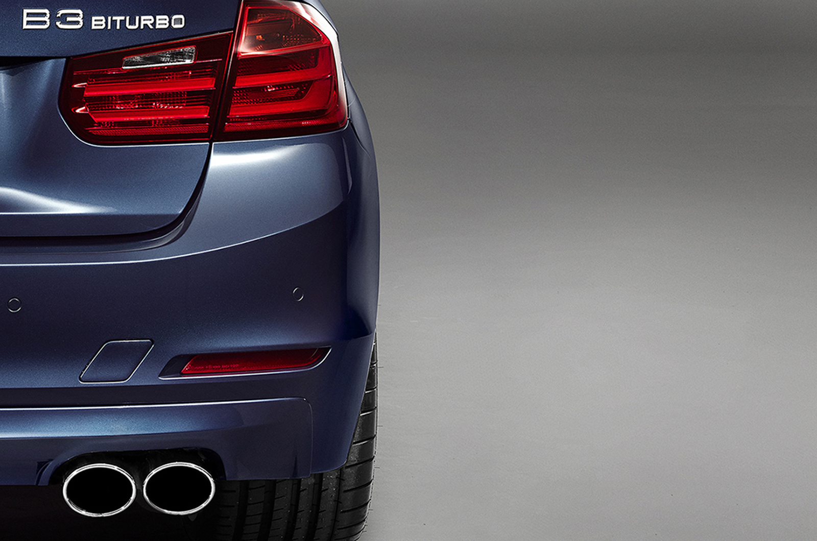

The stainless steel exhaust system which was developed in collaboration with Akrapovi? is 7.5kg lighter in comparison to its predecessor. The two elliptical double tailpipes, which are typical of ALPINA, are elegantly integrated into the rear valence and give a very purposeful look.
The resonant, sporty sound of the exhaust system is controlled by an intelligent exhaust valve. This offers the driver the possibility to influence the sound experience via the Drive Performance Control and facilitates the balancing act between emotional soundtrack and long-distance comfort. In Comfort mode the exhaust valve remains closed up to 2500 rpm, beyond which it opens depending on engine load and rpm. In Sport mode, however, the valve is permanently open and the B3 Bi-Turbo thrills with its distinctive aural character under hard acceleration – when additionally selecting Sport (S) or Manual (M) Shift Mode the exhaust will deliver an occasional burble on the overrun.

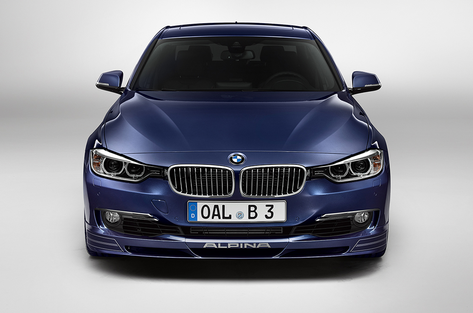

The 20” ALPINA CLASSIC wheels, used for the first time on a BMW ALPINA 3 Series model, look particularly striking and elegant. Above all, the B3 Bi-Turbo has presence and inherently looks powerful, while the ALPINA aerodynamic components fit perfectly into the modern design of the BMW 3 Series.
The functional design of the front spoiler ensures the effective flow of air to the cooling system and the brake air ducts. In combination with the rear spoiler (Saloon), this achieves excellent aerodynamic properties, considerably reducing uplift almost to zero and contributing significantly to high-speed stability.
