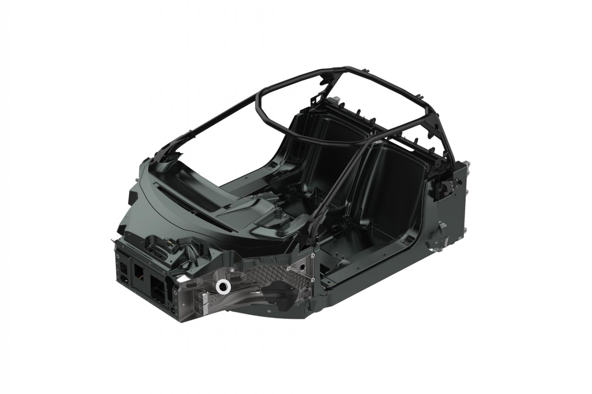

The central structure of the GT is a bespoke carbon-fiber tub made from 45 different parts. The instrument panel is a structural element, and atop the tub is a tubular structure that not only supports the roof but is also certified as a race-approved rollcage. “We’ve been asked many times why we didn’t do the cutouts in the roof that were such iconic elements of the original GT40,” GT design chief Chris Svensson says. “Well, we couldn’t because the rollcage requirements dictated where we needed the structural members.”

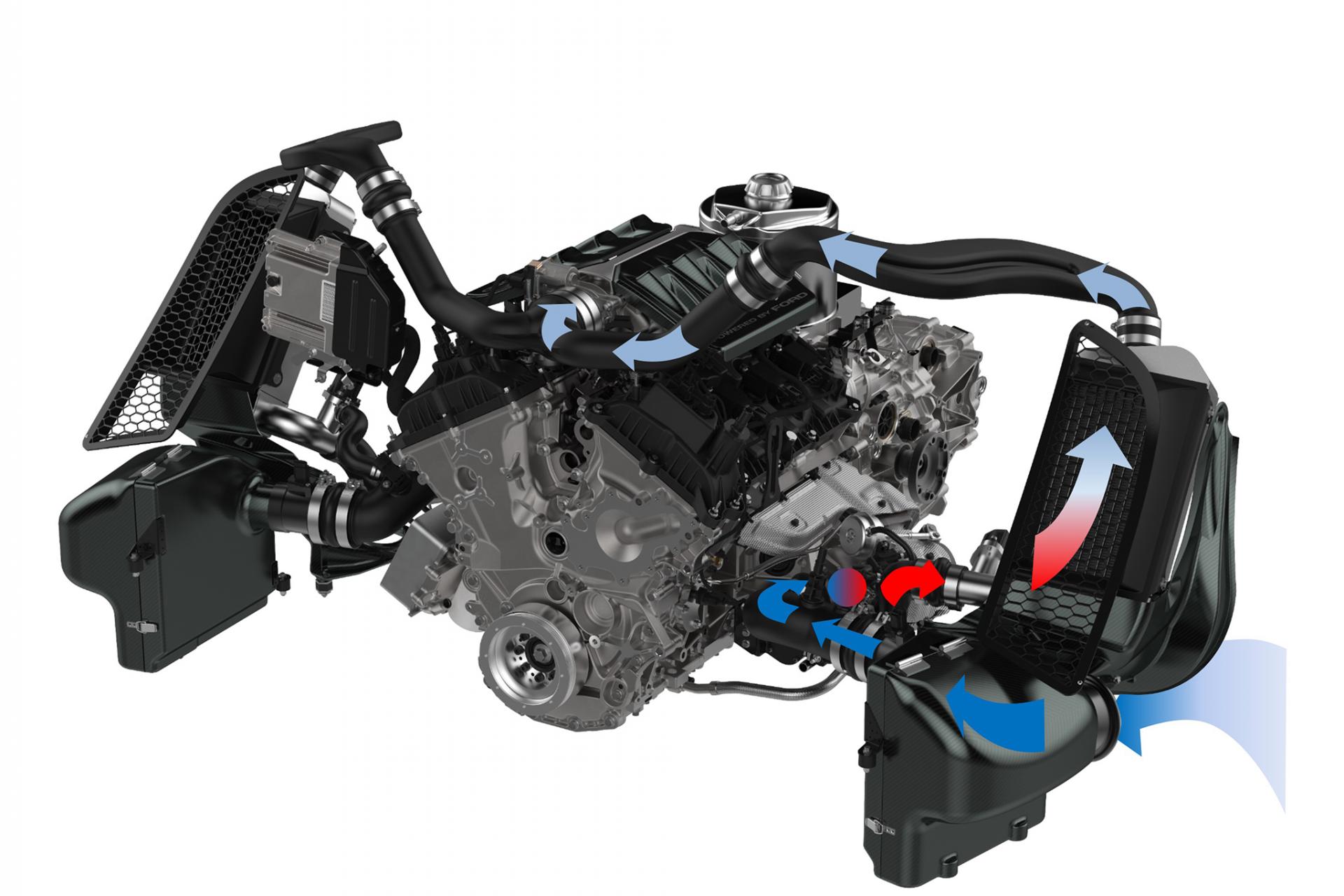

The GT’s 647-hp 3.5-liter EcoBoost engine shares 60 percent of its parts with the Ford Raptor engine. The block is the same as the one used in EcoBoost-powered F-150s. All ancillary drives have been removed from the front of the engine to allow it to be positioned as far forward as possible. The tall, round element just behind the block is part of the dry sump system, which holds 15.3 quarts of oil. The seven-speed dual-clutch transmission is Getrag’s 7DCL750. The intercoolers are mounted in the sponsons ahead of the rear wheels, and cooled, pressurized air is fed to the plenum chamber via tubes inside the dramatic flying buttresses that connect the sponsons to the GT’s roof.

Una cosa non mi torna.
Gli intercooler sono davanti alle ruote posteriori, e i condotti di ritorno aria (intercooler - aspirazione) sono annegati nelle "ali" della carrozzeria che collegano le fiancate alla cabina?
A vedere la foto del motore i tubi non fanno un percorso simmetrico, ci capisco poco.
Vedrete.
2 ore fa, TurboGimmo dice:
:si:
E' la prospettiva ad ingannare.
