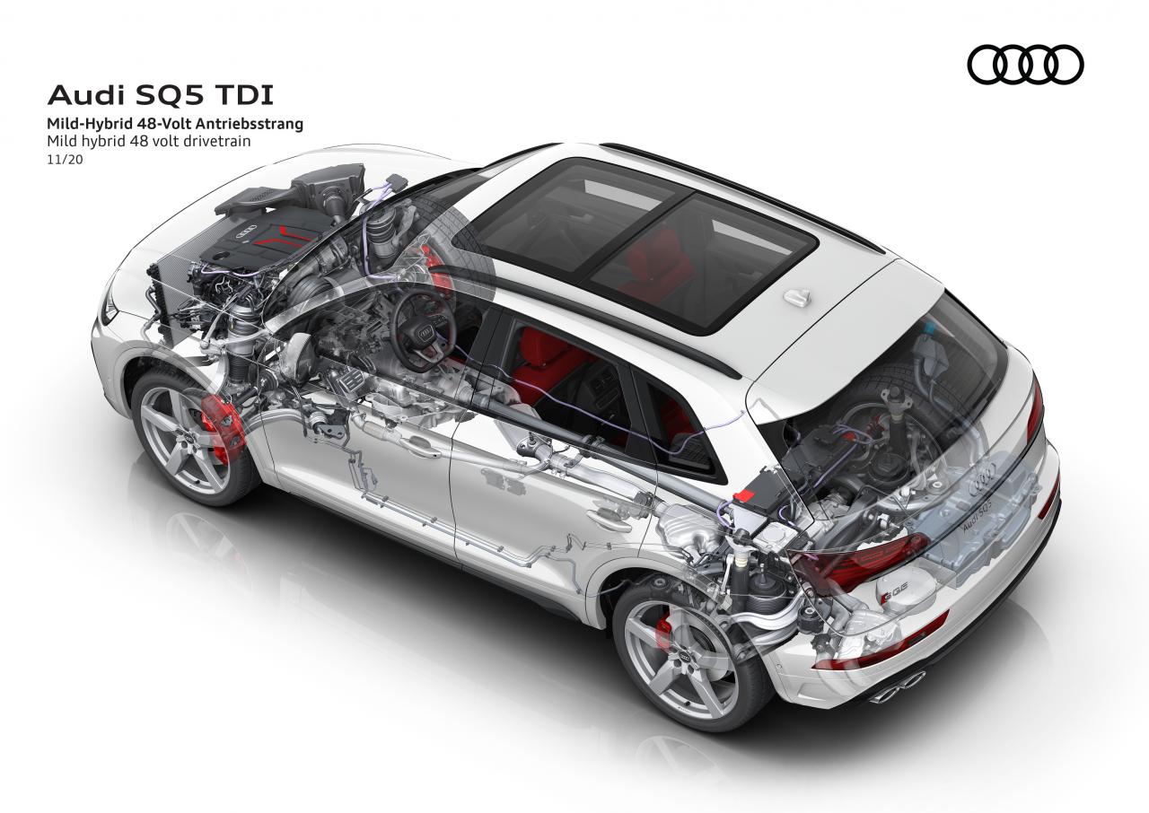

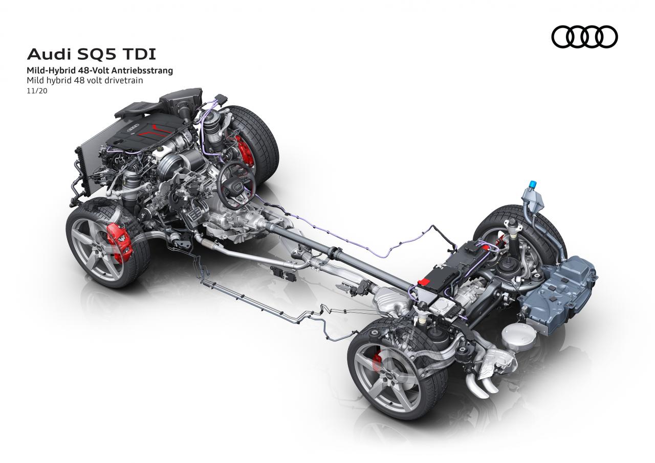

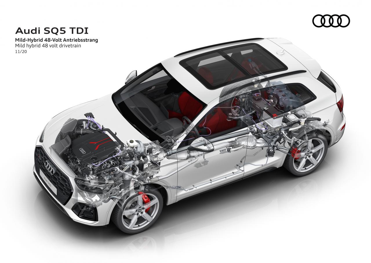

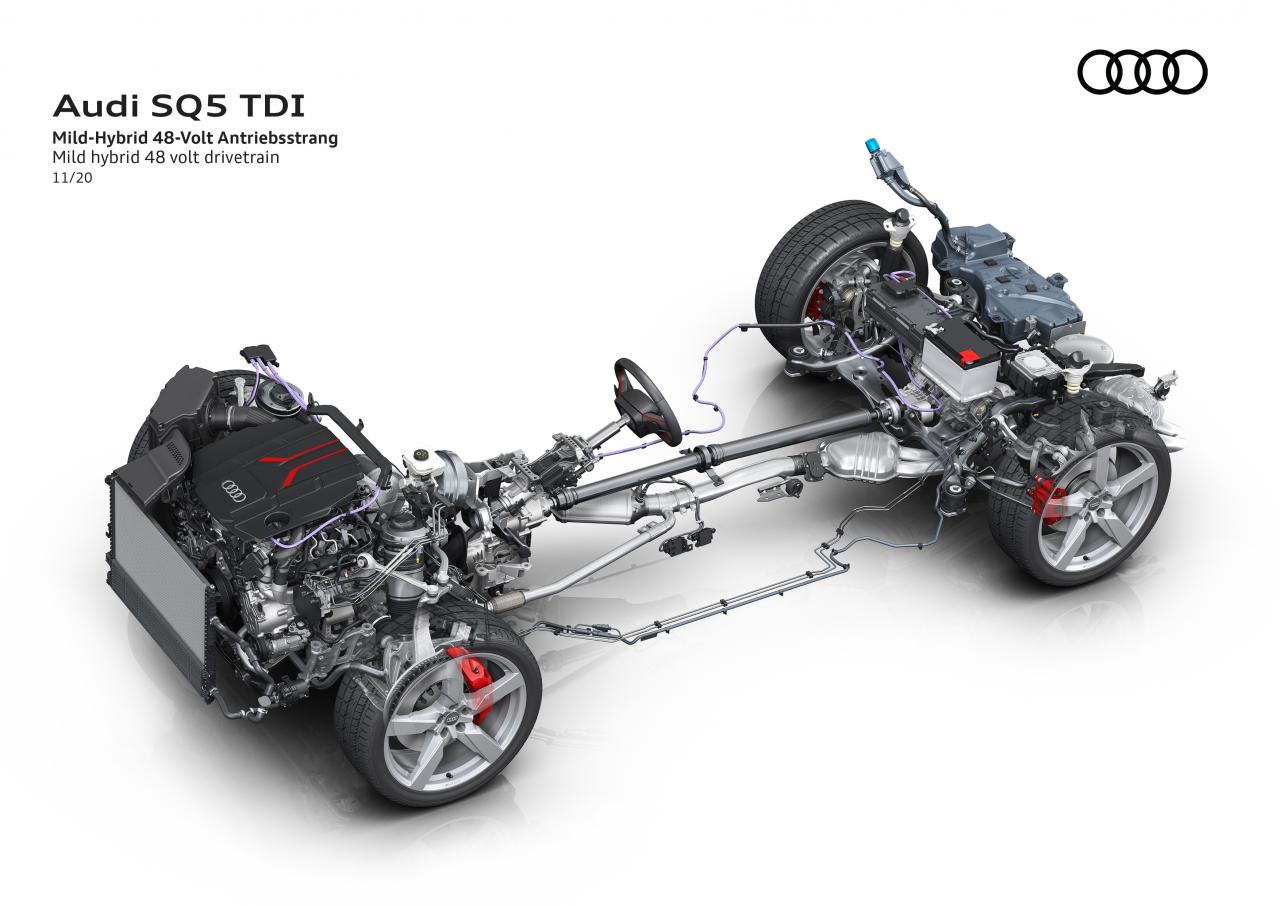

MHEV and EPC: even greater efficiency and spontaneity
The 3.0 TDI2 brings two technologies that reduce consumption and improve the engine response. The 48-volt mild hybrid system (MHEV) integrates a belt alternator starter (BAS), a lithium-ion battery that provides buffer storage, and a 48/12-volt voltage converter. When the car decelerates, the MHEV system recovers up to 8 kW of power. The sport SUV can coast for up to 40 seconds with the engine switched off – after which time the powerful BAS conveniently restarts the engine. The MHEV system has the potential to reduce customer fuel consumption by up to 0.7 liters (0.2 US gal) per 100 kilometers (62.1 mi).
The second technology component is the electric powered compressor (EPC), which helps out whenever the exhaust gas flow provides too little energy to drive the turbocharger. A compact electric motor, which also uses the compact 48-volt system, accelerates the compressor wheel of the EPC to 65,000 rpm in roughly 300 milliseconds. The EPC is now used more frequently and across a broader engine map. It supports a more spontaneous engine response when the vehicle moves off as well as when accelerating from low engine speeds. The optimized interaction between the components EPC, MHEV, turbocharger, the engine itself, and the tiptronic transmission supports this effect.
