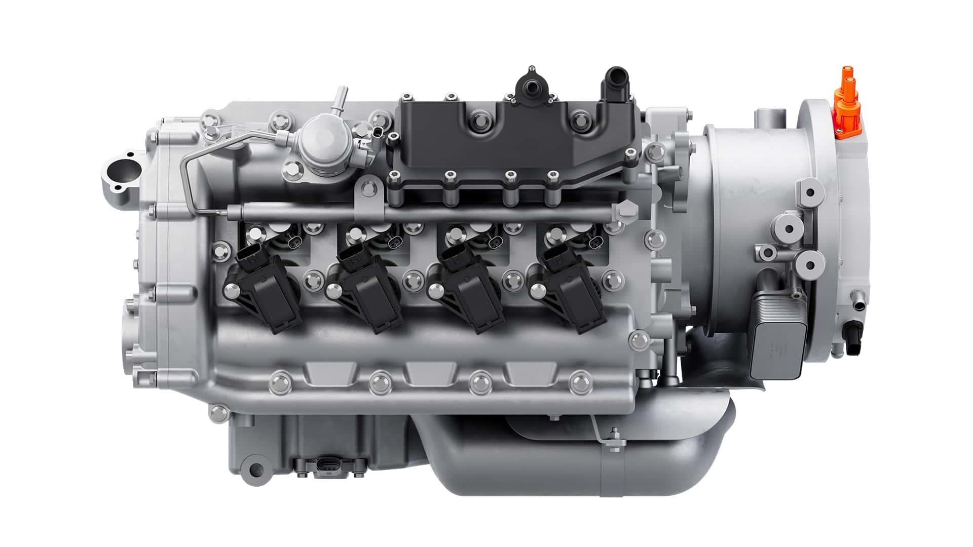

Gli manca solo il serbatoio...
Motore orizzontale, carter secco? ... oppure c'è comunque una coppa, ma sul lato del monoblocco?

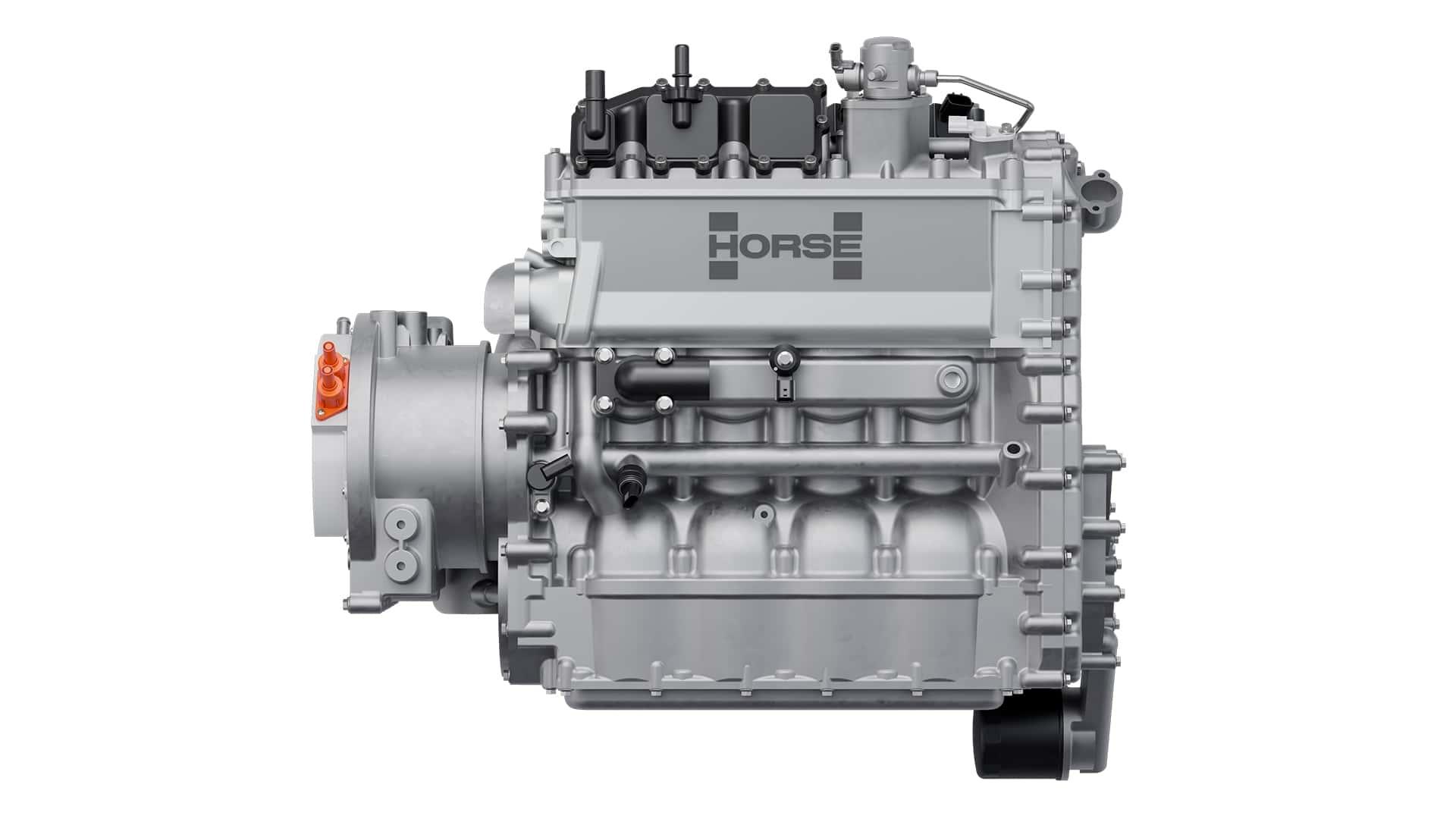

Ripresentato con il nome di X-Range C15 Direct Drive, come powertrain ibrido modulare con possibilità HEV, PHEV e EREV:
Horse-Powertrain-New-2-1536x1536.webpHorse-Powertrain-ICE-1536x864.webpHorse-Powertrain-New-3-1536x1536.webp

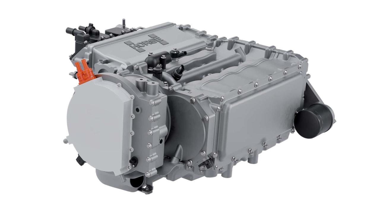

The ultra-compact X-Range C15 Direct Drive integrates a full hybrid powertrain – including a 4-cylinder engine, transmission, power electronics, and an electric motor – into a single compact unit with a shared housing, designed to mount to the rear subframe enabling a double isolated installation for best NVH.

The X-Range C15 Direct Drive features a 4-cylinder, 1.5-liter engine that can be installed in either a naturally aspirated configuration for lower-power applications such B- and C-segment vehicles, or with a turbocharger for larger D-segment vehicles and LCVs. The naturally aspirated engine can output up to 70kW, and the turbocharged engine can output 120kW.
The powertrain integrates the engine with both a dedicated hybrid transmission and set of electric motors in a single shared housing in a flat profile. The two motors are installed in a P1 + P3 configuration: one integrated at the end of the engine's crankshaft, and a second at the transmission's output shaft.
  • The P1 motor primarily acts as a generator in both serial and parallel modes. As a generator it can output 70kW for the X-Range C15 Direct Drive’s naturally aspirated variant, and 110kW for the turbocharged variant.
  • The P3 motor is intended to provide electric traction to the vehicle – either independently from the engine in serial mode, or together with the engine in parallel mode operation. By the direct connection between the engine and the wheel enabled in parallel mode, the total system efficiency is improved over alternative range-extended or pure serial mode hybrid solutions.
