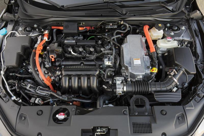

E il rumore del seriale manco mi sembra una cosa bella, non so se è peggio il fastidio che mi dà già di suo l'e-CVT della mia. Dalla prova di questo sistema Honda su Odyssey:
Accelerate gradually and power is fed in very smoothly, if rather noisily. In hybrid mode the front wheels are still being driven by the electric motor with the engine supplying power to the second motor (electric generator), which feeds the battery to power the wheels.
The whole system acts and feels very much like it’s using a CVT gearbox, with the engine revs spiking dramatically if you accelerate hard. Here, refinement is not the powertrain’s strong point but once up to speed and at a steady cruise, the engine takes over the power delivery, driving the front wheels via a small clutch to maximize efficiency. Ask for more power and the electric motors intervene to provide extra shove, but the engine becomes quite vocal once again.
