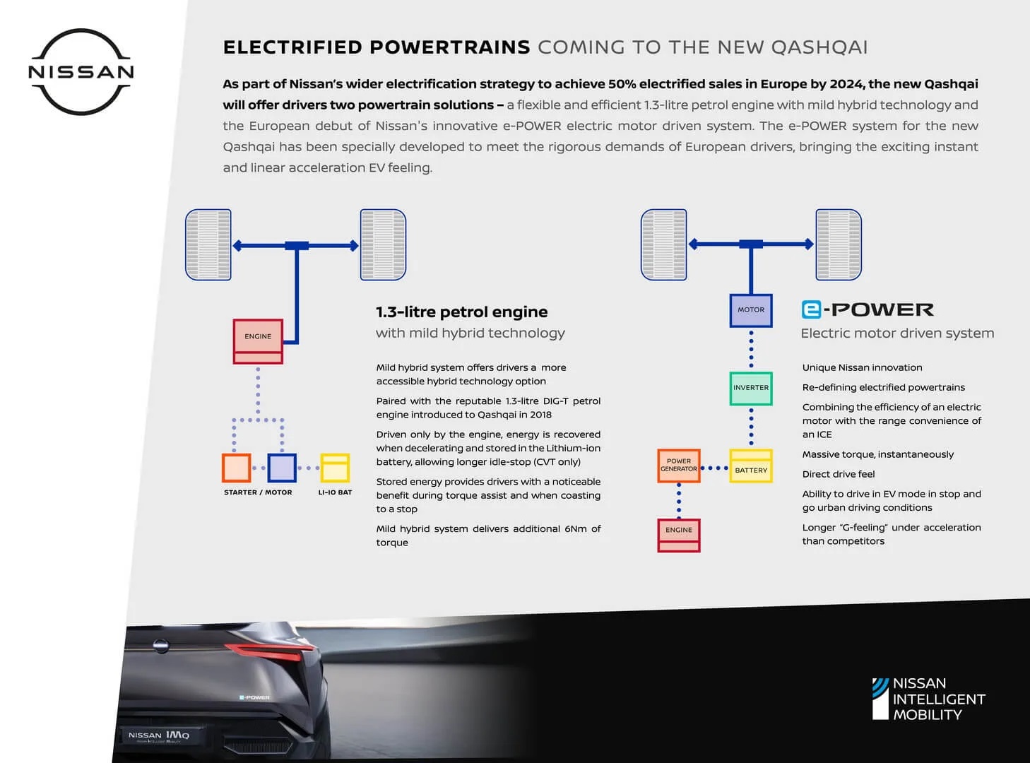

The new Qashqai brings the first deployment of Nissan's innovative e‑POWER drive system to Europe. Exclusive to Nissan and a key component in the company's Intelligent Mobility strategy, the e-POWER system is a unique approach to electrification by making every day driving exciting.
The new Qashqai's e-POWER system is comprised of a high-output battery and powertrain integrated with a category-leading variable compression ratio 157PS petrol engine, power generator, inverter and 140kW electric motor of similar size and power output as found in Nissan's electric vehicles. It's a unique solution that combines the enjoyable, seamless linear acceleration which is characteristic of an EV, but without the need for charging.
To meet the typical demands of European consumers and their daily drive, the e-POWER installation has been significantly upgraded for the new Qashqai. Where the application in the Note - Japan's best-selling car in recent years – is a 1.2 petrol engine charging the battery unit, and a final power output of 108PS. For Europe it has been upgraded to a 1.5-litre petrol engine, with a final power output of 140kW (190PS).
The unique element of the e-Power is that the petrol engine is used solely to generate electricity, whilst the wheels are completely driven by the electric motor. This means the engine can always run within its optimal range, leading to superior fuel efficiency and lower CO2 emissions compared with a traditional internal combustion engine.

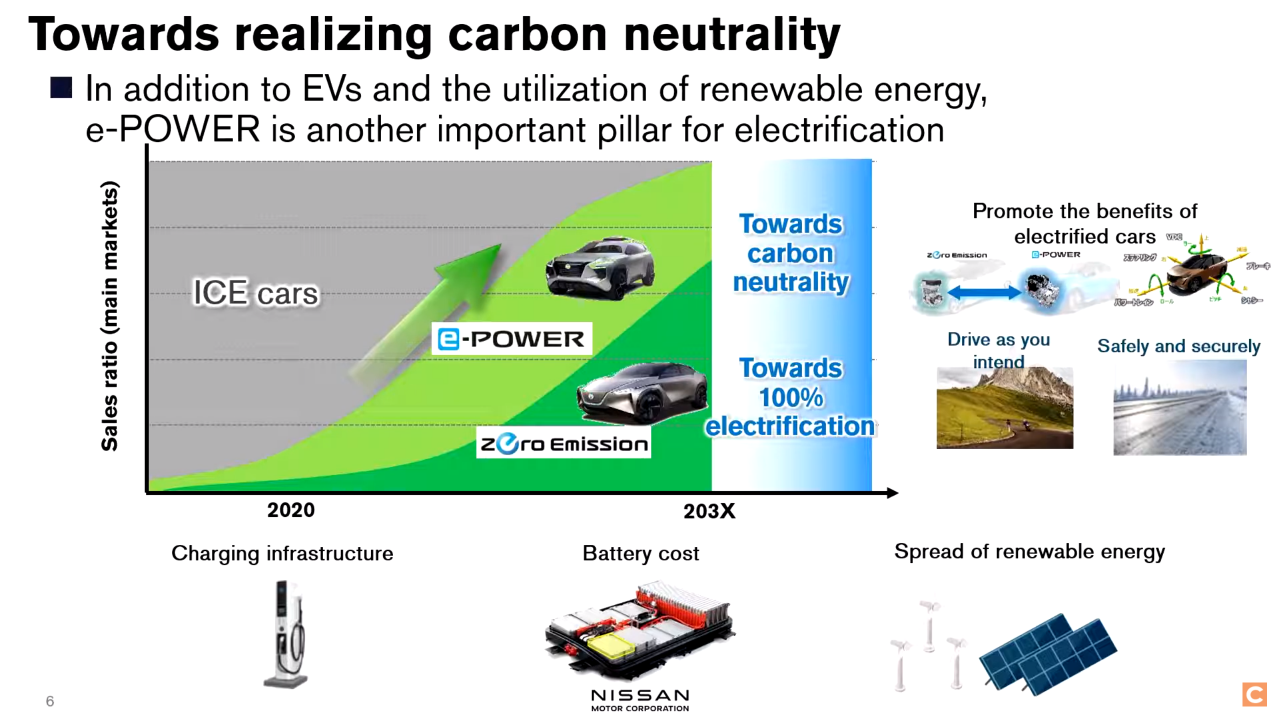

Per Nissan, e-POWER non è solamente la denominazione commerciale del sistema full hybrid adottato nei suoi veicoli, ma è anche il nome di una delle chiavi della strategia di elettrificazione delle suo auto che, assieme alle EV denominate "Zero Emission" e ad altri importanti accorgimenti di contorno (innovazione sugli accumulatori, uso degli stessi come sistemi d'accumulo per le rinnovabili "intermittenti" ed un efficace sistema di riciclo/riuso dei veicoli/componenti a fine vita), condurrà il marchio verso la tanto ricercata "Carbon neutrality".
Come si può vedere a partire dalla slide n. 6, da qui al 2030, secondo Nissan l'ibridazione massiva avrà un ruolo importante per il marchio, sia per il numero di vendite globali, che in termini di contributo nel raggiungimento dell'obiettivo finale (concreto abbattimento delle emissioni).
Nella slide n. 10, Nissan confronta le emissioni medie nel corso dell'intero ciclo di vita di varie tipologie di veicoli (benzina, ibridi e-Power ed elettriche) attualizzate alla tecnologia contemporanea. I "rettangoli tratteggiati" invece, sono la stima del risultato della riduzione di CO2 sul ciclo di vita delle auto, ricorrendo alle future tecnologie in sviluppo dal marchio nipponico.
Saltando a pag. 19, Nissan esplicita chiaramente come, con il raggiungimento dell'ambito traguardo del 50% di efficienza del sistema propulsivo, possa portare i loro veicoli ibridi e-Power ad un impatto ambientale medio (nell'intero ciclo di vita) pari a quello delle loro EV. Questo quantomeno durante la fase di transizione (almeno una decina di anni) verso un più tangibile mix di energie rinnovabili (o prive di emissioni dirette, come il nucleare, aggiungo io) ed il miglioramento delle tecnologie per un massiccio ricorso al riciclo e riutilizzo dei materiali/componenti dei veicoli dimessi.
