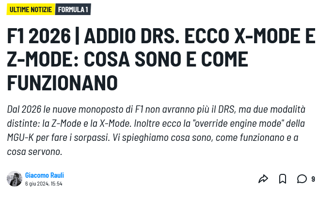

Dai 290km/h l'apporto del motore elettrico inizia a calare (anche per i motivi che già sappiamo riguardo le BEV) fino ad annullarsi a 355km/h, e sarà così per tutti in qualsiasi situazione.
L'overboost del Manual Override Mode è una cosa a parte...

Vi lascio questi 2 articoli del sito ufficiale della F1 con degli approfondimenti riguardo:
aerodinamica/telaio
EXPLAINED: From more agile cars to 'X-mode' and 'Z-mode' – unpicking the 2026 aerodynamics regulations

I hear there’s a cool new active aerodynamics system being introduced. What’s this all about?
Indeed there is. The 2026 machines will feature movable front and rear wings to promote closer racing.
The front wing will be 100mm narrower and have a two-element flap. The rear wing will also have three elements, with the lower beam wing removed.
In a system similar to the DRS overtaking aid, when standard Z-mode is deployed, the elements on the front and rear wings will open and be angled to allow cars to deliver greater cornering speeds.
Drivers can then switch to X-mode, which is a low-drag configuration that sees the flap angle change on both the front and rear wing to maximise straight-line speed.
The system will be driver-activated and available in certain parts of the track where lower levels of downforce are safe.
The FIA say that based on current discussions, they are anticipating it will be available for any straight line longer than three seconds.

Now while we’re talking about extra energy, can you explain what this manual override mode is all about?
Sure, this is a new feature that has been added to the 2026 rules in a bid to improve overtaking opportunities.
How does it work? Well, while the energy deployment of the leading car will taper off after 290kph, reaching zero at 355kph, the following car can benefit from the ‘MGU-K Override’ which provides 350kW all the way up to 337kph – that works out at around 0.5MJ of extra energy.
It can be used anytime a driver is within one second of the car in front.

una domanda da ignorante, ma a livello sportivo, che differenza c'è tra DRS e Override cazzi e mazzi, che differenza c'è? A me il secondo sembra addirittura peggio del primo
3 minuti fa, Aymaro scrive:
La differenza penso che stia nel fatto che il drs sotto il secondo puoi attivarlo sempre e comunque nelle zone drs, l'override puoi utilizzarlo ma metti sotto sforzo la batteria (usura) e potrebbe portarti a dover risparmiare successivamente per ricaricarla o addirittura a non poterla utilizzare. Sotto questo aspetto è molto più "democratico" del drs.
