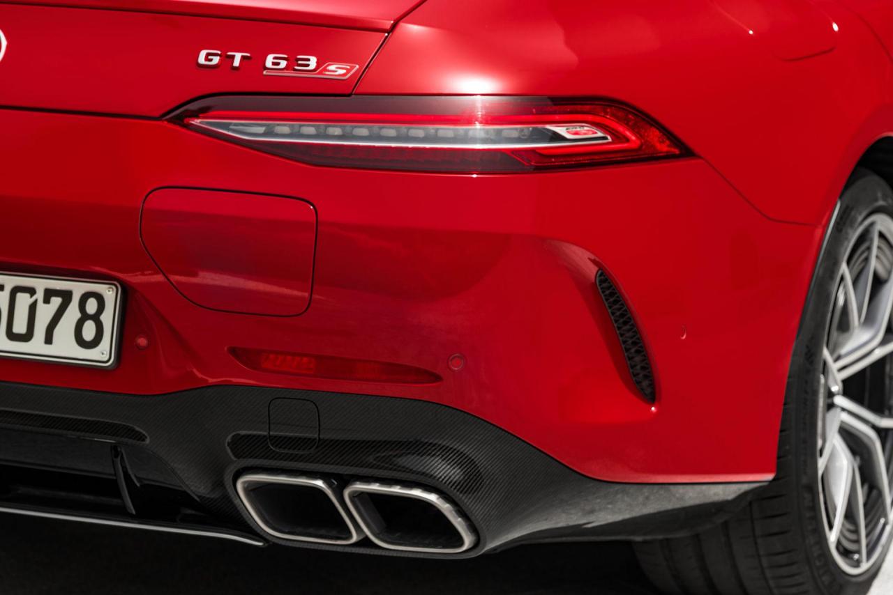

Exclusive identification features at the rear are the rear apron with integrated plug-in charging flap and the model designation highlighted in red. With the hybrid, AMG is also introducing externally fluted trapezoidal twin exhaust tailpipes. The "E PERFORMANCE" badge on the wings indicates the hybrid drive. As in the entire model series, numerous paint finishes and equipment features are available for the hybrid version. For example, there are four matt paint finishes, five metallic finishes and two non-metallic finishes to choose from. In addition, there are seven new paint finishes from the extended customisation range. The exterior design can be further accentuated with the new AMG Night Package II or a combination of the Night Package and Carbon Package, for example. In addition, there are new 20 and 21-inch light-alloy wheels, each in two colour variants. The exclusive Edition is also available for the performance hybrid.

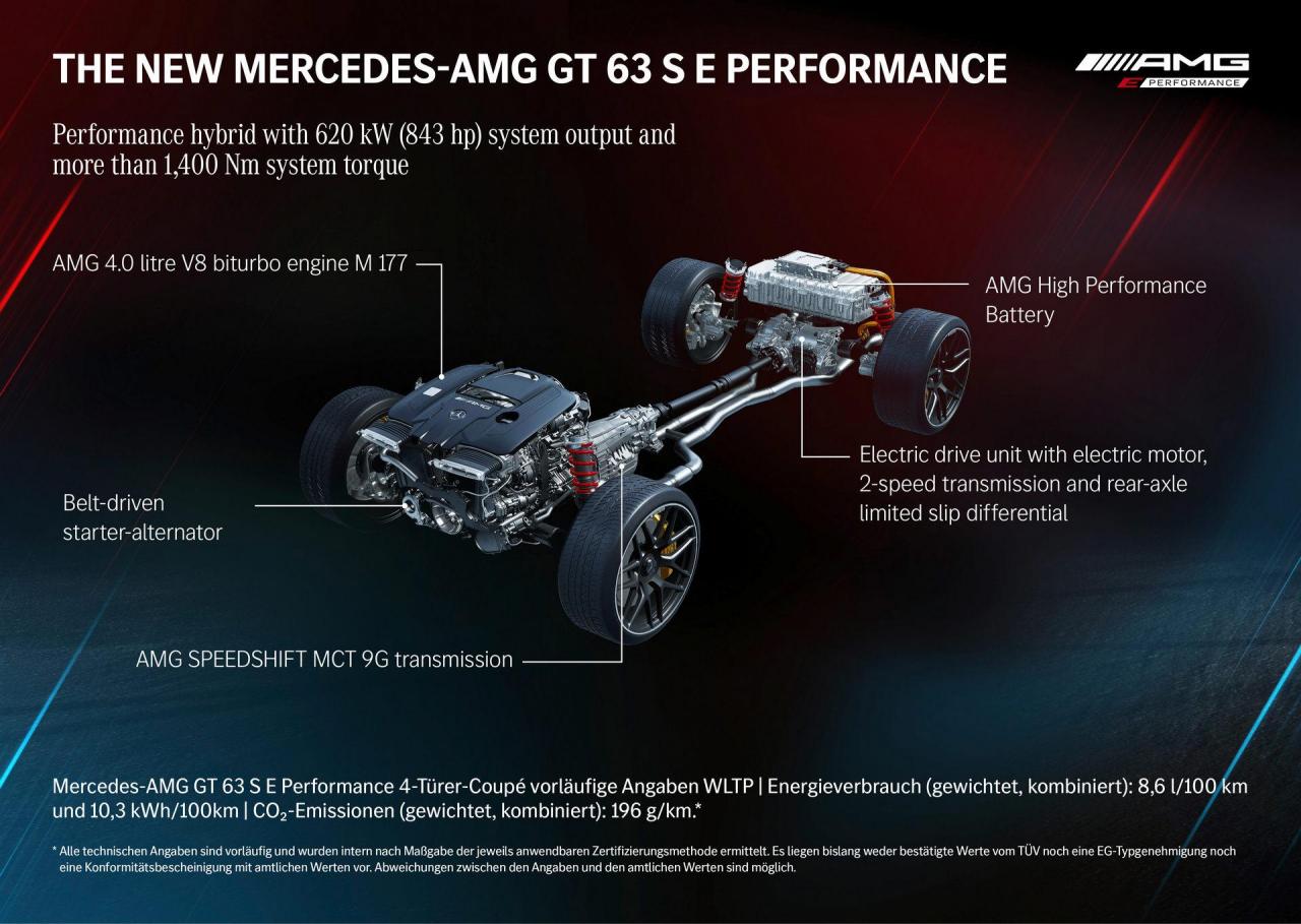

The details of the AMG-specific Performance hybrid drive: combustion engine in the front, electric motor in the rear
In the AMG GT 63 S E PERFORMANCE, the 4.0-litre V8 biturbo engine is combined with a permanently excited synchronous electric motor, a high-performance battery developed in Affalterbach and the fully variable AMG Performance 4MATIC+ all-wheel drive system. The combination of the 4.0-litre V8 biturbo engine and electric motor generates a system output of 620 kW (843 hp) and a maximum system torque of more than 1,400 Nm. The driving performance of the most powerful series-production vehicle from Affalterbach to date is correspondingly impressive: acceleration from a standstill to 100 km/h takes just 2.9 seconds, and 200 km/h is reached in less than ten seconds. Acceleration only ends at 316 km/h.
The 150 kW (204 hp) electric motor is positioned at the rear axle, where it is integrated with an electrically shifted two-speed gearbox and the electronically controlled limited-slip rear differential in a compact electric drive unit (EDU). Experts refer to this layout as a P3 hybrid. The lightweight high-performance battery is also located in the rear above the rear axle. This compact design has numerous advantages:
  • The electric motor acts directly on the rear axle and can therefore convert its power more directly into propulsion - for that extra boost when moving off, accelerating or overtaking.
  • The power of the electric motor can inherently be applied at full torque, therefore particularly agile starting is possible.
  • In addition, the driver immediately experiences a noticeable performance increase thanks to the integrated, electronically controlled limited-slip rear differential: The hybrid model is even more agile when accelerating out of bends, and provides more traction and therefore more driving safety.
  • As slip at the rear axle increases, the drive power of the electric motor is also transferred to the front wheels as required for more traction. The mechanical connection of the fully variable all-wheel drive makes this possible by means of a propshaft and the drive shafts of the front wheels.
  • The positioning on the rear axle improves the weight as well as the axle load distribution in the vehicle and thus forms the basis for the convincing handling.
  • The AMG concept offers very high regeneration efficiency, as the system allows only minimal mechanical and hydraulic losses from the engine and transmission.
  • The automated two-speed transmission at the rear axle with its specially calibrated gear ratio ensures the spread from high wheel torque for agile starting to safe continuous output at higher speeds. An electric actuator engages second gear at around 140 km/h at the latest, which corresponds to the electric motor's maximum speed of around 13,500 rpm.
  • With the increase in performance due to the additional electric motor, the development team was also able to improve the efficiency of the entire vehicle in parallel - and achieve lower emissions as well as lower consumption.

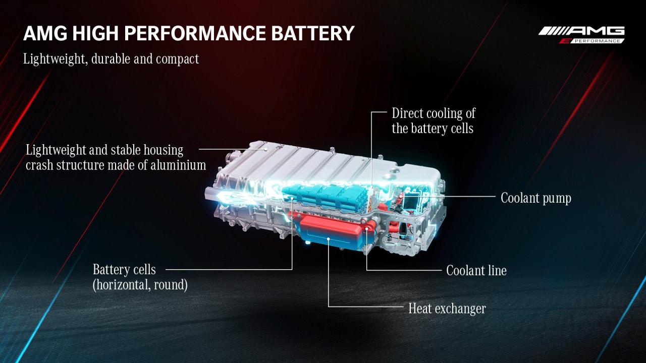

Inspired by Formula 1, developed in Affalterbach: the AMG high-performance battery
When defining the electrification strategy, it was clear from the outset that all essential components would be developed in Affalterbach. At the heart of this is the AMG high-performance battery (HPB). Development of this lithium-ion battery was inspired by technologies that have already proven themselves under the toughest conditions in the Mercedes-AMG Petronas F1 team's Formula 1 hybrid racing cars. In the course of development, there was a lively exchange of expert knowledge between the High Performance Powertrains (HPP) Formula 1 engine shop in Brixworth and Mercedes-AMG in Affalterbach. The AMG high-performance battery combines high power that can be called up frequently in succession with low weight to increase the overall performance of the vehicle. Added to this are the fast energy draw and the high power density. This means that during a brisk drive in hilly terrain, for example, drivers can immediately call on the full power potential on uphill stretches, while regeneration is strong when driving downhill.
70 kW continuous output and 150 kW peak output
The high-performance battery of the AMG GT 63 S E PERFORMANCE has a capacity of 6.1 kWh, 70 kW of continuous output and 150 kW of peak output for ten seconds. The low weight of only 89 kilograms allows the very high power density of 1.7 kW/kg. For comparison: conventional batteries without direct cooling of the cells achieve about half of this figure. Charging is via the 3.7 kW on-board AC charger, at a charging station, wallbox or household socket. The battery is designed for fast power delivery and draw, not for the longest possible range. Nevertheless, the electric range of 12 kilometres allows a practical operating radius, for example for quiet and emission-free driving from a residential area to the outskirts of the city or to the motorway.
The innovation push: the direct cooling of the battery cells
The basis for the high performance of the AMG 400 volt battery is the innovative direct cooling: for the first time, a high-tech coolant based on an electrically non-conductive liquid flows around all 560 cells and cools them individually. Every battery needs a defined temperature for optimum power delivery. If the battery becomes too cold or too hot, it noticeably loses power at times, or has to be regulated to avoid damage if the heat becomes excessive. The even temperature of the battery therefore has a decisive influence on its performance, service life and safety. Conventional cooling systems, which only cool with air or the entire battery pack indirectly with water, quickly reach their limits - especially as the requirements continue to increase due to cells with ever increasing energy density. If the thermal management does not fulfil its function optimally, the battery is at risk of ageing prematurely.
For the direct cooling, the AMG specialists had to develop new cooling modules that are only millimetres thin. Around 14 litres of coolant circulate from top to bottom through the entire battery past each cell with the help of a specially developed high-performance electric pump, also flowing through an oil/water heat exchanger attached directly to the battery. This conducts the heat into one of the vehicle's two low-temperature (LT) circuits, and from there to the LT radiator at the front of the car where it is released into the outside air. The system is designed to ensure even heat distribution in the battery.
The result is that the battery is always within a consistent, optimum operating temperature window averaging 45 degrees Celsius, no matter how often it is charged or discharged. It may well be that the average temperature is exceeded when driving at high speeds. The protection mechanisms are therefore configured so that the maximum performance can be obtained from the battery, with the temperature level subsequently lowered by direct cooling. Conventional cooling systems cannot cope with this, and the battery can no longer fully utilise its potential. That is not the case with the AMG high-performance battery: even during fast laps in hybrid mode on the race track, where acceleration (battery is discharged) and deceleration (battery is charged) are frequent, the energy storage system retains its high performance capacity.
Only effective direct cooling makes it possible to use cells with a very high power density. Thanks to this individual solution, the battery system is particularly light and compact. The low weight is also due to the material-saving busbar concept, and the lightweight yet strong crash structure of the aluminium housing. It ensures the highest level of safety.

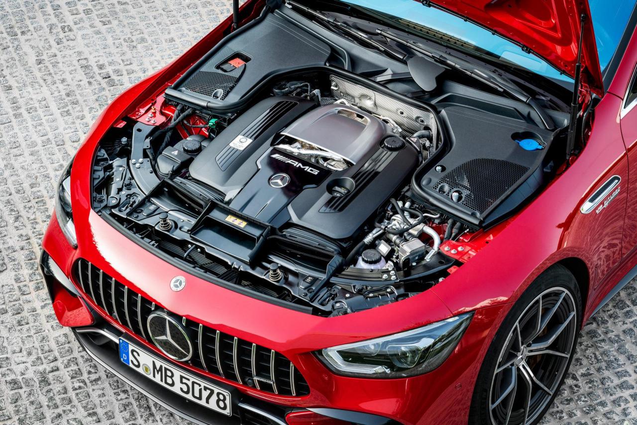

AMG 4.0-litre V8 biturbo engine with twin-scroll turbochargers
As the new top model in the range, the AMG GT 63 S E PERFORMANCE benefits from the performance of the AMG 4.0-litre V8 biturbo engine with 470 kW (639 hp) and a maximum torque of 900 Nm, which is available over a wide rpm band from 2500 to 4500 rpm. This harmonises perfectly with the electric motor, which delivers its maximum of 320 Nm right from the start.
Two twin-scroll turbochargers are partly responsible for the high power output, combining optimum response at low engine speeds with a high increase in power at higher engine speeds. In addition to this, the turbine housing is divided into two flow passages which run parallel to one another. Combined with two separate ducts in the exhaust manifold, this makes it possible to individually control the momentum of the exhaust gases acting on the turbine wheel. One duct is fed by the exhaust gases of the first and second cylinders of a cylinder bank, the other by the exhaust gases of the third and fourth cylinders. The aim is to prevent the individual cylinders from having mutually adverse effects on the gas cycle. This reduces the exhaust gas back-pressure and improves the gas exchange.

Ma la presa la dovevano piazzare proprio lì? Sembra posticcia
6 ore fa, Albe89 scrive:
A parte l'auto che non mi è mai piaciuta.
Molte, se non tutte, le Mercedes plug-in hybrid hanno la presa sul paraurti posteriore, la tipica "presa per il culo". In effetti scomoda per molti parcheggi con colonnina e soprattutto in caso di tamponamento.

Batteria AMG 6,1kWh, potenza 70kW/150kW (durata/massima) con un peso di 89kg.
Per caso sai i valori della batteria Ferrari?
Sulla SF90, Ferrari usa unna batteria di 7,9kWh (6,5kW usabili) con potenza di 162/180kw e peso di 72kg.
1 minuto fa, iDrive scrive:
..grazie..poi un po' piu capacita con meno peso alla Ferrari..
E 6,5kW per 25Km, sono 26kW per 100Km sembrano un consumo abbastanza bene, mentre i 6,1 per 12km della Mercedes, sono quasi 59kW per 100Km, sembrano molto strano.....
