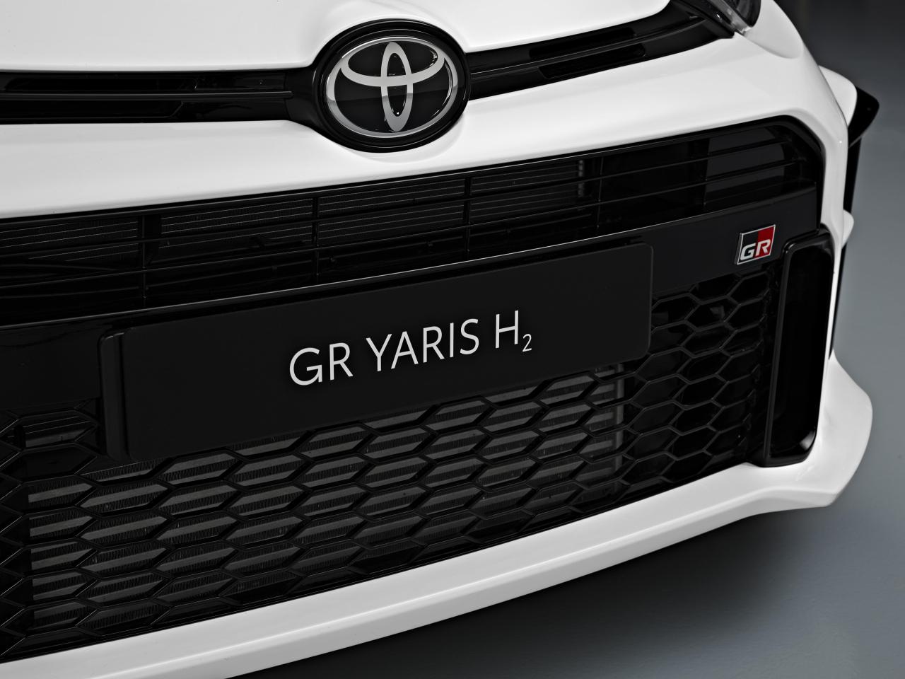

Toyota continua il suo push sull'idrogeno, presentando il concept GR Yaris H2 ,dotato del medesimo propulsore presente sulla GR Corolla da corsa attualmente impegnata nel campionato giapponese.
Tutti i dettagli sulla press release qui sotto!

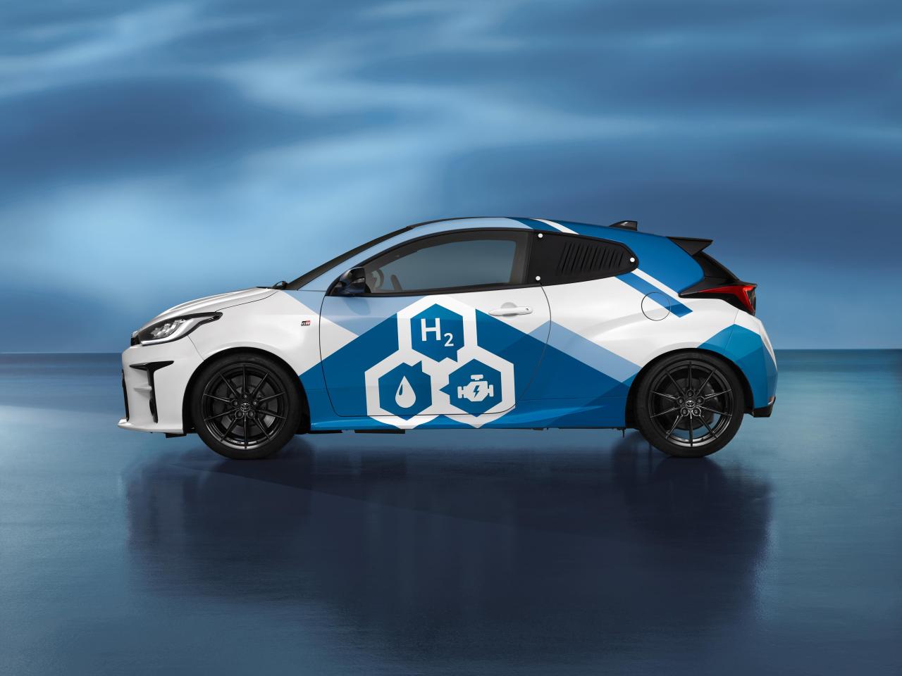

Toyota today showcased its experimental hydrogen-powered combustion engine technology in the multiple award-winning GR Yaris.
The hydrogen fuel, fuel tanks and refuelling process of the experimental vehicle are the same as found in the Mirai, Toyota’s commercially available flagship fuel cell electric vehicle.
However, whilst the Mirai employs chemical reaction in the fuel cells to generate energy, the experimental GR Yaris features an internal combustion engine with hydrogen as the fuel.
While the hydrogen combustion engine technology is still in the early stages of conceptual development and experimentation, which started in 2017 and not yet ready for commercialisation, Toyota’s experimental hydrogen-powered Corolla Sport is already delivering high performance at motorsport events in Japan with almost zero tailpipe emissions.
Japan’s auto industry must succeed in building passenger vehicles. To this end, manufacturers must participate in auto-racing to test their vehicles’ durability and performance and display their utmost performance. With competition comes progress, as well as excitement among motoring fans. The aim of racing is not just to satisfy our curiosity, but rather to enable the development of the Japanese passenger vehicle industry.
Kiichiro Toyoda, Founder of Toyota Motor Corporation (March, 1952)
The hydrogen-powered experimental GR Yaris and the Corolla Sport both feature the same G16E-GTS, 1.6-litre, in-line 3-cylinder, turbocharged engine that is found in the award-winning GR Yaris, but with a modified fuel supply and injection system for use with hydrogen as fuel.
