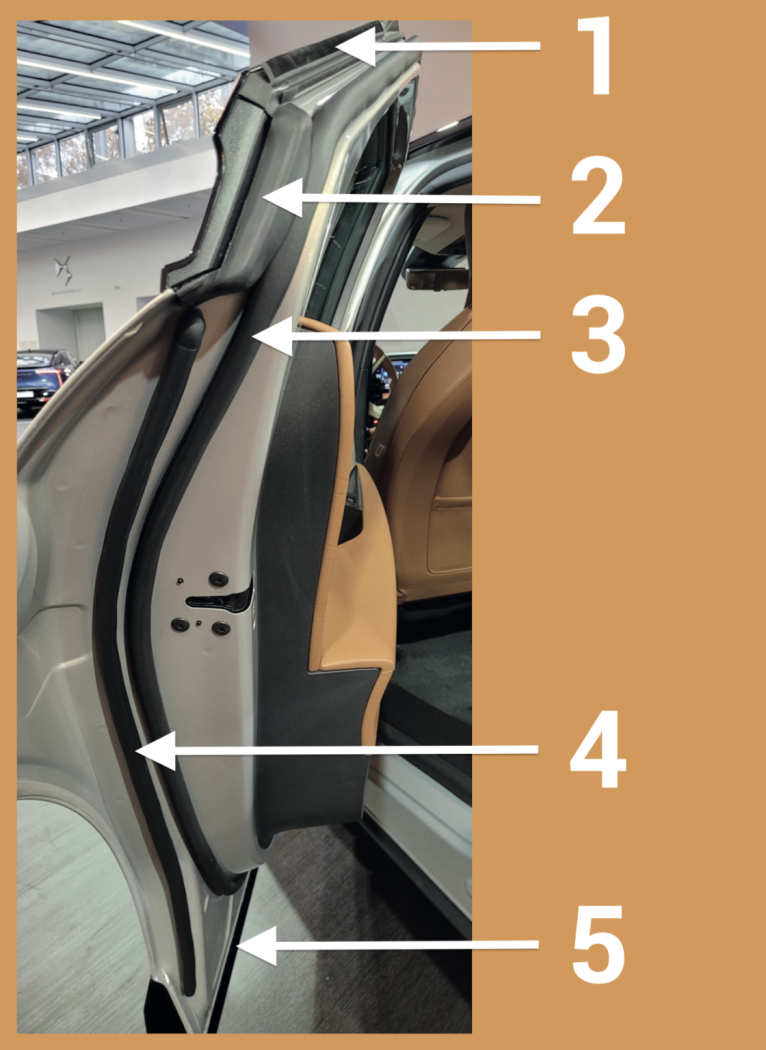

Above, a detailed view of the rear door of DS N°8. In 1, a top door felt at the roof junction. In 2, delicate work carried out on the opening handle, for watertightness and acoustics. In 3, the classic door perimeter seal. In 4, an additional seal and in 5, the overhang of the outer finish of the rocker panel. [...]
