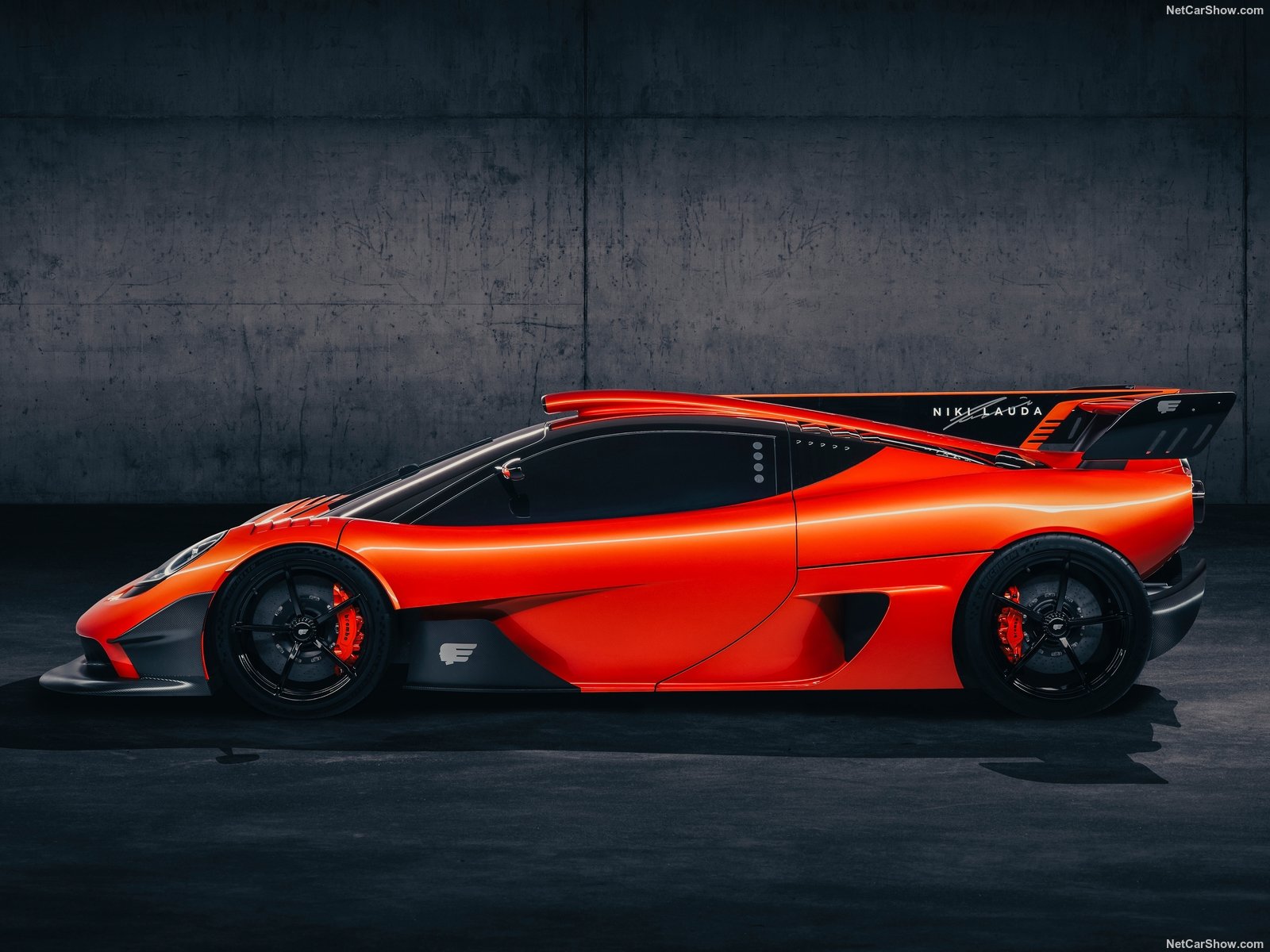

Nel giorno del 72esimo compleanno di Niki Lauda, viene presentata questa versione track focus della T.50.
25 esemplar prodotti, ad un prezzo di 3,1 milioni di sterline; il 3.9 V12 viene portato a 725bhp (+76bhp rispetto alla versione stradale e -16Kg di peso) e può raggiungere i 12.100 giri/min. Il peso scende a 852Kg (-134Kg rispetto alla versione stradale).
Cambio Xtrac sequenziale a 6 marce.
Ventolone posteriore sempre in modalità High Downforce a 7000 giri/min
Al di là del dato della velocità Murray riferisce che il carico aerodinamico calcolato è stato di 1900Kg di downforcema han dovuto ridurro a 1500Kg per non compromettere la dinamica dell'auto.

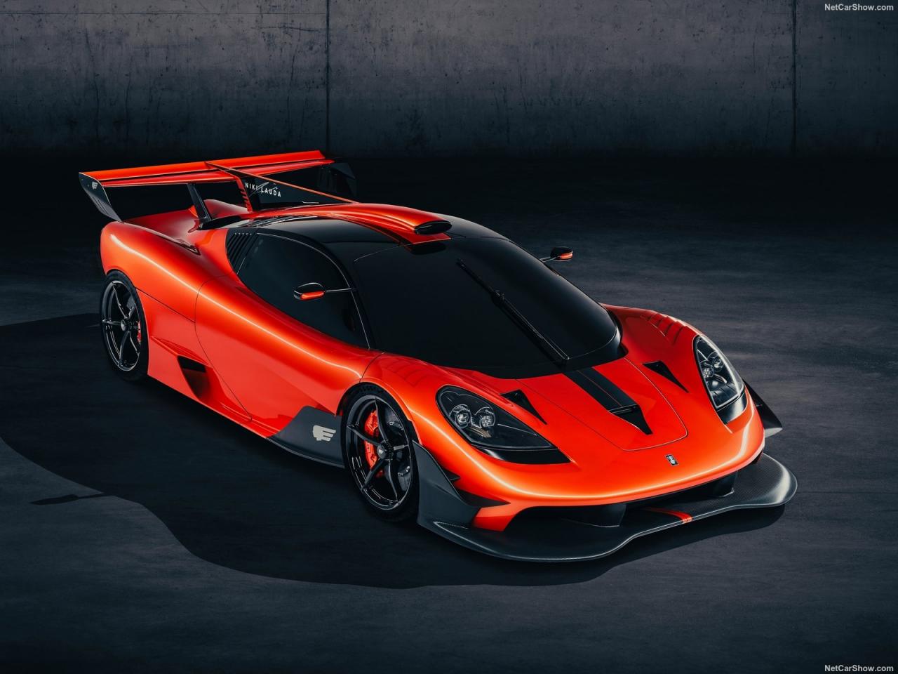

Gordon Murray Automotive has unveiled its T.50s Niki Lauda track-focused supercar for the first time. Developed in parallel with the T.50, the most driver-centric supercar ever built, the T.50s Niki Lauda has been conceived, designed and engineered to offer the ultimate on-track driving experience.
Like the T.50, the T.50s Niki Lauda has been designed and engineered without compromise, but with an even more extreme specification. It weighs just 852kg and will be powered by a substantially redesigned version of the T.50's Cosworth-engineered 3.9-litre V12, producing 725bhp, revving to 12,100rpm and going through a newly-designed Xtrac six-speed paddle-shift gearbox. Advanced aerodynamics, aided by a 400mm rear-mounted fan, will produce up to 1500kg of downforce for optimum track performance.
Just 25 T.50s Niki Laudas will be made, costing £3.1m (before taxes). Production will start in January 2023 at Gordon Murray Automotive's manufacturing centre in Dunsfold, Surrey, UK, after the run of 100 T.50 supercars is completed.
Professor Gordon Murray CBE: "The T.50 is the ultimate road-going supercar, but I always dreamed of taking it one step further... to build a version that will deliver an on-track driving experience like no other car in history. When we created the McLaren F1 GTR it was developed from the F1 road car. From its inception the T.50s Niki Lauda, though, was designed in parallel with the T.50. For the T.50 our target was clear, to make the best driver's car for the road. With the T.50s Niki Lauda it was equally clear, to make it the best driver's car for the track. Putting it another way, we asked ourselves what would be the coolest thing to drive on track and create a track driving experience like no other car in history? We had no interest in achieving the ultimate lap time or creating an over-tyred and over-downforced spaceship at the expense of driver involvement, because ultimately you have to possess an F1 driver level of skill and fitness to get the best out of them. Instead, I laid out some parameters to create the ultimate driver's car and experience on track: a central driving position, a V12 just behind your ear revving to over 12,000rpm, producing over 700 horsepower and with an even faster response time than the T.50, downforce limited to 1500kg and a weight of under 900kg. Plus the ability to turn up at any track, make a few basic checks and have fun, without the need for an entire support crew. In my view, it doesn't get better than that and is driving in its purest form. The T.50s Niki Lauda will give a visceral connection between driver, car and track, the like of which has not been experienced to date. I can just imagine going round your favourite circuit, sitting in the middle with that unsilenced V12 screaming just behind you - the driving experience will be something special. With a power-to-weight ratio better than that of a naturally aspirated LMP1 car, it is also going to be searingly quick and, with such a low weight, will change direction like an F1 car. With the direction of travel of the automotive industry, it's hard to imagine that there will ever be another car quite like this. Especially not one with a central driving position, a high-revving naturally aspirated V12 engine and that is so lightweight. I believe it will go on to define its era."

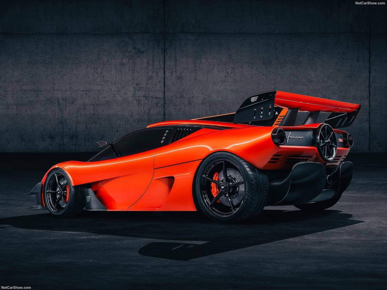

Gordon Murray and the team have worked hard on the T.50s body design to achieve their aerodynamic performance targets, whilst retaining the T.50's balanced and classic proportions.
The dramatic aerodynamic features of the T.50s Niki Lauda instantly give away its performance potential. A striking central fin designed to enhance stability features a Niki Lauda logo. At the rear, the distinctive 400mm fan from the T.50 is retained, accompanied by an even larger rear diffuser and a new delta wing. The rear grille features a T.50s badge and 'Fan Car' script.
The aerodynamic elements continue at the front of the car. Barge boards are sculpted to improve airflow to the side ducts, which house the oil cooling systems for the engine and transmission. A splitter and dive planes are also prominent and further reflect the car's aero-influenced design. At the same time, the purity of the T.50 is not lost, creating a purposeful yet elegant look.

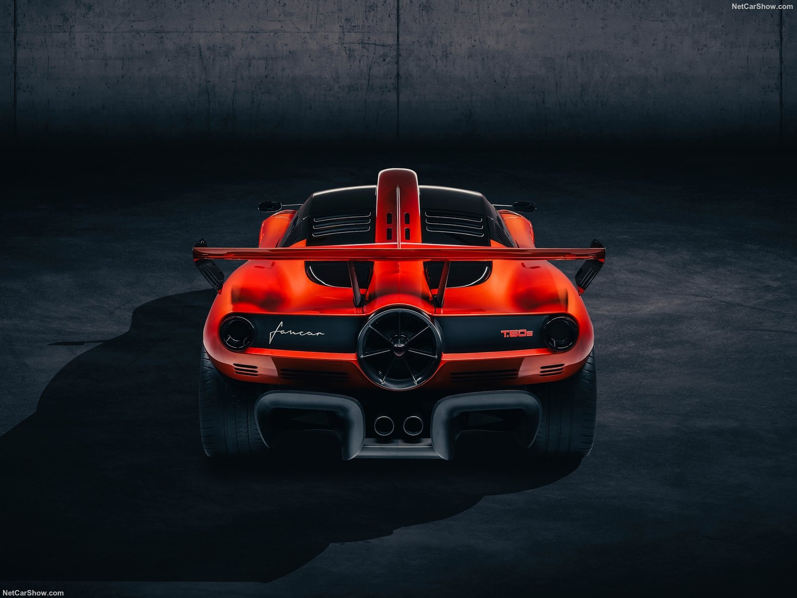

Aerodynamics
The T.50s Niki Lauda has completely new aero, which combines to create 1500kg of downforce. This includes a new 1,758mm-wide, rear-mounted delta wing, the design of which was inspired by the front wing on Murray's 1983 Brabham BT52 Formula One car and is just as effective today as it was then.

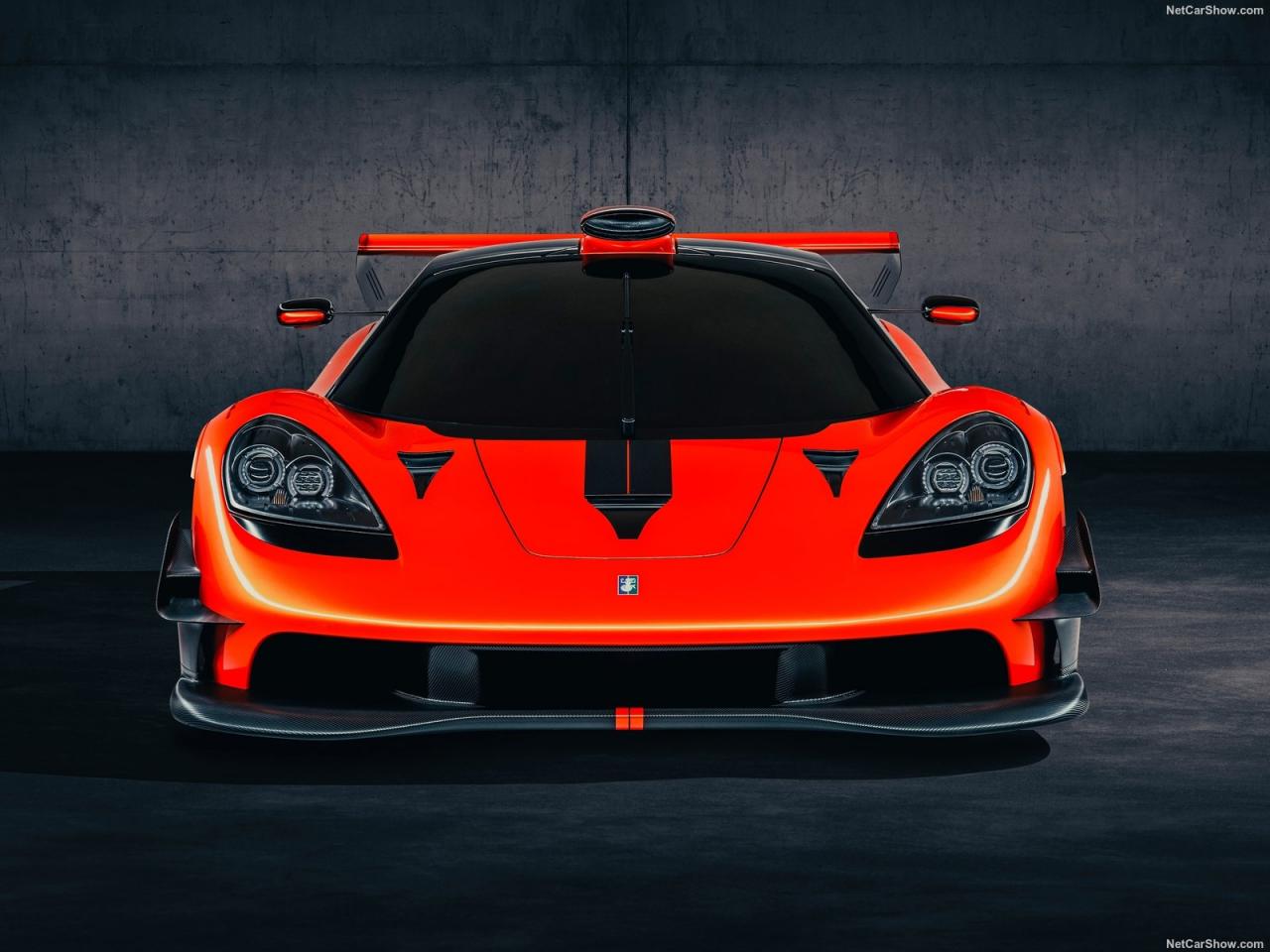

The front of the T.50s features a splitter with a central aerofoil section, which generates huge load figures to balance out those from the rear wing. The splitter's central channel reduces the car's sensitivity to pitch while allowing airflow under the car to continue to drive the central diffuser section, keeping the efficiency of the entire aero package high.
Dive planes include horizontal elements paired with a vertical duct to manage wheel arch pressures and tyre wake, reducing drag and improving efficiency. A pair of NACA ducts have been perfectly positioned on the front clam shell in a region of high pressure and where the thin boundary layer is ideal for cooling the large front brakes.
A central fin stretching from the top of the roof to the rear lip of the car has also been added for increased yaw stability. The large vertical face is presented to the airflow during high-speed cornering and helps counteract the momentum of the car towards the outside of the corner.
To further improve airflow and accommodate the central fin, the oil cooling systems for the engine and transmission are now located in side ducts. By placing these systems lower in the car, this helps to optimise its centre of gravity.
With the powertrain coolers located directly downstream of the front wheels, barge boards have been added to manage the turbulent wake emanating from the front wheel arches, ensuring a clean flow of air to the side ducts.
The T.50s Niki Lauda retains the same 400mm ground-effect fan as the T.50, but here it runs in a single High Downforce mode, spinning at 7000rpm. The T.50s also has much simpler ducting, with a permanently open duct running down to the redesigned rear diffuser.
Like the chassis, the T.50s Niki Lauda's aerodynamics can be adjusted to suit its owner's preferences, adding or removing downforce as required. To balance the car's aero, the front diffusers are adjustable, as is a slotted flap on the rear wing. The high-speed balance can be further honed through changes to the car's ride height.
In the optimum configuration, when a particular race circuit demands it, up to 1500kg of downforce will be achievable. However, the car's aerodynamics have been carefully designed to ensure that the T.50s Niki Lauda's performance remains accessible and exploitable regardless of the driver's experience.

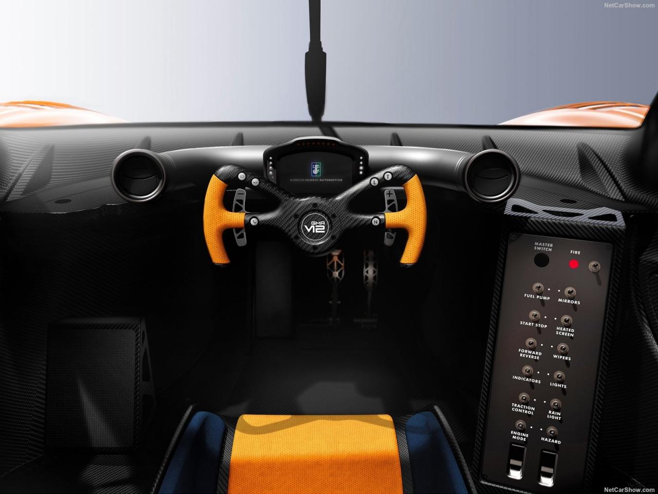

The dihedral doors lift to reveal a race-car oriented cabin. The T.50s Niki Lauda retains the driver-focused central seating position of the T.50, giving the driver an unhindered view of the track ahead and allowing perfect placement. The driver sits on a full racing carbon fibre seat with fore and aft adjustment and is secured with a six-point harness.
The T.50s is a two-seater with a fixed passenger seat to the left of the driver, complete with a four-point harness. In place of the seat on the right is a fire extinguisher system. Occupying the space formerly taken up by the passenger footwell is a vertical switchgear panel similar to that found on the legendary McLaren F1 GTR. Should the owner wish, the car can be ordered without a passenger seat to save further weight and create an even more focused feel.
The rectangular carbon fibre steering wheel is a lesson in simplicity, featuring only the key controls that the driver needs. This includes buttons for the traction and launch control, as well as the car-to-pit/driver-to-passenger radio and to select neutral. The slim, uncluttered design is influenced by Murray's racing experience.
Professor Gordon Murray CBE: "I used to make my drivers take their watches off, partly for weight, but also because it adds to the steering inertia. Big wheels with lots of switches are quite heavy from a steering inertia point of view, so for the T.50s I wanted to keep the wheel small, clean and simple."
To avoid unnecessary distractions, the T.50s features a single digital screen. This displays essential vehicle and engine data, as well as aero info, the gearchange indicator, telemetry, lap time, tyre pressures/temperatures, g-forces and a camera video feed.
