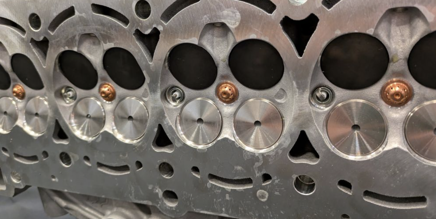

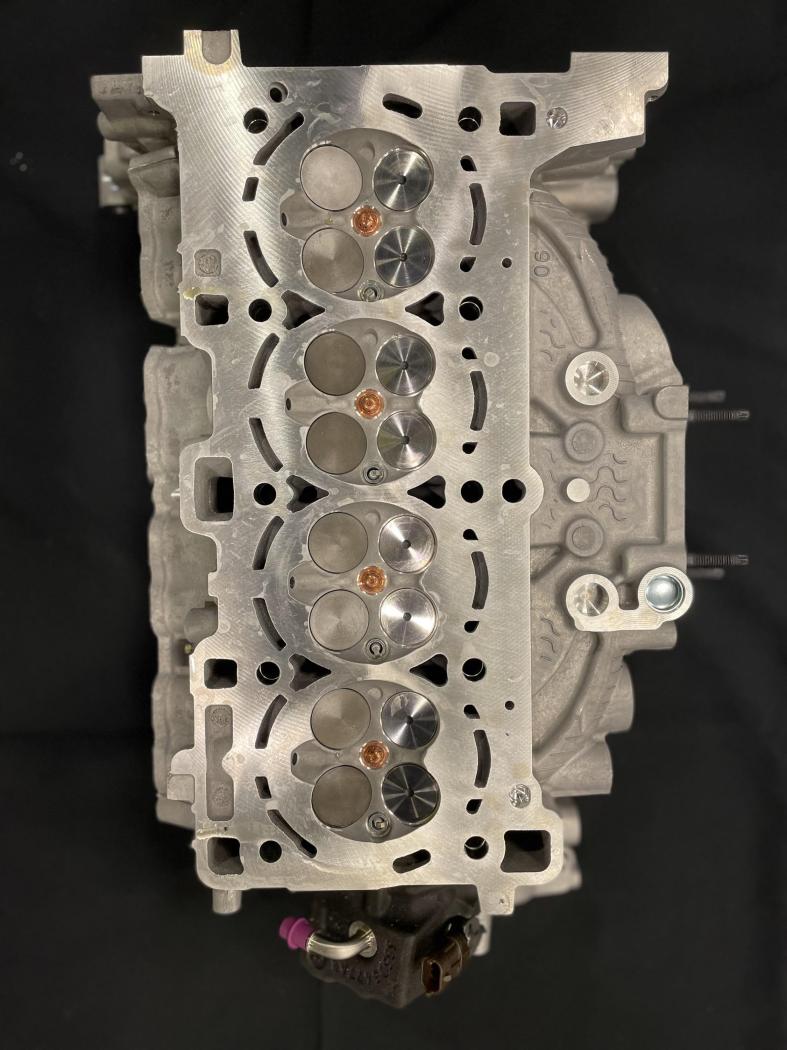

The Hurricane’s healthy power output is made possible in part by turbulent jet ignition, which is employed in Formula 1 engines and the Maserati MC20’s 621-hp twin-turbo V-6. Also called prechamber ignition, TJI adds a small, cup-like combustion chamber inside the main combustion chamber. During the compression stroke, fuel and air are pushed from the primary combustion chamber into this prechamber. A spark plug in the prechamber ignites the gas and jets of fire spray into the main chamber where they ignite the main mixture. “Instead of a spark plug, you’re putting a blowtorch in the chamber,” explains chief engineer Ashish Dubey.
The result is extremely fast and complete combustion, which reduces emissions, improves fuel economy, and increases power. Jeep claims the new engine uses 10 percent less fuel to deliver 20 percent more power than the boosted 2.0-liter it replaces. In the refreshed Grand Cherokee, we’re told the Hurricane 4 will be good for 0–60-mph times between 6.0 and 7.0 seconds, a 6,200-pound towing capacity, and up to 23 mpg combined.
While the size of the prechamber is nearly identical between the Maserati V-6 and the new inline-four, the hardware has been revised for mass production in Dundee, Michigan, where Stellantis will ultimately crank out 111 engines per hour, and in Kokomo, Indiana, where assembly will begin at a later date. Maserati’s Nettuno V-6 uses a large copper insert, roughly the size of a spark plug, that threads into the cylinder head. The Hurricane four uses a copper chamber the size of a pencil eraser that is press-fit into the head. The difference can be seen in the picture below.
Micky Bly, head of global propulsion systems at Stellantis, says the hardware has been consistently reliable during development and that the engineering team has had to focus its efforts on calibrating the advanced combustion system. Each cylinder is fit with two spark plugs, one in the prechamber and one in the main chamber. When the driver demands high torque, only the prechamber spark plug fires. At moderate loads, the prechamber plug fires first followed by the main chamber plug. At idle, low loads, and cold starts, the spark plug in the main chamber leads the prechamber spark plug.

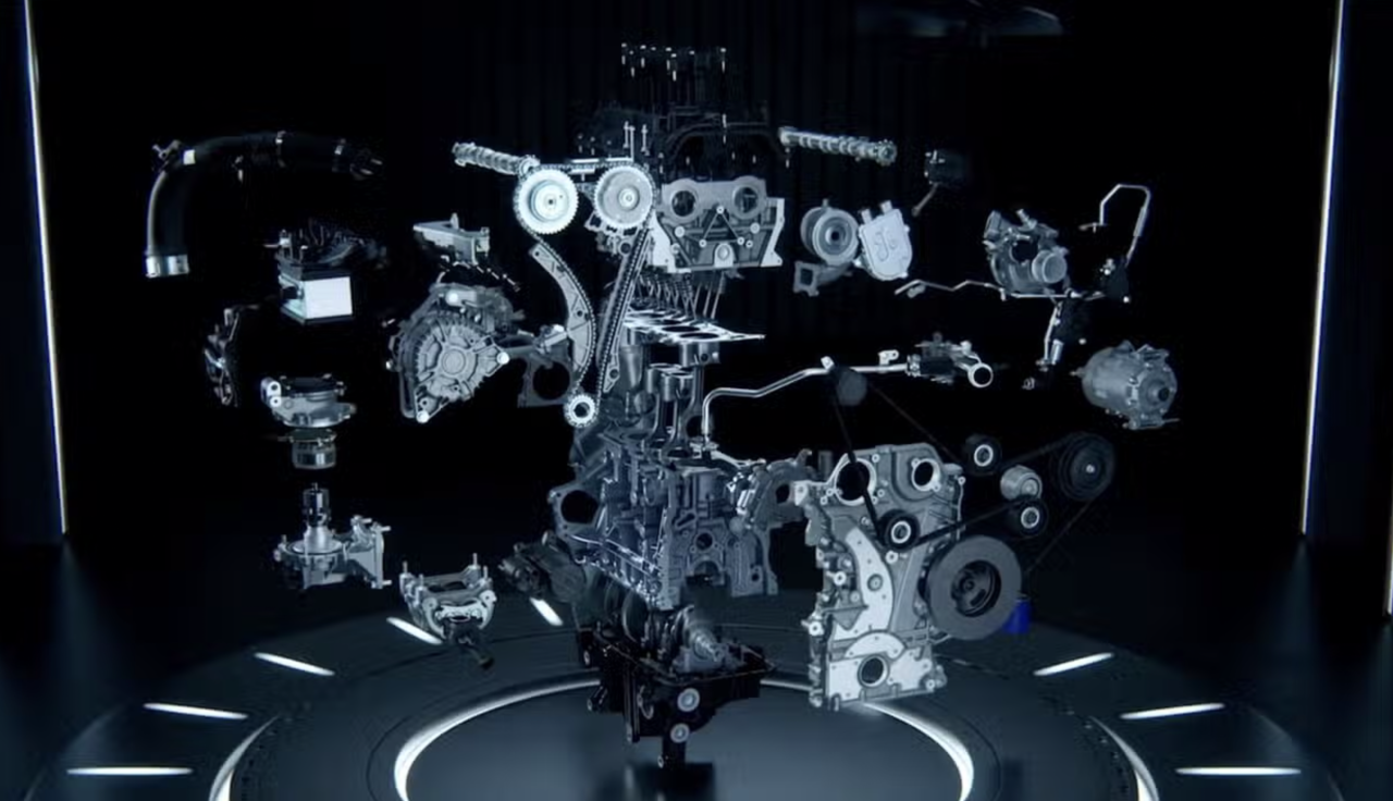

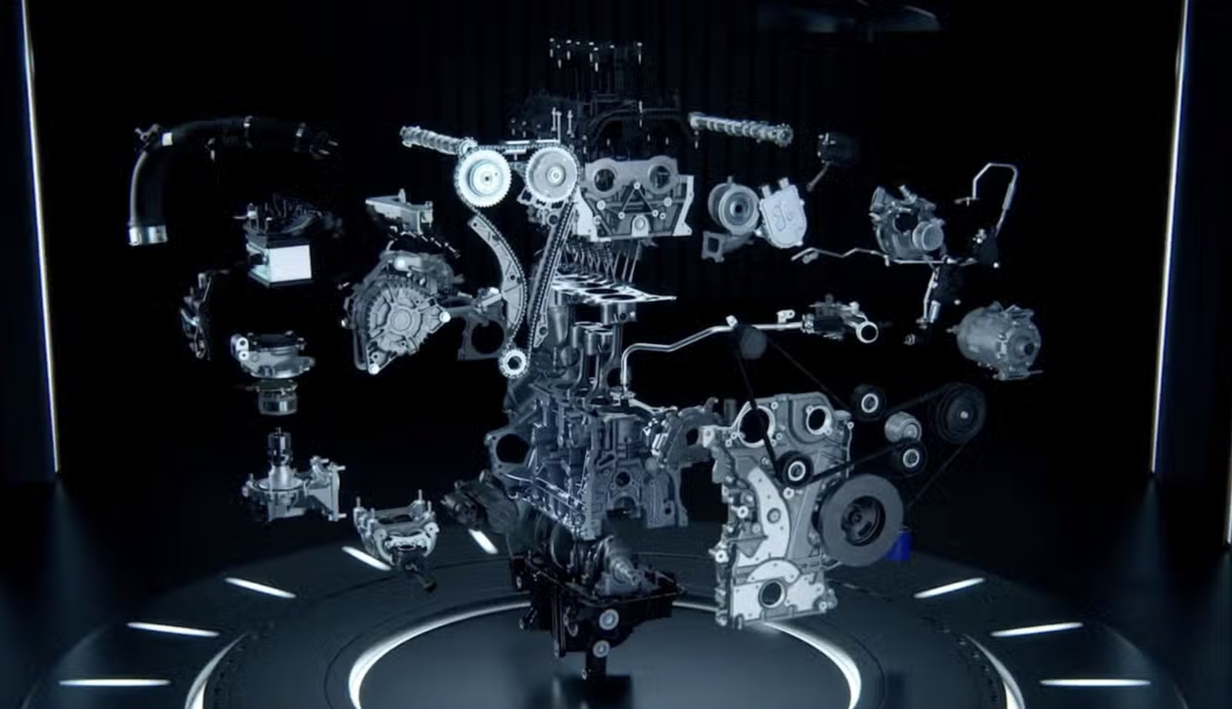

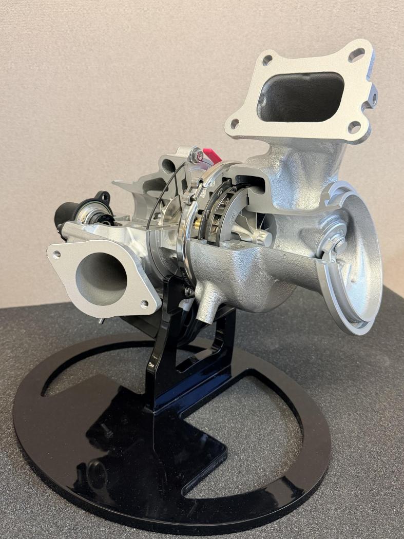

While the name Hurricane 4 makes the new engine sound like an update of the current GME T4 Hurricane four-cylinder engine, Dubey says only a handful of nuts and bolts carry over along with the 84-millimeter bore and 90-millimeter stroke. The turbocharger, which can cram up to 35 psi of boost into the cylinders, now features variable turbine geometry for quick low-rpm and transient responses and less exhaust restriction on the top end. The torque curve plateaus relatively high in the rev range from 3,000 to 4,500 rpm, but 90 percent of the max 332 pound-feet is available from 2,600 rpm to 5,600 rpm. Power peaks at 6,000 rpm. The Grand Cherokee will run on 87 octane, although the output and fuel economy ratings have been achieved on premium gas.
The engine operates at a 12.0:1 compression ratio and runs on the Miller cycle, which closes the intake valve earlier than the traditional Otto cycle for greater efficiency. That change led engineers to adopt an electric intake cam phaser in place of the old engine’s hydraulic adjuster for more precise control. It should enable smoother restarts during stop-start events.

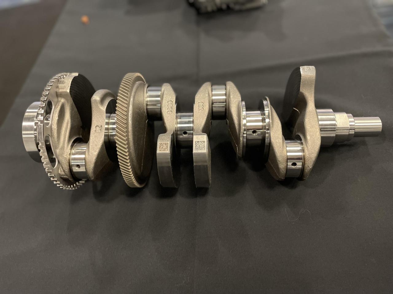

The engine incorporates several measures to improve noise, vibration, and harshness as a result of feedback from current owners of Stellantis vehicles. The cylinder walls are thicker (made possible by trading cylinder liners for a super-thin sprayed-on iron coating), the main and connecting-rod bearings are larger, and the crankshaft damper is fluid-filled. Gearing the balance shafts directly to the crankshaft rather than driving them via chain should be quieter, and the addition of port fuel injectors eliminates the noisy clatter of high-pressure direct injection at idle.
