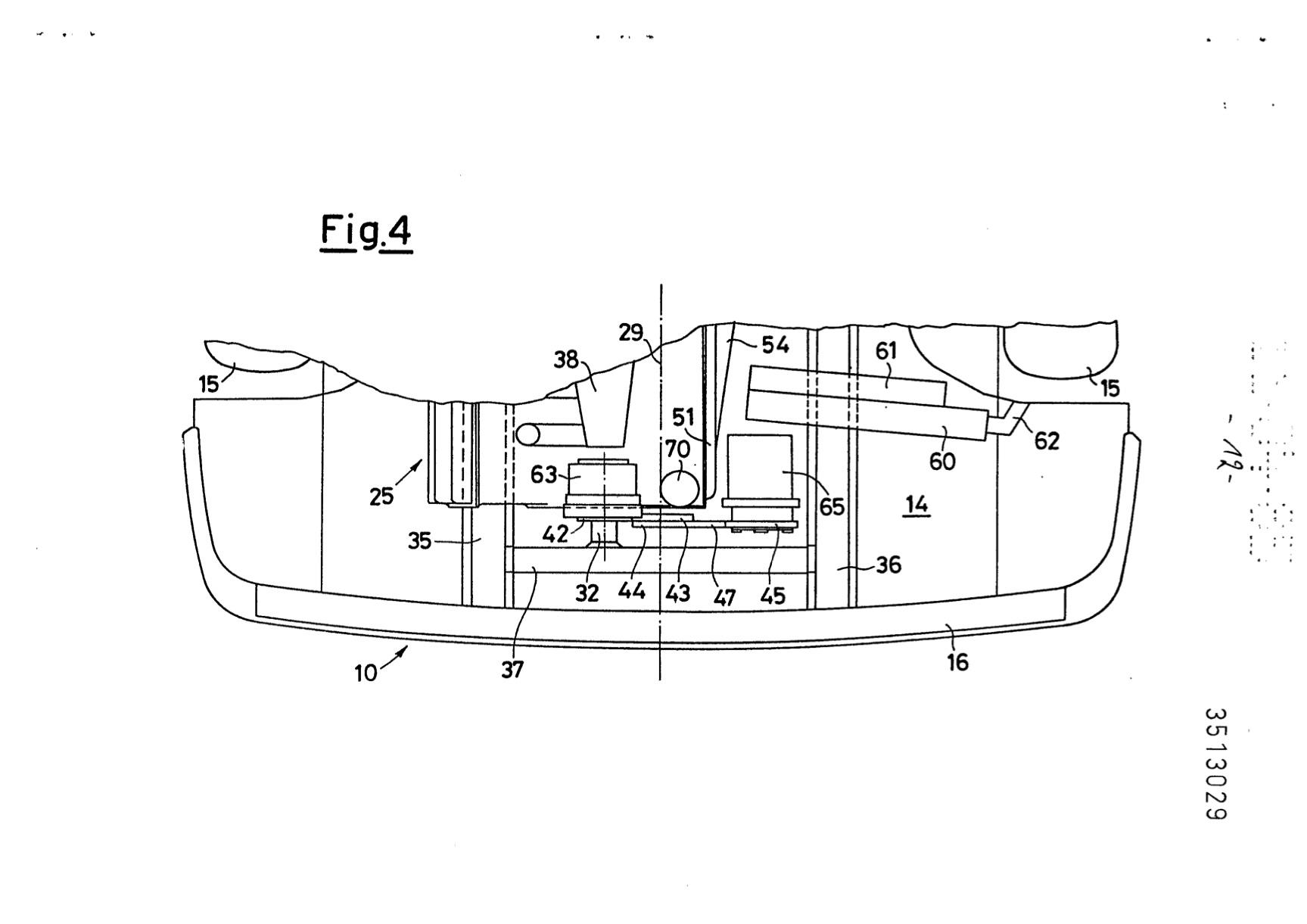

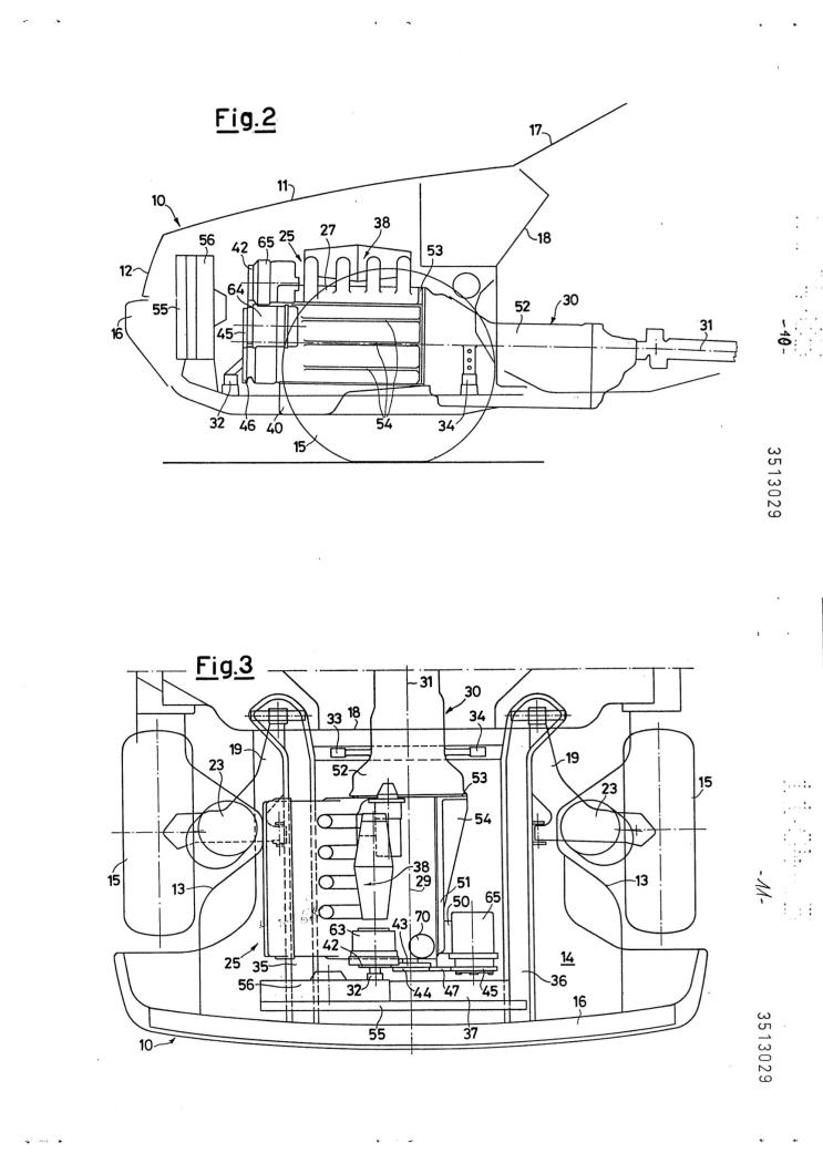

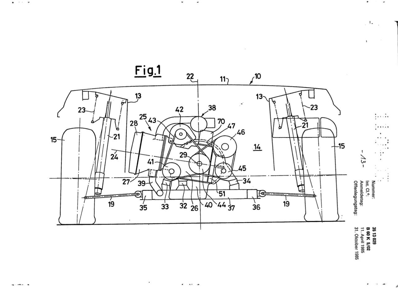

Images from italian patent application submitted by Alfa and approved 04/1984, then re-submitted in Germany 04/1985 and approved 10/1985.
Looks like a packaging layout of aforementioned 433/434, with highly tilted longitudinal inline engine, but with engine and gearbox noticeable shifted to the rear, so definitely with basic RWD, not FWD. Side of the engine head for me looks like a twinspark twincam. Also note front McPherson in Sud style, but with L-shaped lower arms, 164 alike.

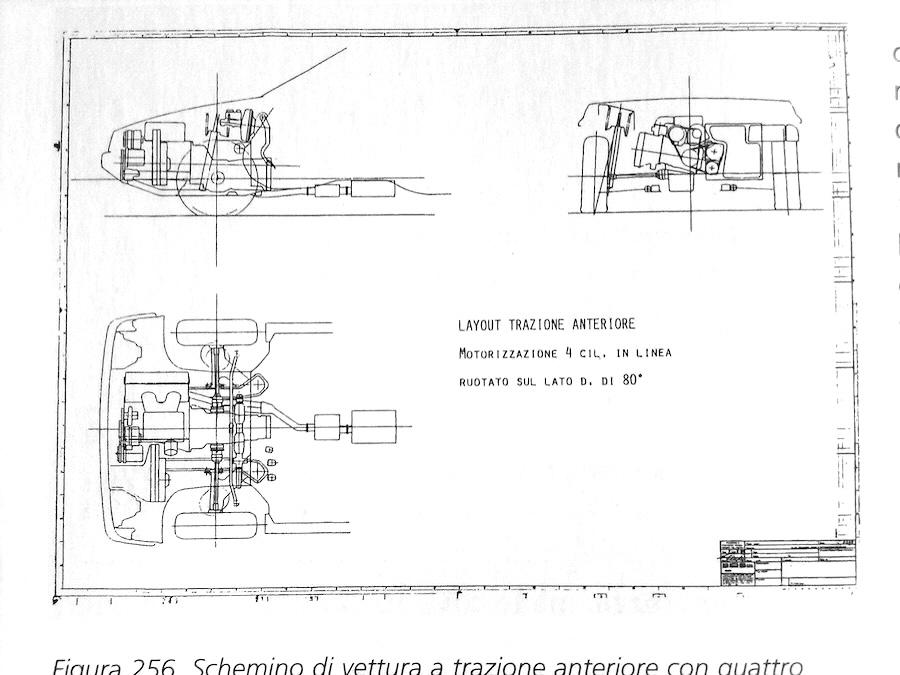

For the reference, 433/434 with highly tilted longitudinal inline engine, the latter and gearbox shifted to the front, to implement basic FWD and optional AWD.
Modificato da Touring
ma un'inclinazione laterale di 80 gradi non crea problemi con i fluidi? E con la gravità in generale, anche per tutte le parti in movimento...
18 minuti fa, v13 scrive:
Alla fine non è tanto diverso da un boxer, piuttosto mi preoccuperebbe la distribuzione laterale dei pesi
