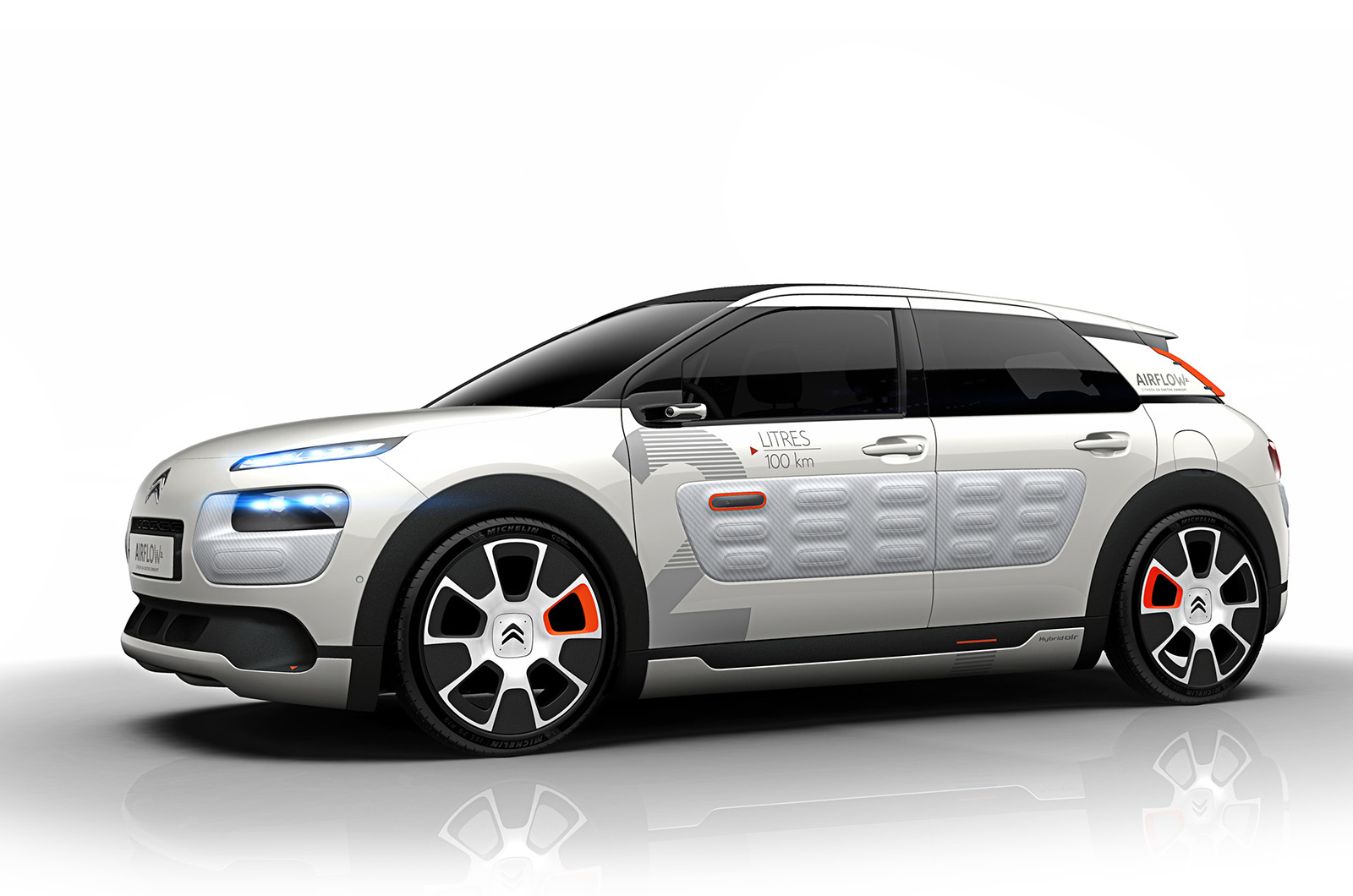

C4 CACTUS AIRFLOW 2L CONCEPT: JUST 2 LITRES/100 KM (OVER 141 MPG)
  • Citroën C4 Cactus AIRFLOW 2L concept to be unveiled at the Paris Motor Show
  • Concept achieves fuel economy of over 141mpg (2l/100km)
  • Optimised design on C4 Cactus AIRFLOW 2L results in 20% improvement in aerodynamics
  • PureTech 82 engine with Hybrid Air technology reduces fuel consumption by 30%
  • Lightweight, high-performance materials used, including carbon fibre, aluminium, high-yield steels, composite materials & translucent polycarbonate
  • Concept is 100kg lighter than production Citroën C4 Cactus

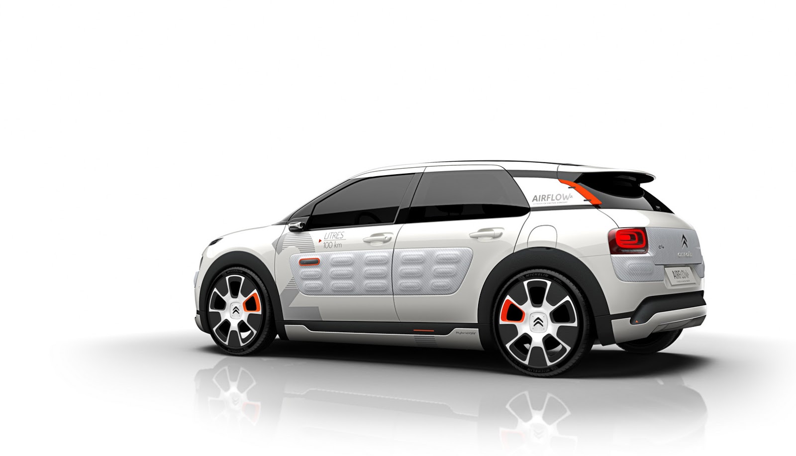

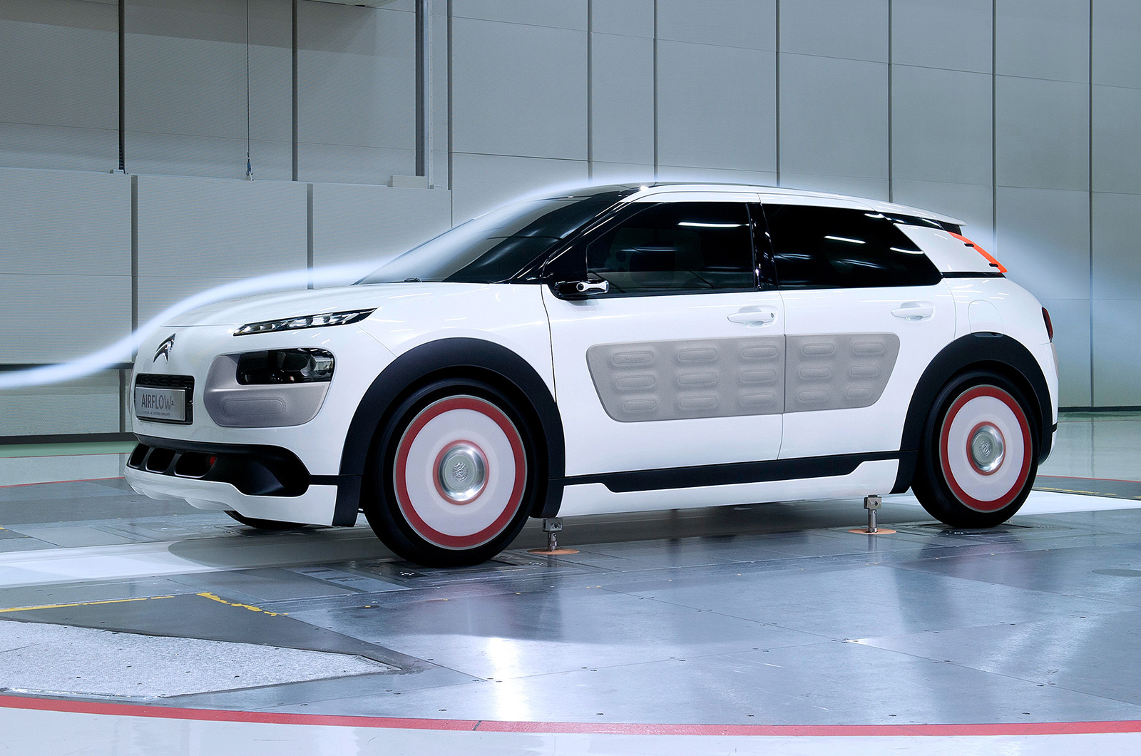

1. A body optimised for aerodynamic performance
On the C4 Cactus AIRFLOW 2L, some styling features have been modified and others created in order to optimise vehicle aerodynamics.
Variable-geometry components:

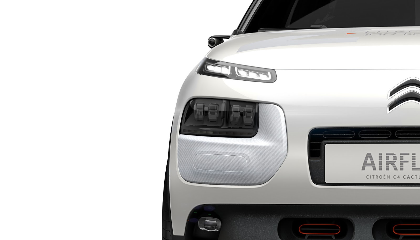

The new front bumper features three air intakes that continuously adjust in accordance with vehicle use, both for engine cooling and to regulate air flow
Mobile side deflectors have been added to effectively guide the air flow around the vehicle
The wheels feature mobile shutters activated and controlled by centrifugal force
Fixed-geometry components:
New generation 19-inch “ultra ultra” low rolling resistance “tall & narrow” tyres. Their design improves both energy efficiency and aerodynamics. The large diameter also means they are better able to soak up bumps and dips in the road surface

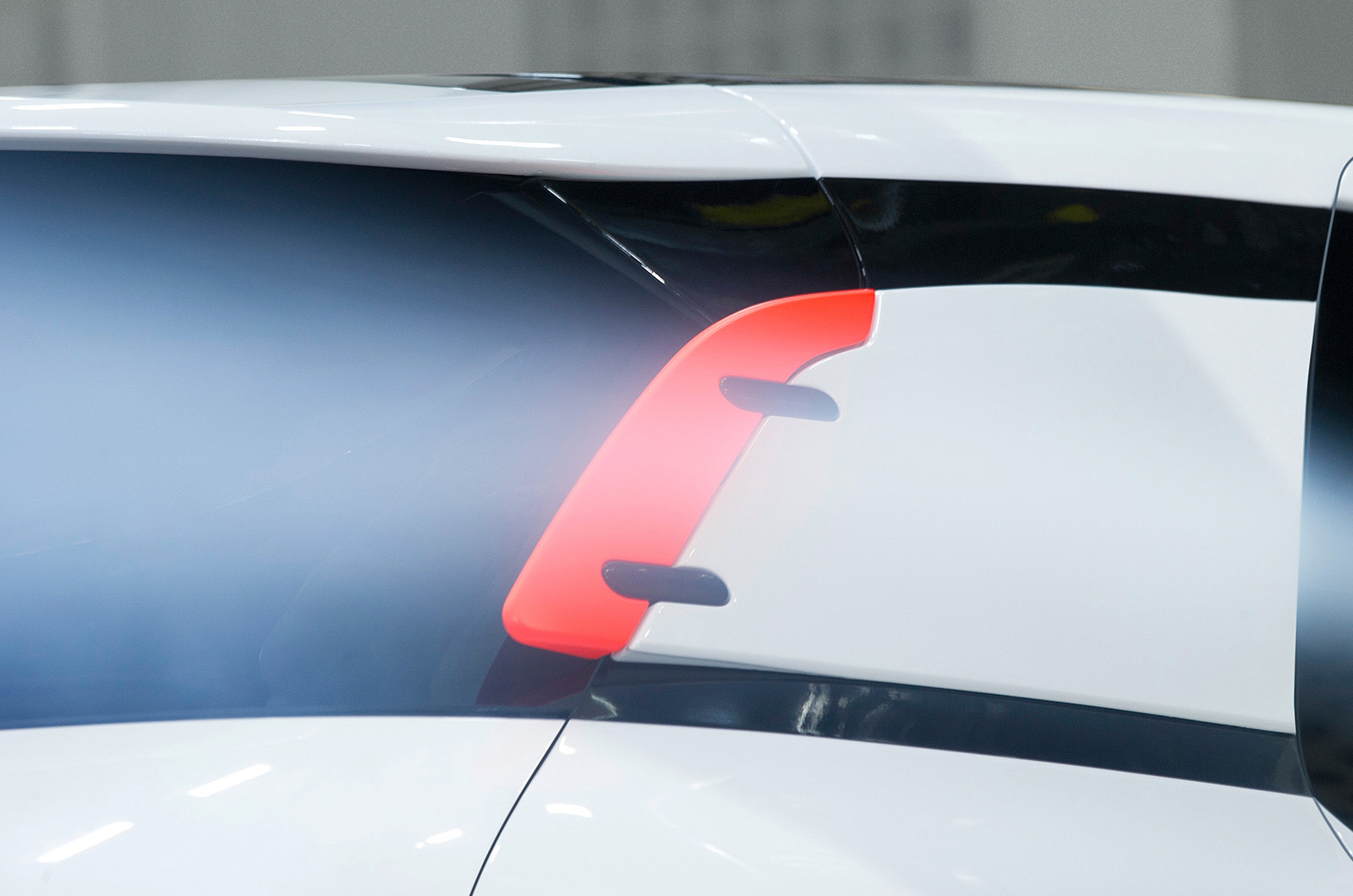

The wheel arches feature an “Air Curtain”. This is achieved with small aerodynamic slats on either end of the front bumper to channel the air along the wheels

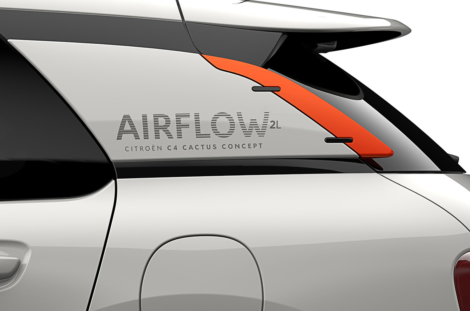

The spoiler has been lengthened and an air extractor has been added on the rear bumper in order to reduce the turbulence that can increase drag
The conventional door mirrors have been replaced by smaller, slimmer rearview cameras to reduce the impact on air flow
The vehicle sub-structure has been entirely streamlined so the air flows smoothly underneath the car
LED light modules at the front and rear replace the existing lights. Consuming little power, these new modules save energy and benefit fuel economy
The changes can be identified by the colour of the components and by the materials used. The colour orange identifies all the aerodynamic features and underlines the high-tech character of the C4 Cactus AIRFLOW 2L concept.
The changes reflect how styling and design can contribute to vehicle aerodynamics, reducing vehicle drag for an overall improvement of 20% in terms of aerodynamic performance compared with the production model.

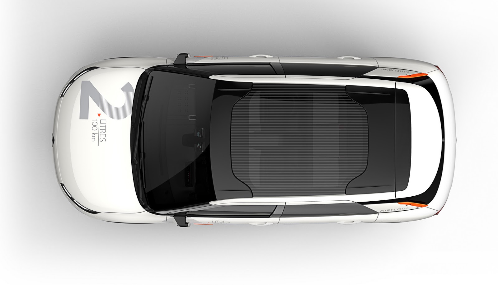

2. Innovative materials for lighter weight
The production C4 Cactus is already 200kg lighter than the Citroën C4 hatchback, yet the C4 Cactus AIRFLOW 2L concept shaves off a further 100kg. This means Citroën’s designers have reduced the weight of the concept by 11% compared with the production vehicle.
To achieve this, the brand has reduced the weight of many structural components, with the body sub-structure featuring new materials:
Aluminium, for the upper cowl panel, inner side members and rear floor pan
High-yield steels, for the front side rails and heel board
Composite materials for the front of the vehicle floor
These new materials are structural and help to soak up energy in the event of an impact. They also meet the highest standards in terms of mechanical strength.
This multi-material sub-structure made it necessary to develop special assembly techniques never used before in the automotive industry. Composite structural parts are a promising development area and will be essential to make cars lighter in the future. The large-scale production of these parts is one of the high-tech, industrial challenges to be addressed by the automotive sector.
Looking beyond the structural components, extensive studies were conducted on all vehicle parts to reduce weight.
Emphasis was placed on lightweight, high-performance materials:
Carbon-based composite materials have been used for the suspension springs, tailgate, rear bench, side panels, roof, roof cross-members, wings and doors. On the lower side sill, wheel arches and the lower part of the front bumper, the “textured” look of the carbon brings out the matt appearance of these parts, providing an attractive contrast with the pearlescent appearance of the surrounding features
Aluminium is used for the engine cradle. The bonnet specification is the same as for the production C4 Cactus, which already uses aluminium
Owing to their significantly lower bulk and density (around 2,700kg/m3 for aluminium and around 1,200 kg/m3 for carbon, compared with 7,800kg/m3 for steel), these materials contribute significantly to reducing overall vehicle weight
Given that every gram is important, Citroën also decided to use:
New processes to reduce the thickness of the tubes and cups in the exhaust system
Translucent polycarbonate, for the panoramic sunroof. This material is even lighter than multi-layer glass, but has the same properties in terms of thermal and acoustic insulation and ultra-violet filtering capability
Carbon fibre on the Airbump® panels to make the material lighter, while maintaining its technical properties

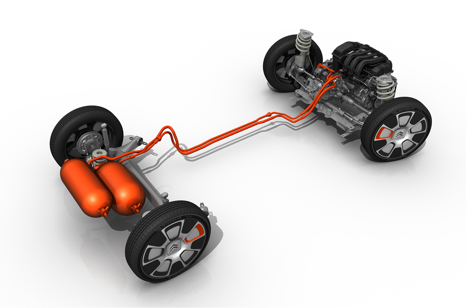

Hybrid Air technology for breakthrough fuel consumption
With the brand’s latest-generation Euro 6 engines, the production C4 Cactus already ranks among the best in its segment with CO2 emissions from 82g/km and fuel consumption starting at just 91.1mpg.
The C4 Cactus AIRFLOW 2L concept goes even further by adopting the Hybrid Air drivetrain. Presented by the PSA Peugeot Citroën Group in January 2013, and featured on a Citroën C3 at the 2013 Geneva Motor Show, this technology combines a range of proven sub-systems and technologies. This includes a 3-cylinder PureTech petrol engine, a compressed air energy storage unit, a hydraulic pump/motor unit and an automatic transmission with an epicyclic gear train. An intelligent electronic management system manages input from the driver to optimise energy efficiency.
Three operating modes are available:
Air power (zero emissions) where the compressed air motor takes over from the petrol engine
Petrol power, using only the combustion engine
Combined power, drawing upon both the combustion engine and the compressed air
On the C4 Cactus AIRFLOW 2L concept, the two compressed air storage tanks are made of composite materials and are positioned at the rear of the vehicle.

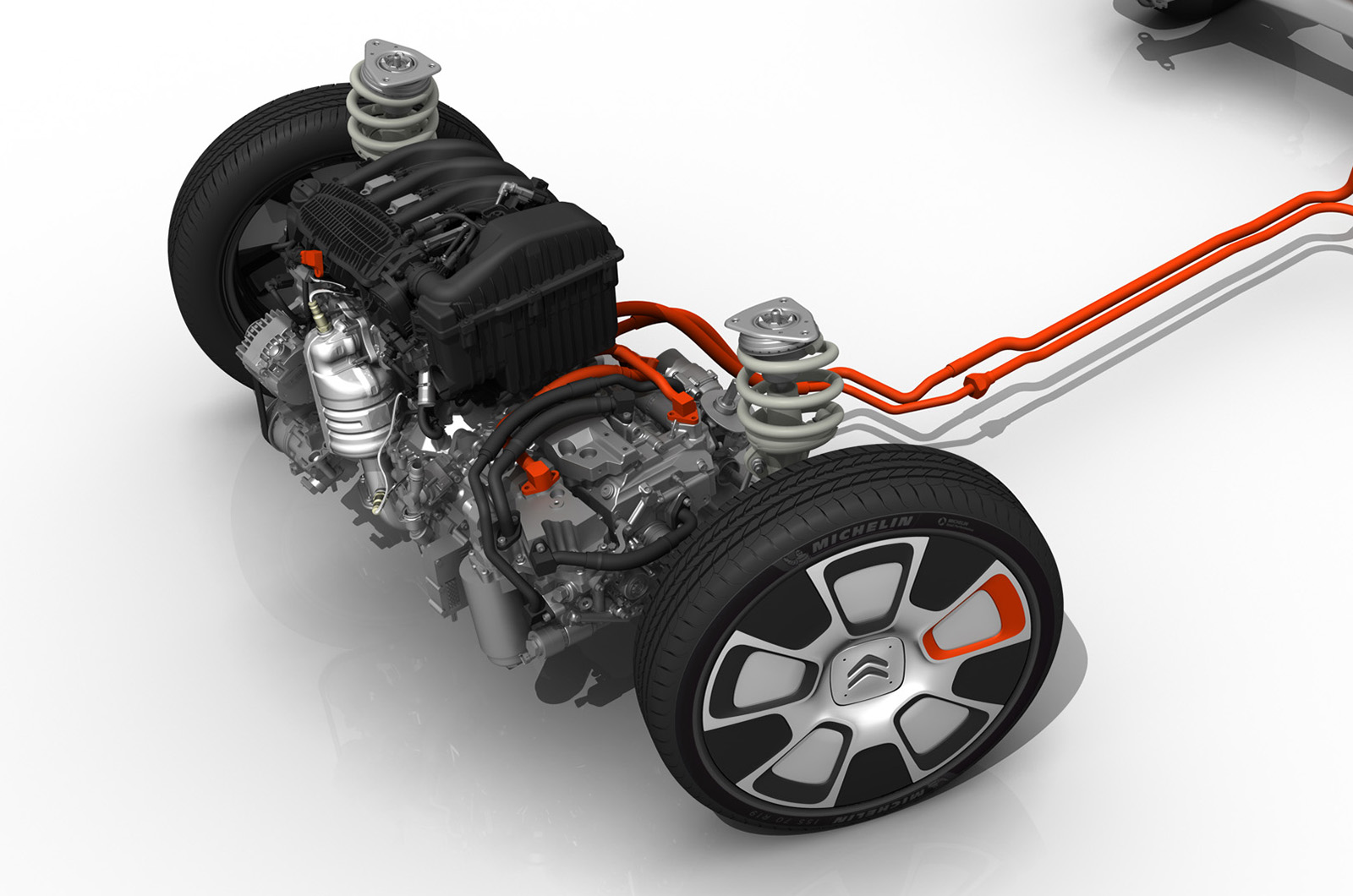

The PureTech 82 engine, already available on the production model, has been optimised for this new hybrid drivetrain. Friction losses, which account for 20% of the power consumed by the engine, have been reduced in several ways. This includes using a Diamond-like carbon coating, making moving parts lighter and using bearings to guide rotating parts. Further improvements were made by adopting new polymer pads and using very low viscosity oil. Combined with efforts to optimise combustion, overall engine efficiency has been improved by 5%.
Combining the PureTech 82 engine with Hybrid Air technology for this concept reduces fuel consumption by 30% and contributes significantly to achieving a vehicle capable of 2l/100 km, while approaching the PureTech 110 in terms of dynamic performance.
C4 Cactus AIRFLOW 2L concept, just 2l/100 km
All these advanced technologies together deliver consumption of 2l/100 km. It could therefore be possible, in the medium term, for a production vehicle such as C4 Cactus to reach this target.

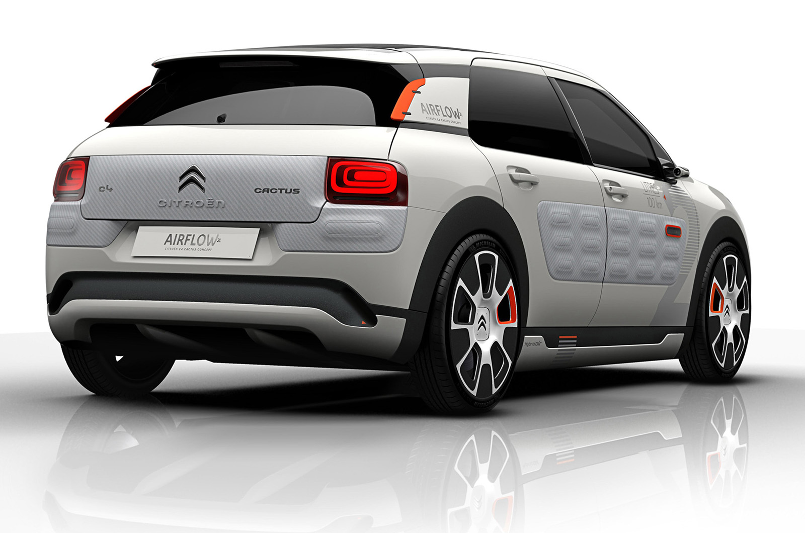

TECHNICAL CHARACTERISTICS:
Unladen weight: 865kg
Length: 4,156mm
Width: 1,729mm
Height: 1,487mm (to be confirmed)
CdA: improvement around 20%
Hybrid Air drivetrain mated to the PureTech 82 S&S engine
Tyres: Michelin 155/70/R19

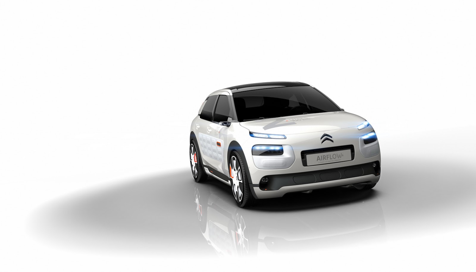

Non sono particolarmente fan delle modifiche estetiche apportatevi; non penso le donino particolarmente appesantendola visivamente.

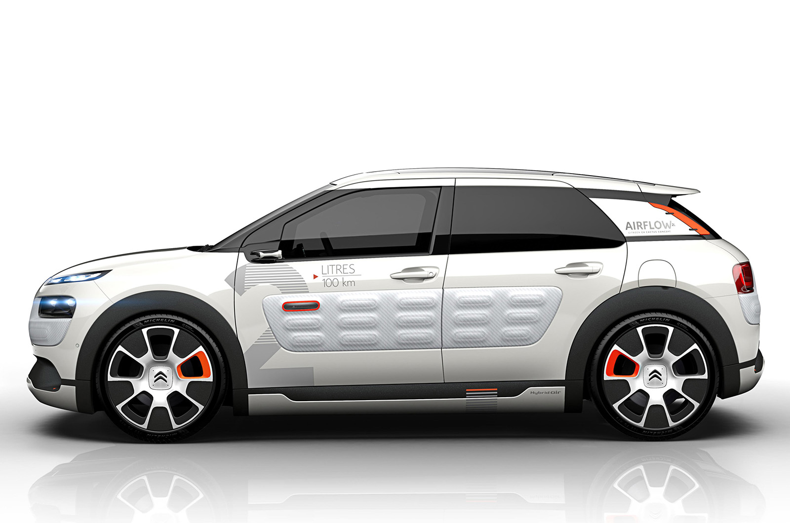

Qualche dettaglio su questa Airflow 2L direttamente da quattroruote:
  • riduzione del Cx pari al 20% rispetto a C4 Cactus;
  • pneumatici 155/70 con cerchioni da 19'' aventi fori che si aprono soltanto durante la frenata;
  • Air Curtain, cioè i deflettori presenti nel montante C;
  • peso ridotto a 865 kg (circa 100 kg in meno rispetto alla versione di serie), grazie all'utilizzo di acciai altoresistenziali, alluminio e materiali compositi;
  • propulsore motore/pompa idraulica Hybrid Air 1.2 PureTech da 82 CV + due serbatoi di azoto;
  • trasmissione epicicloidale.

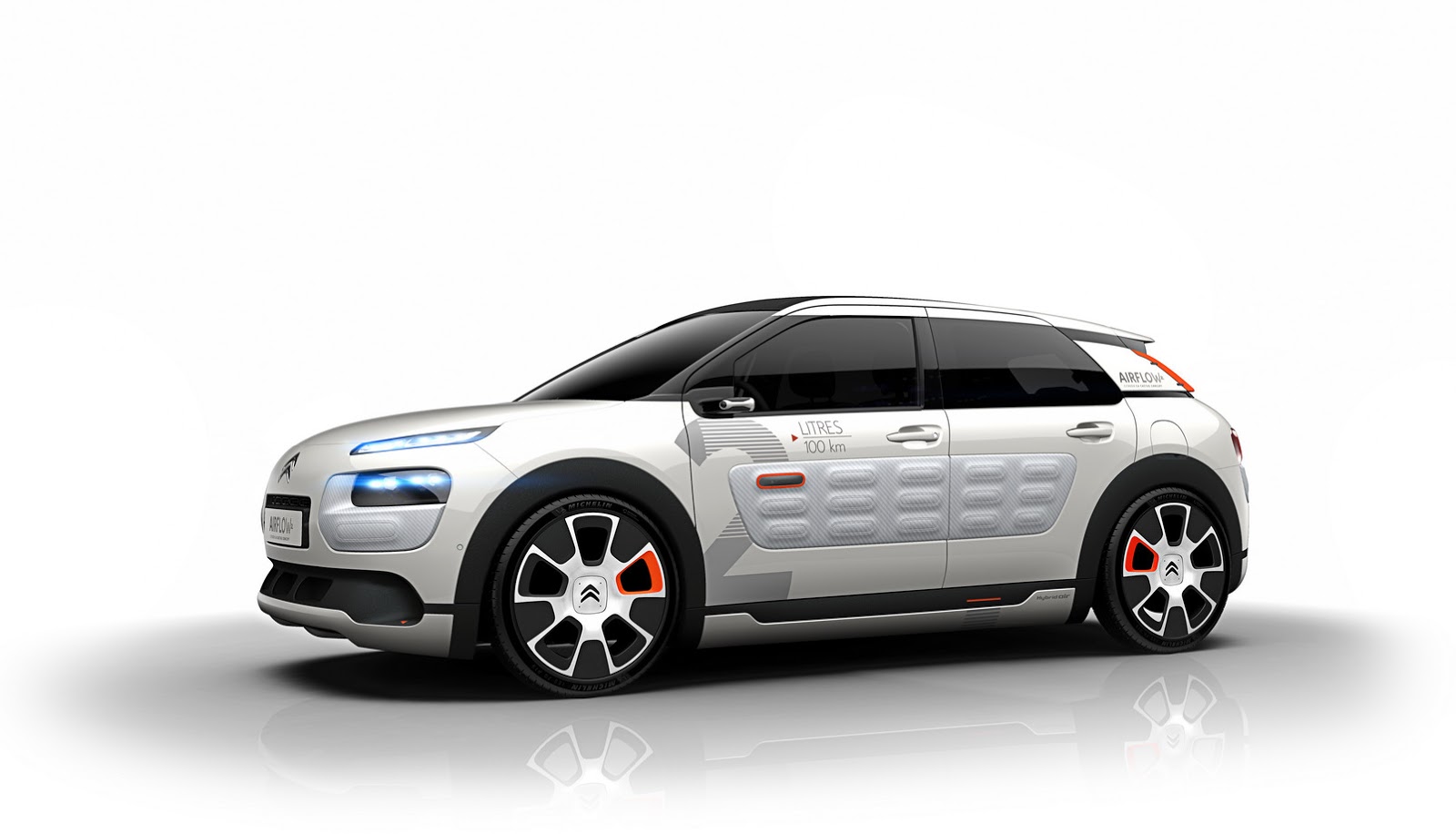

Qualcuno sa spiegarmi cosa siano quelle specie di pulsantoni sulle portiere?? :pz
Sono disponibili anche su C4 Cactus di serie; qui la descrizione direttamente dal minisito
Gli Airbump® sono la perfetta combinazione di stile e funzionalità. Esclusiva mondiale, questo sottile rivestimento in materiale plastico protegge il veicolo dai piccoli urti tipici della guida in città, donando al contempo grande personalità allo stile di CITROËN C4 CACTUS.
Il loro segreto? Una moltitudine di capsule d'aria coperte da un morbido rivestimento in TPU (poliuretano termoplastico) con un trattamento "soft" attutiscono gli urti, offrendo al contempo una migliore resistenza ai graffi. Non richiedono manutenzione particolare, contribuendo alla riduzione dei costi di utilizzo del veicolo.
