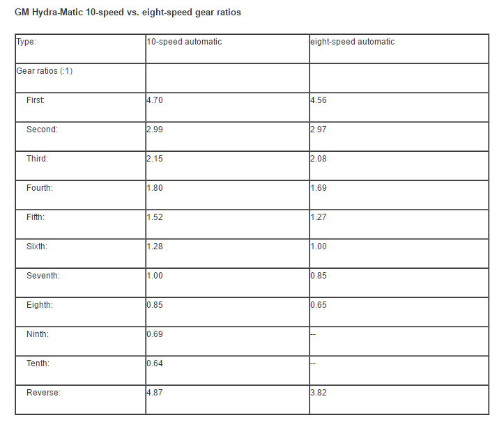

The 10-speed is an all-new design – and the first-ever application in a car – with a wider, 7.39 overall gear ratio spread, that enables the ZL1’s supercharged engine to remain at optimal engine speeds during upshifts.

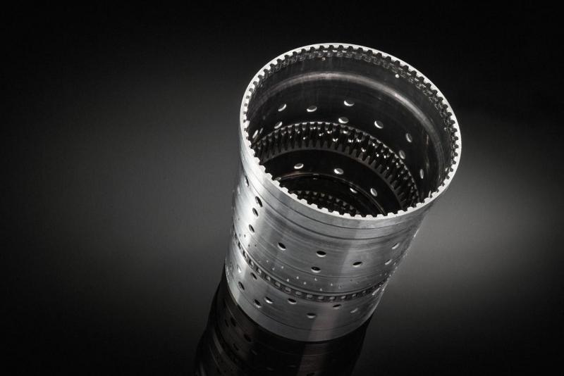

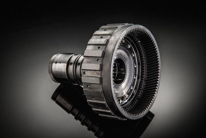

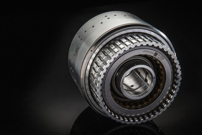

The 10-speed has four simple gearsets and six clutches: two brake clutches and four rotating clutches. That’s only one more clutch than the eight-speed, despite having two more forward gears, contributing further to the compact packaging, while also improving spin losses to enhance fuel efficiency.
A unique triple-clutch assembly in the middle of the 10-speed’s architecture is a primary enabler for packaging 10-speed content in the same space as GM’s six- and eight-speed transmissions.

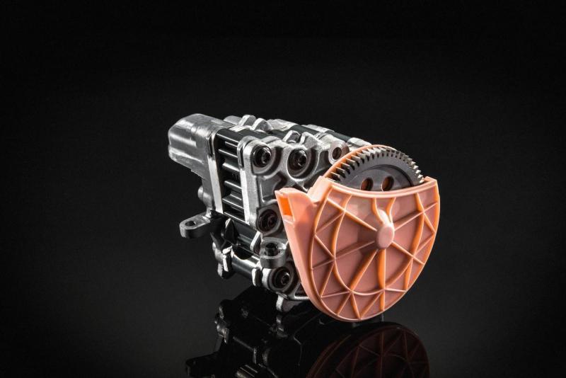

The 10-speed also features a variable-displacement vane pump, which optimizes transmission fluid pressure, based on speed and load, to enhance efficiency.

The new 10-speed’s greater overall performance and efficiency are due primarily to its wider 7.39 overall gear ratio spread, which enhances off-the-line performance with a more aggressive first gear ratio than GM’s eight-speed automatic. Smaller steps between the gears also help the engine maintain the optimal speed for maximum power at almost all speeds, especially when exiting a corner on a track.

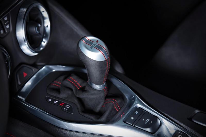

Adaptive shift controls such as Performance Algorithm Shifting and Driver Shift Control enhance performance driving. Performance Algorithm Shifting (PAS) monitors how assertively the driver is using engine output to determine at what engine speed to upshift or downshift. Driver Shift Control allows the driver to shift the transmission via the steering wheel-mounted paddle shifters. Electronic safeguards prevent over-revving if the wrong gear position is selected, but relies on the driver to make upshifts or downshifts.

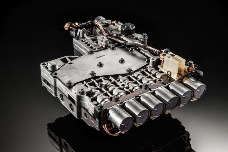

World-class shift time quickness and responsiveness are accomplished by leveraging the base transmission hardware in concert with GM exclusively developed algorithms, software and calibrations. An externally mounted electronic control module executes millions of controls instructions every second.
