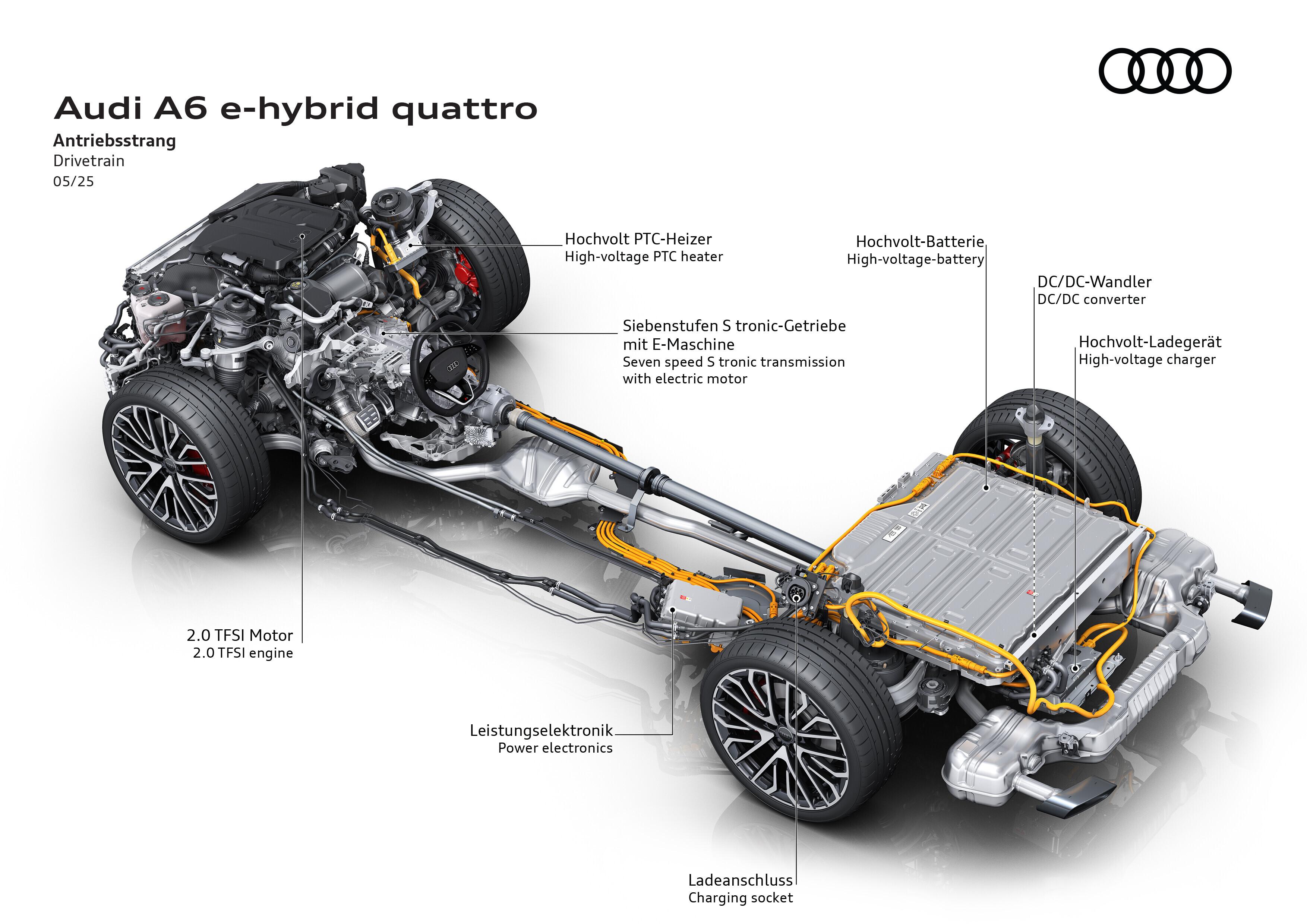

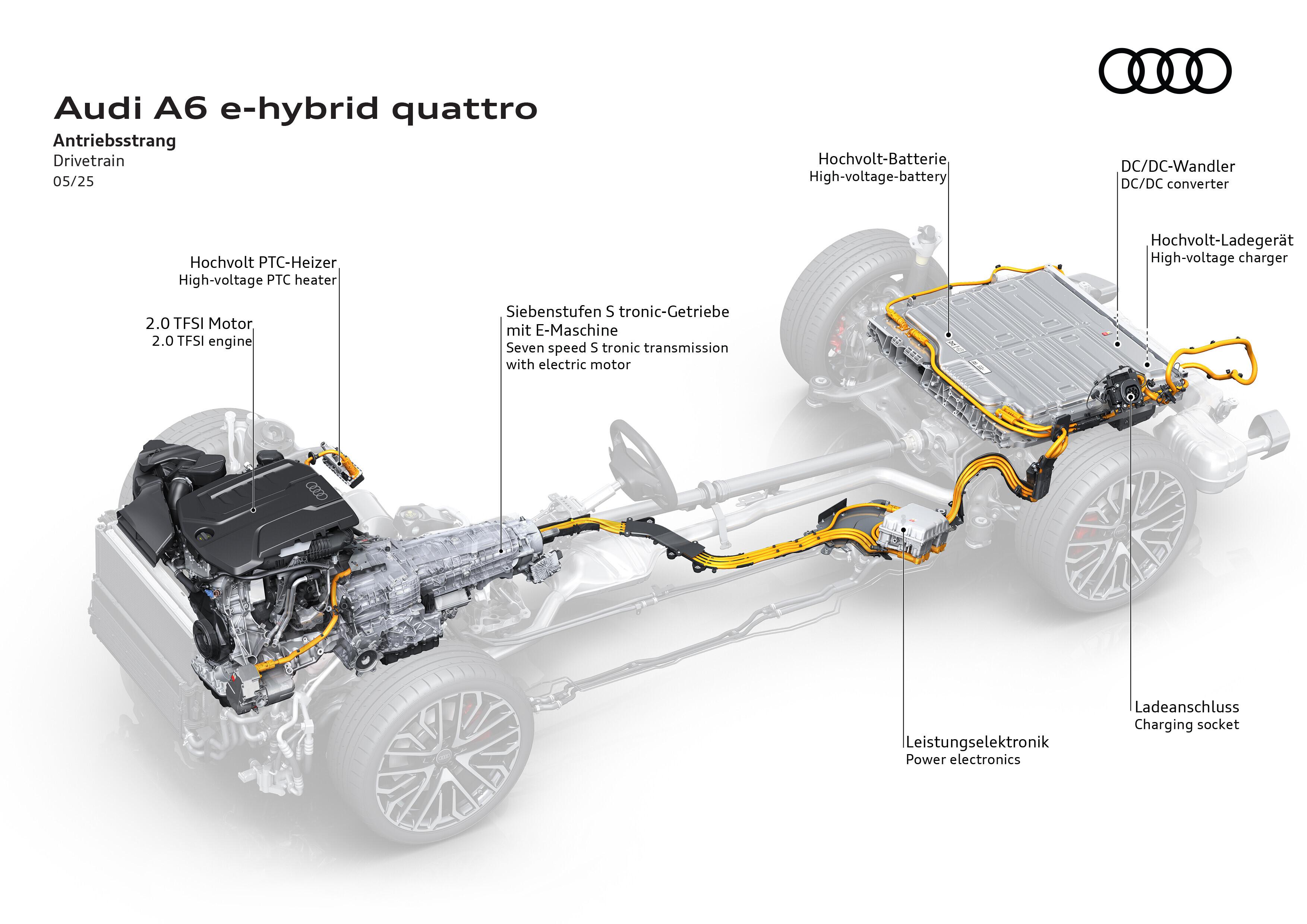

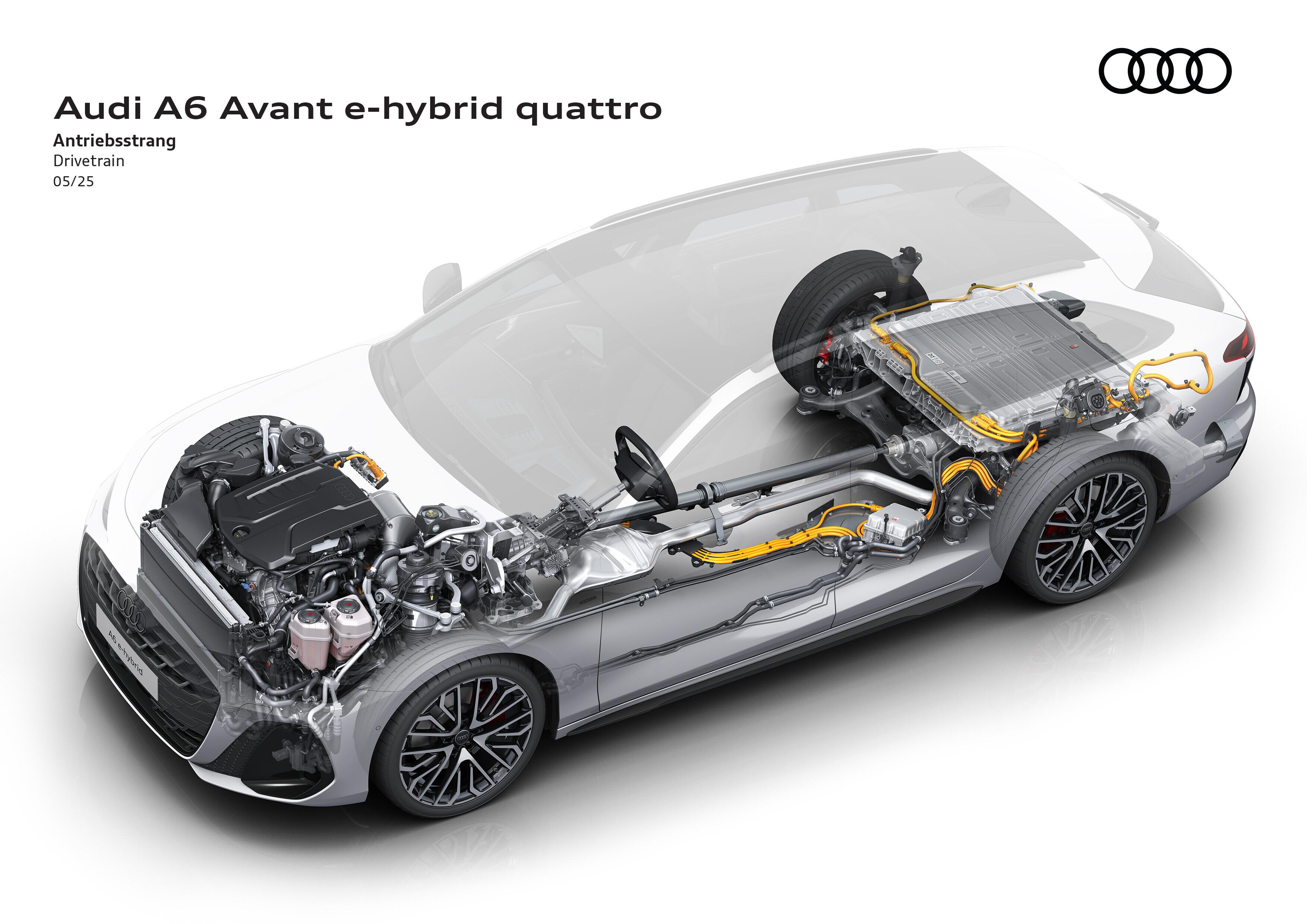

Sporty meets efficiency: the new A6 plug-in hybrid models
  • Avant and Sedan as e-hybrid quattro, each available in two power levels with up to 106 kilometers of electric range
  • Increased efficiency and performance thanks to high-voltage battery with more capacity, smart recuperation strategy, and intelligent hybrid management
  • All-wheel steering as standard; top-of-the-line model with 270 kW system output comes with sports suspension, S line equipment, 19-inch wheels, and red brake calipers
Audi is expanding the portfolio of the new Audi A6 with two plug-in hybrid models that combine maximum efficiency and superior comfort with powerful performance. Both the A6 Avant e-hybrid quattro12 and the A6 Sedan e hybrid quattro34 can be ordered in two power levels: 220 kW and 270 kW system output. The new generation of high-voltage battery in the plug-in hybrids has around 45 percent more capacity than its predecessor. As a result, 25.9 kWh (net 20.7 kWh) of power is available for electric driving.
The new plug-in hybrid models offer even more flexibility and efficiency by combining the best of electric driving with the advantages of a combustion engine. Customers can choose between the Avant and the Sedan, both models featuring a long wheelbase, elongated hood, and wide track – making for a powerful and distinguished appearance. While the A6 Sedan e-hybrid quattro exudes elegance thanks to the sweeping curve of the window’s upper edge, the Avant expresses a dynamic look with its more sculpted rear end, flanking aerodynamic panels, and roof edge spoiler. Both models demonstrate a strong presence thanks to the striking rear lights, wide light strip, and Audi rings positioned high up.

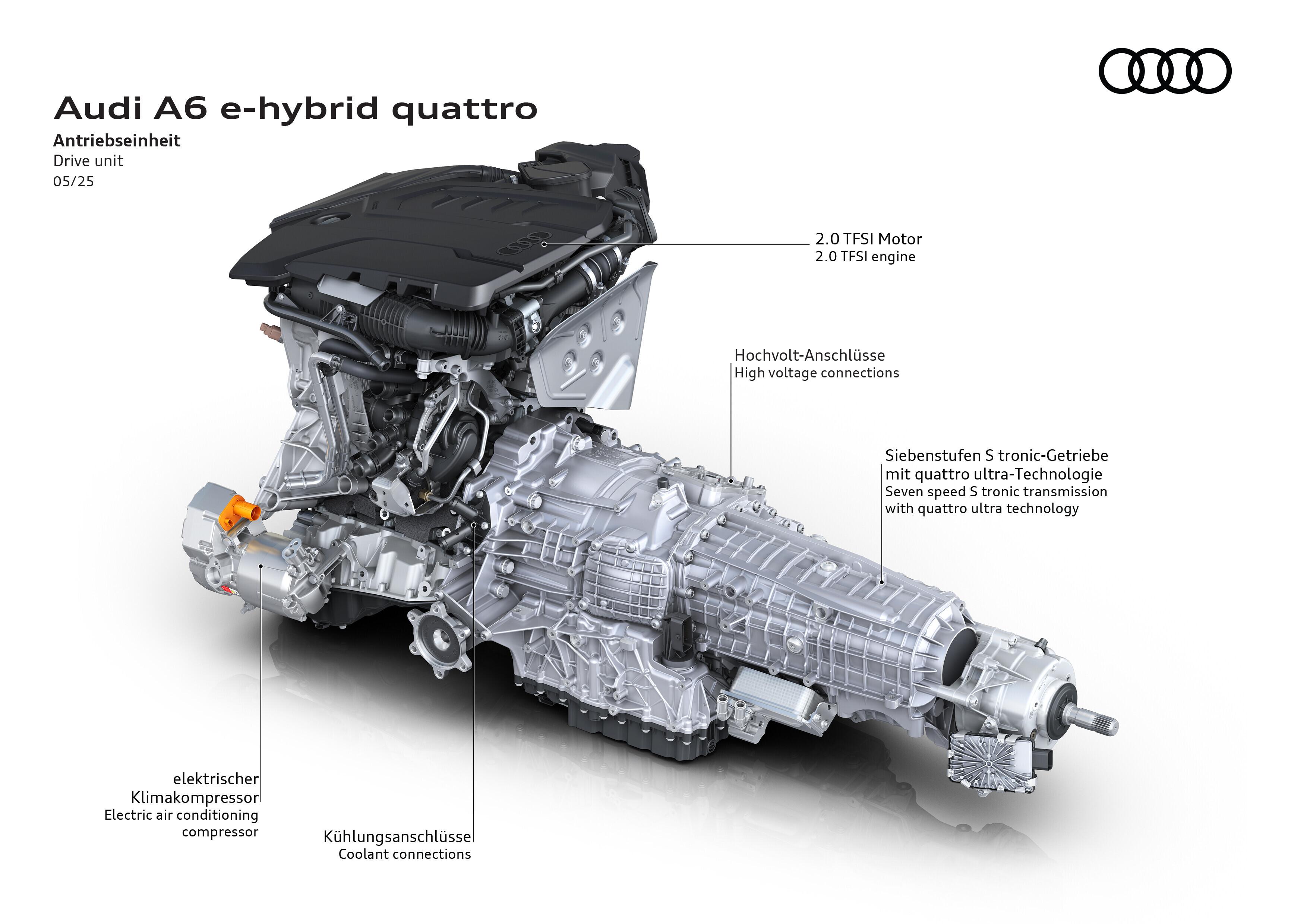

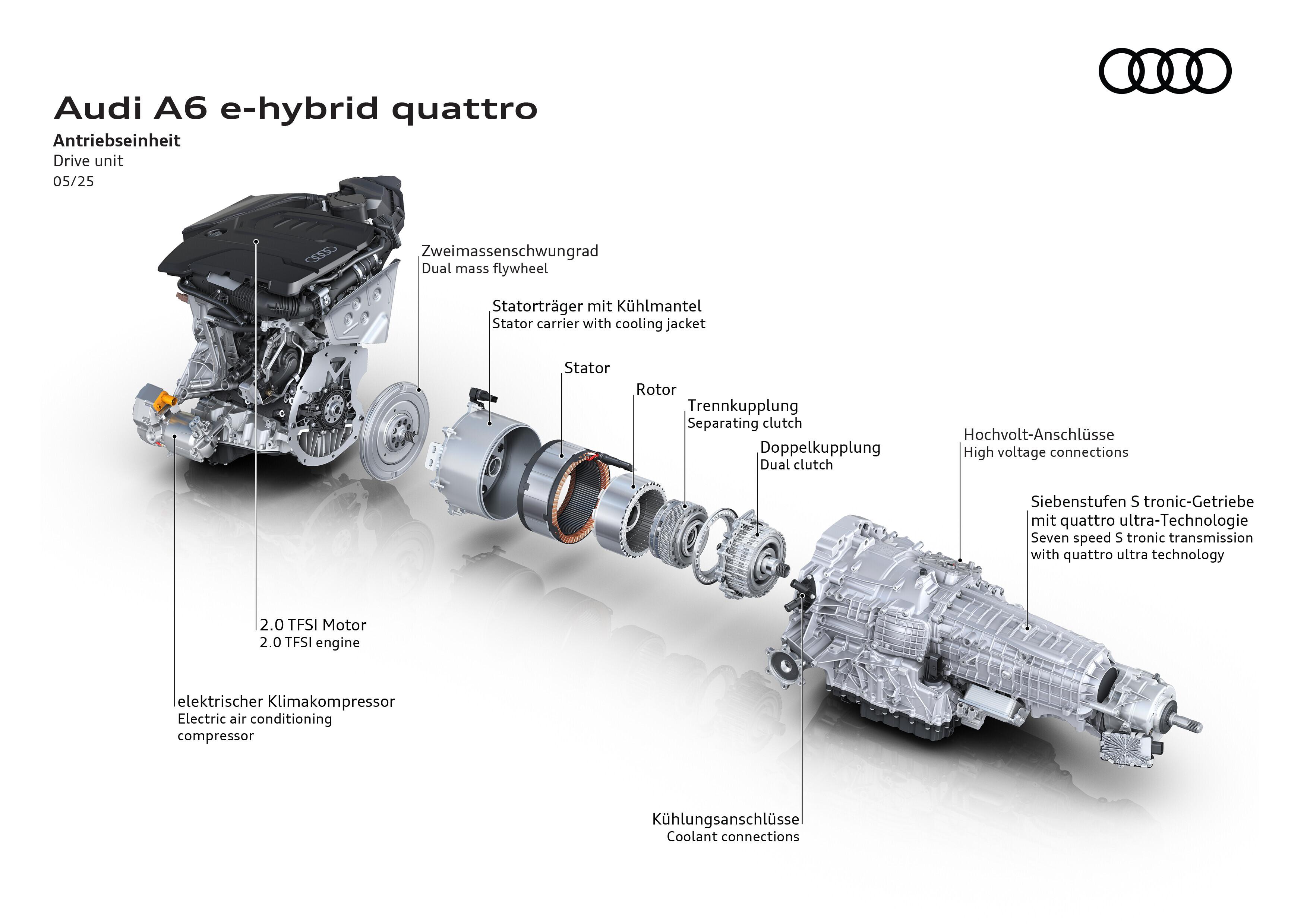

The new Audi A6 Avant e-hybrid quattro and the Audi A6 Sedan e-hybrid quattro are both available in two power levels. The vehicles are powered by a 2.0 TFSI engine with an output of 185 kW (252 PS) and an electric motor that delivers up to 105 kW. In the versions with 270 kW and 500 Nm of torque24, the Avant and Sedan can accelerate from 0 to 100 km/h in 5.3 seconds.
With 220 kW and 450 Nm of torque13, the vehicles can accelerate from 0 to 100 km/h in 6.0 seconds. All variants can reach a top speed of 250 km/h (155 mph).

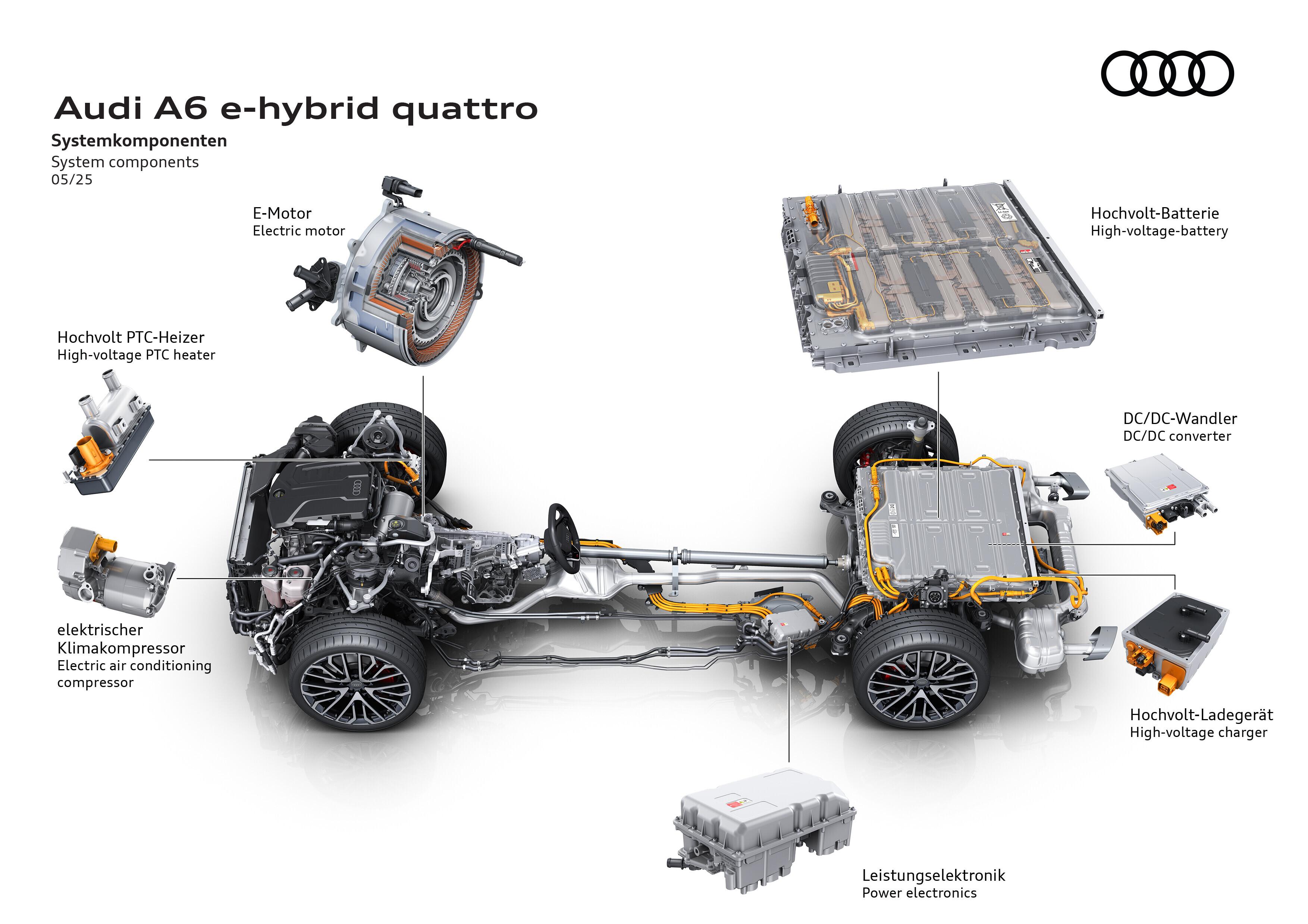

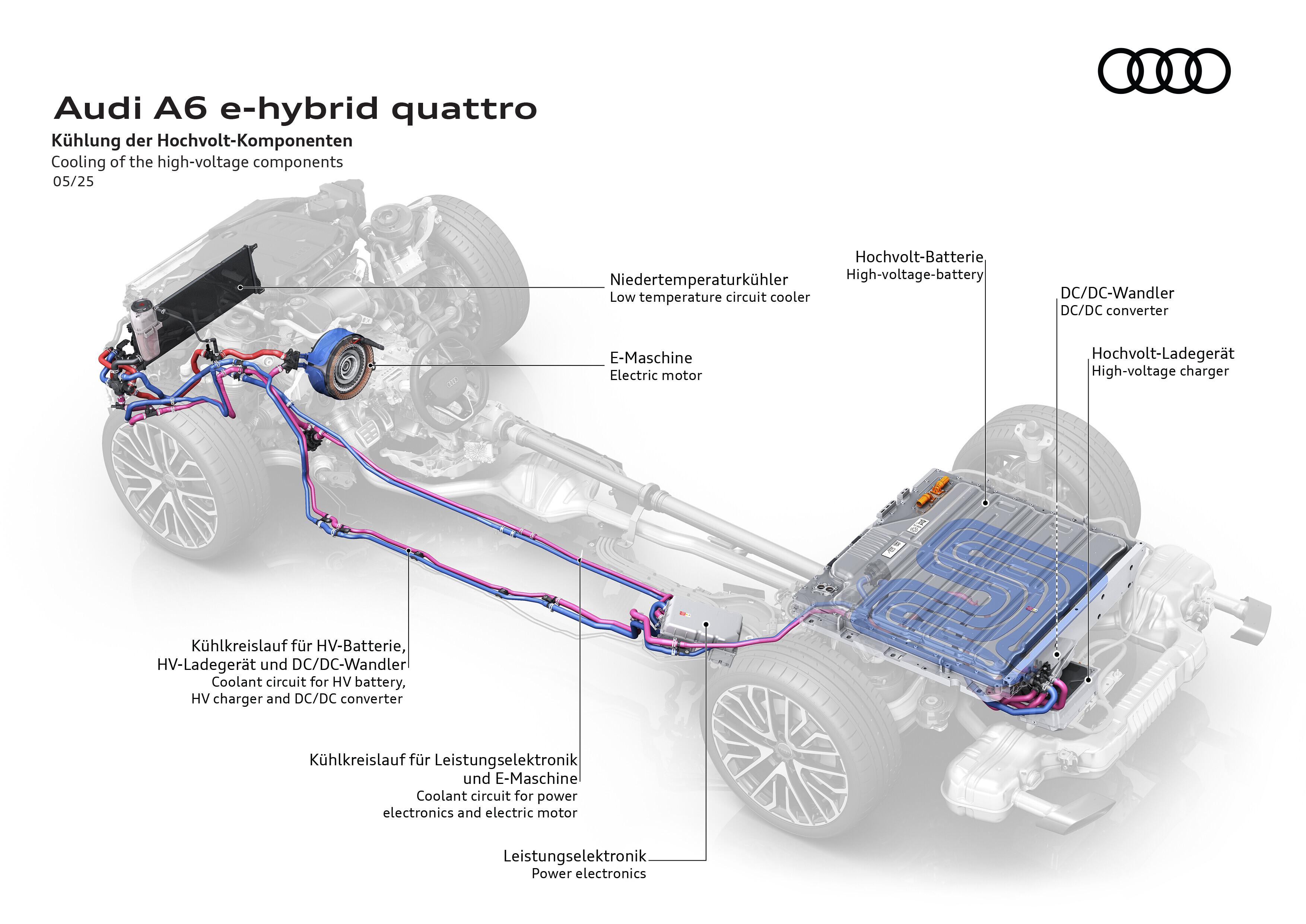

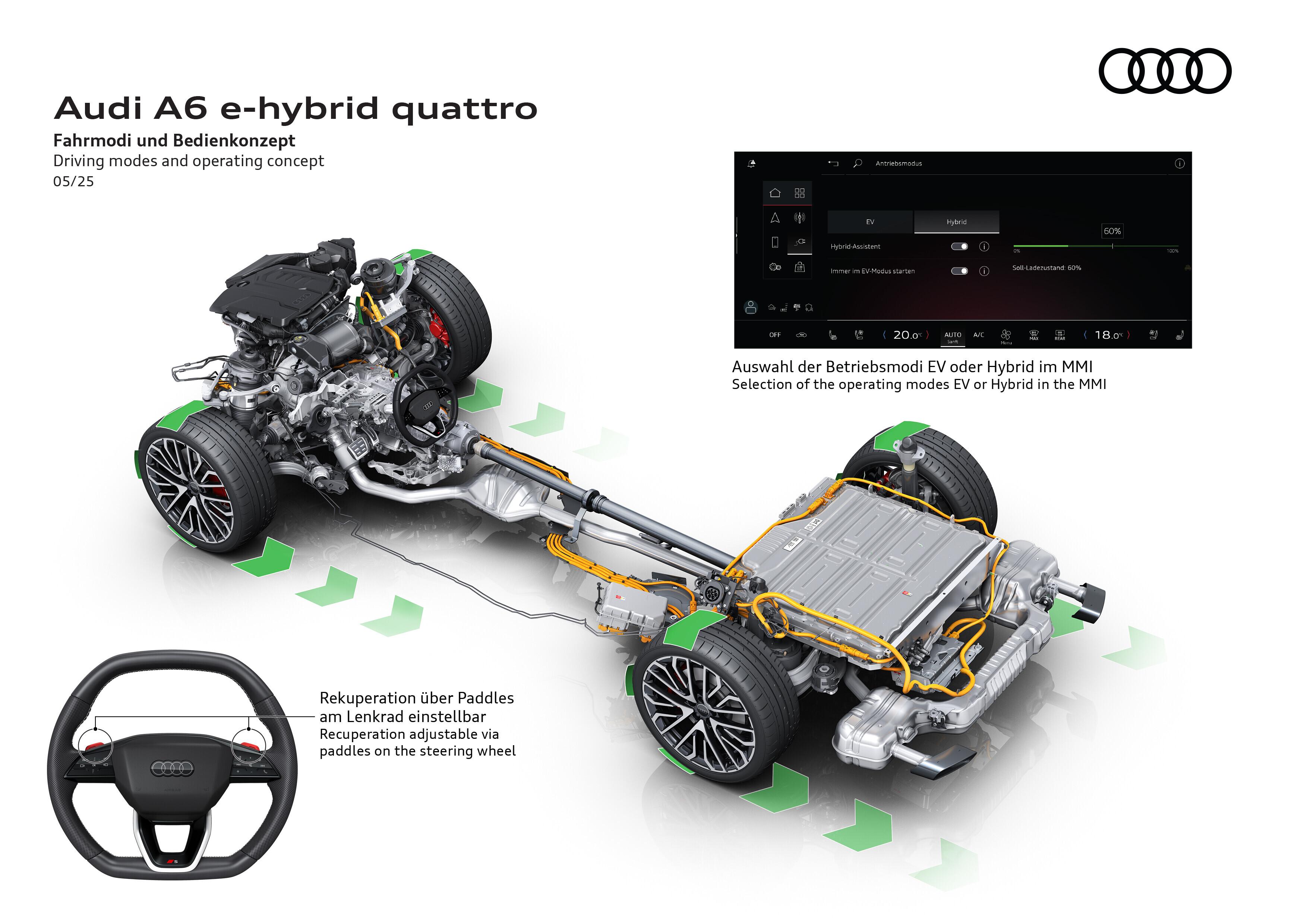

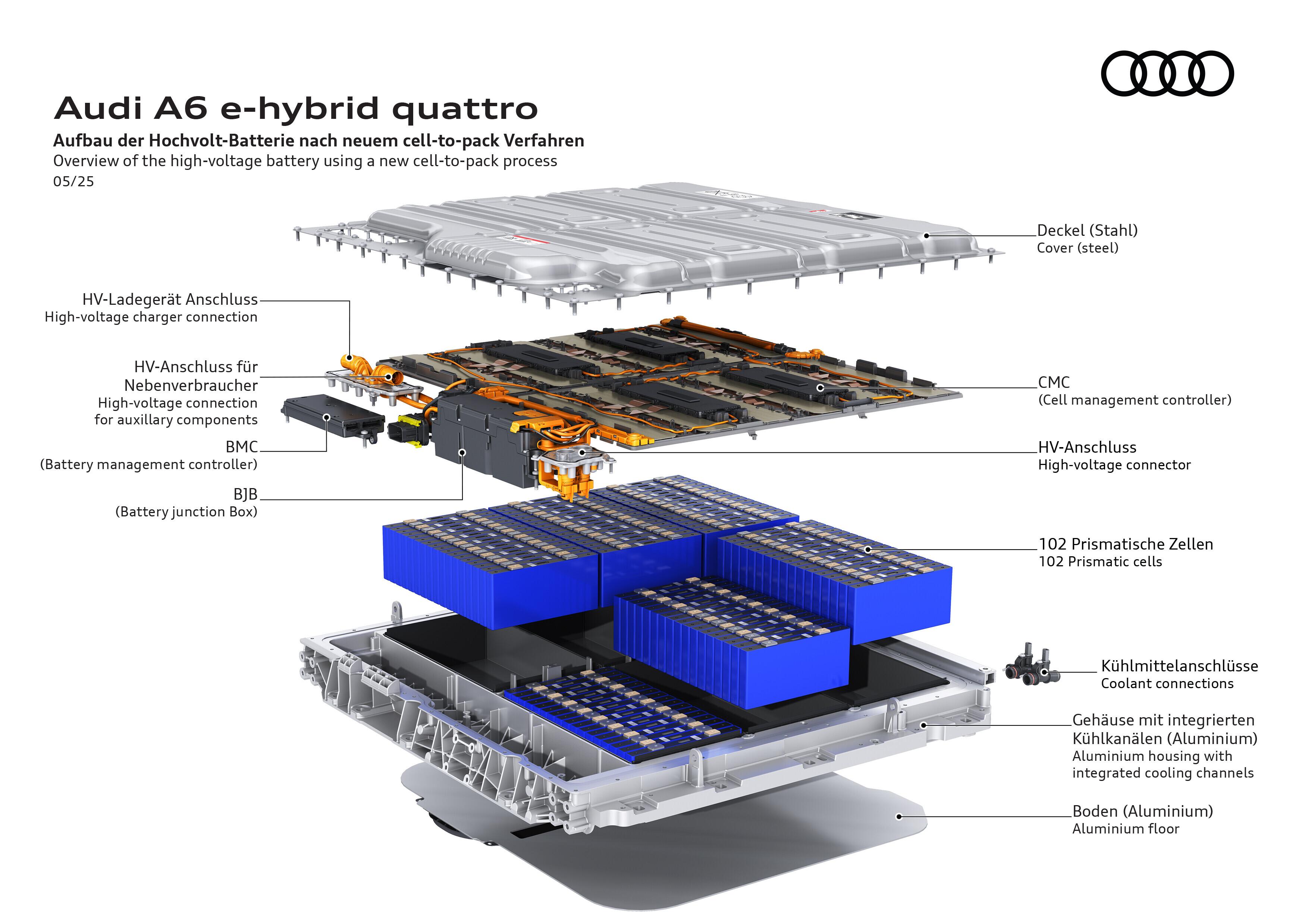

The heart of the plug-in-hybrid technology is the high-voltage battery: Audi has boosted its capacity to 25.9 kWh (net 20.7 kWh), a gain of roughly 45 percent compared to its predecessor. This means that both the Avant and the Sedan can drive more than 100 kilometers purely on electric power. Maximum AC charging power is now 11 kW. If the battery is completely empty, it only takes 2.5 hours to charge it to 100 percent.
The recuperation performance has also been improved. The degree of thrust recuperation in electric driving mode (EV ‑mode) can be adjusted to three different levels using paddles on the steering wheel. The new A6 e-hybrid runs on electric power for as long as possible to fully utilize the available battery charge to the driver’s destination. The vehicle recovers energy automatically when this function is activated. This is based on route data stored in the navigation system. The new A6 e-hybrid quattro can also recover energy automatically without active route guidance.
The hybrid management system of the new models is designed for efficiency, flexibility, and maximum customer comfort and thus automatically selects the optimal operating strategy. Two operating modes are available to the system: “EV” and “hybrid.” In EV mode, the plug-in hybrid models run on electric power. In hybrid mode, the hybrid management system maintains a specific charge level as needed in order to save enough electrical energy for later use. In addition to the automatic hybrid mode, the desired charge level can be individually selected using a digital slider.
Combined with the quattro ultra drive and standard all-wheel steering, the electrified dual-clutch transmission plays a major role in the dynamic driving experience: it increases agility at low speeds and provides even more stability at higher speeds. This enhances driving comfort, as do more tightly sealed windows and optimized door seals. These measures ensure even more pleasant in-car acoustics compared to the predecessor, as sound insulation has been improved by up to 30 percent.

The hybrid management system of the new plug-in hybrids (PHEV) automatically selects the optimum operating strategy. The electric drive is provided by a permanently excited synchronous motor with a peak output of 105 kW. The electric motor is integrated into the housing of the seven-speed S tronic.
The full system torque is available even at close to idle speed – an impressive 500 Nm with 270 kW system output24 and 450 Nm with 220 kW system output13. The power electronics (pulse inverter) used in the plug-in hybrid models of the A6 are a new development. The pulse inverter is smaller, lighter, and more efficient, thus reducing electrical consumption. Consumption in hybrid mode is therefore also lower.
Battery capacity and energy density significantly increased
Audi has boosted the capacity of the new high-voltage battery (HV battery) in the rear of the vehicles to 25.9 kWh (net 20.7 kWh), a gain of roughly 45 percent compared to its predecessor. In contrast, the required installation space has only increased slightly in view of the significantly increased capacity. The HV battery measures 962 × 996 × 177 millimeters (39.1 × 39.2 × 7.0 in). The further developed and significantly optimized interaction between the mechanical friction brake and energy recovery via the electric motor has also improved the individually adjustable regenerative braking performance.
The battery cells are arranged in a single layer due to the available space in the rear section of the car. The entire impact structure is embedded in the battery housing. Each prismatic cell stores 46 percent more energy than the cells previously used in low-floor vehicles in the C segment. Each cell has a charge capacity of 70 ampere-hours (Ah). The raw material composition of the 102 cells enables a higher energy density. The battery’s energy is bundled into six stacks, each with 17 cells. With its cell-to-pack design, Audi is pursuing a new approach to battery cell arrangement that was first used in the PHEVs of the A5 series. In this process, the cells are no longer placed in a battery module but are glued directly into the battery housing. The higher packing density that results from this means that the energy content and energy density of the HV system can be increased while taking up less space. Thanks to technical developments in cell chemistry, higher electrical output is available compared to the previous generation, even at a low state of charge and low outside temperatures.
The maximum possible AC charging power has been increased from two-phase 7.4 kW to three-phase 11 kW, depending on the respective infrastructure. With this increased power, the HV battery’s zero-to-100-percent charging time has been reduced to just 2.5 hours. A charging cable (mode 3, plug type 2) for convenient charging at home and on the road is included as standard. Audi’s own charging service, Audi charging, provides access to numerous AC‑charging points in 29 European countries on request.

Compared to its predecessors, Audi has significantly increased regenerative braking performance in the new A6 e-hybrid quattro. The phases in which the driver takes their foot off the accelerator pedal are crucial for the efficiency of the plug-in hybrid drive. In such situations, overrun recuperation is controlled by a defined deceleration depending on the selected drive level. Automatic recuperation can also be preset in the MMI in drive levels D and M. The vehicle varies the recuperation autonomously. The parameters for this are route data stored in the navigation system, such as gradients, curve radii, place-name signs, and speed limits. Another important factor is the traffic ahead. As soon as automatic regenerative braking is selected, predictive signals are fed into the overrun regenerative braking function with the help of Predictive Efficiency Assistant (PEA). The new A6 e‑hybrid quattro can also recover energy automatically without active route guidance.
When the brake pedal is pressed during deceleration, the A6 plug-in hybrid models can recover up to 88 kW of power. When operated as a generator, the electric motor accounts for more than 90 percent of all deceleration processes. The integrated brake control system with blending capability (iBRS) ensures pressure-free braking and the best possible energy recovery. The hydraulic wheel brakes are only used for harder braking maneuvers.
Recuperation level adjustable via steering-wheel paddles
Thanks to the new E3 electronics architecture used in the Premium Platform Combustion (PPC), the degree of thrust recuperation in electric driving mode (EV mode) can be adjusted to three different levels using paddles on the steering wheel, just like in the all-electric models. Electric braking and thus the recuperation level are selected using the left paddle (minus). It can be deactivated again using the right paddle (plus). The paddles can thereby be used to set a higher level of deceleration before a turn, for example. At level zero, the plug-in hybrid coasts freely without additional drag torque when the foot is taken off the accelerator pedal. This means that energy is only recovered when the brake is applied.
Intelligent operating strategy for maximum efficiency
Two operating modes are available in the new A6 PHEV models: “EV” and “hybrid.” In EV mode, the PHEV models run on electric power. The combustion engine is only turned on in the following situations: deliberately deselecting EV in the switch bar below the panoramic display or via the MMI; in driving program S; via the selected mode of the Audi drive select dynamic handling system; or when starting route guidance with hybrid assist activated. If navigation route guidance is activated, the hybrid assistant takes the route data into account when selecting the drive mode. The combustion engine also engages during kickdown, and EV mode is deactivated until the kickdown action is over. If none of these situations occur, both new PHEV models use the HV battery in EV‑mode until it is completely discharged. The digital slider used to control the desired state of charge via the MMI in hybrid mode cannot be operated in EV mode; that is because the battery charge will be fully utilized in electric mode. Speeds of up to 140 km/h are possible in EV mode. The PHEV models can be started either in EV mode or in hybrid mode. The mode used last is the default mode for when the vehicle is started next.
When driving in hybrid mode, the hybrid management system maintains a specific charge level as needed in order to save enough electrical energy for later use, for example for electric driving in the city. The A6 Sedan e-hybrid quattro can drive up to 111 km (69.0 mi) on electric power alone according to the WLTP EAER City value. When it comes to efficiency-optimized consumption, hybrid mode is most efficient for both short and long distances. Depending on the driving situation and the driver’s power needs, the operating strategy decides whether to drive in electric or hybrid mode in order to be as efficient as possible. The A6 PHEV models prefer to drive in electric mode in urban areas. At higher speeds, the proportion of hybrid driving increases. With active route guidance, the operating strategy takes the planned route into consideration; the best possible energy configuration for the desired route is automatically selected. To achieve the highest efficiency, the vehicle calculates which parts of the route are suitable for electric driving. For example, electric driving is preferable where speeds are likely to be low, such as in urban areas and traffic jams. When the hybrid assistant is activated and route guidance is on, settings such as the desired charge level will be overwritten to ensure an efficient operating strategy.
In addition to the automatic hybrid mode, the desired charge level can be individually selected using a digital slider. Drivers can use it to precisely define how high the charge level of the HV battery should be in order to drive the desired distance in electric mode. The charge level can also be set before your trip so that there will be enough energy available for electric driving at the destination if so desired, or if there is no charging option there.
The desired charge level can be set using a digital slider on a percentage scale. If the target state of charge (SoC) is lower than the current SoC, the battery will be discharged down to the target level. If the target and current values match, power will mainly come from the combustion engine – in order to maintain the current SoC. If the target SoC is higher than the current SoC, the vehicle will be powered by the combustion engine – in order to recharge the battery. The battery is charged with a view to maximizing efficiency and minimizing environmental impact. This means that the combustion engine only charges the battery at speeds above 65 kilometers per hour (40 mph); at low speeds, the charge level is simply maintained. This maximizes efficiency and enables partially electric driving in the city or in stop-and-go traffic. The HV battery can be charged in this way up to a 75-percent state of charge. This ensures that the battery is charged with maximum efficiency while driving. To increase the battery’s charge above 75 percent, an external AC charging source is required.

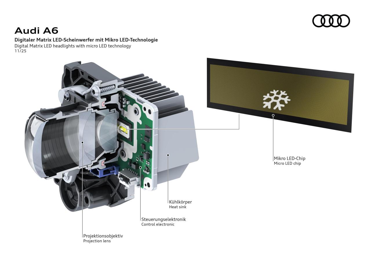

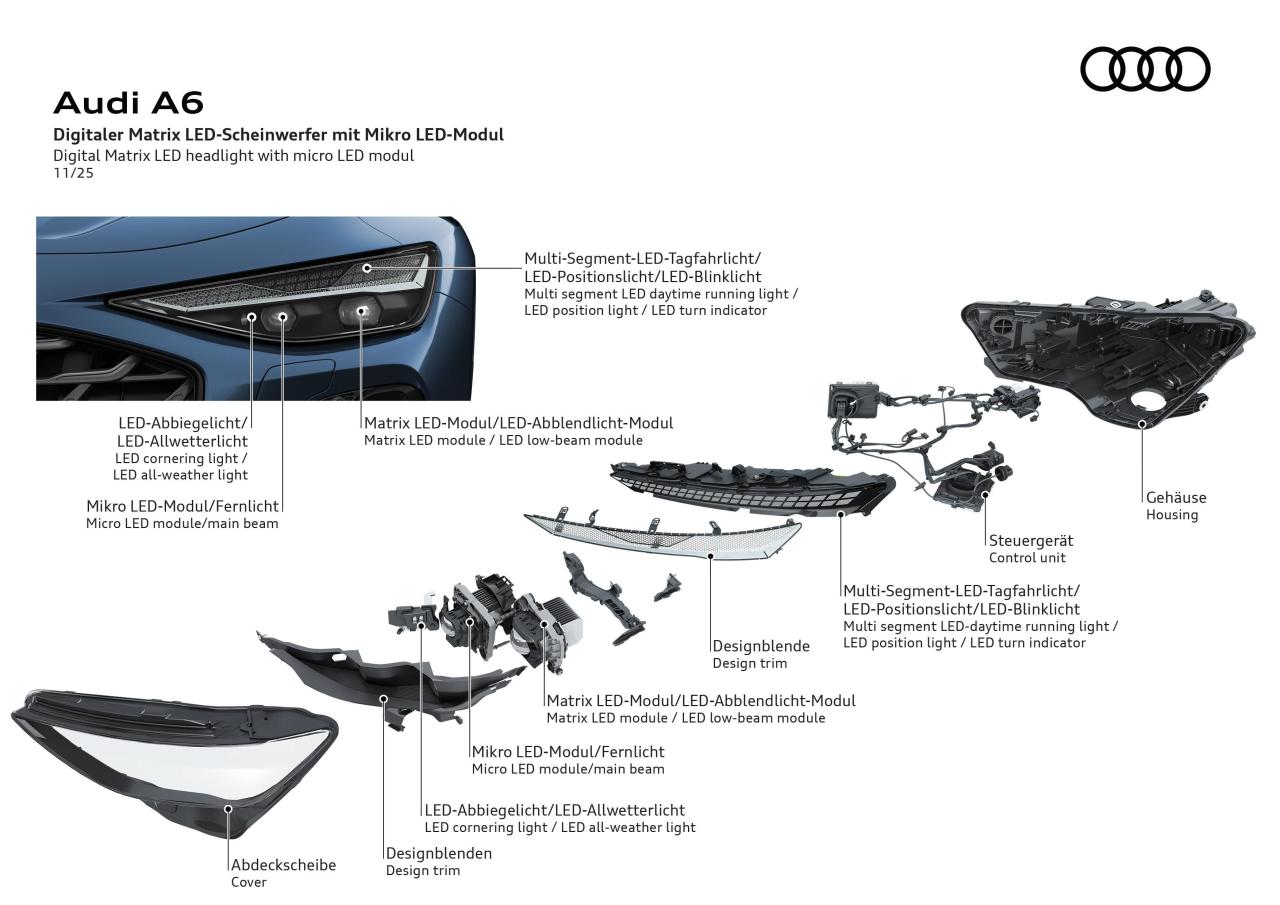

Digital matrix LED headlights for the Audi A6
Digital matrix LED headlights will be a new addition to the Audi A6 portfolio. They offer a high degree of personalization and adaptive, high-resolution lighting functions thanks to the new micro-LED technology. These headlights significantly improve illumination and create a strong contrast on the road. This is particularly advantageous when weather conditions cause difficult visibility. The lane guidance and orientation light helps with lane centering, and an arrow symbol on the road shows if the vehicle is unintentionally drifting out of its lane. If slippery conditions are expected, an ice symbol is projected to alert the vehicle occupants. The marking light also draws attention to people in the immediate vicinity of the road by illuminating them. The light guidance functions thus contribute to improved road safety.
As a further highlight, the digital matrix LED headlights display one of three selectable dynamic projections when entering and exiting the vehicle, creating an impressive light show even when the vehicle is stationary. The LED daytime running lights, consisting of 48 segments per headlight, also ensure high recognition value. They generate eight digital light signatures that can be selected in the MMI. Matching this, the digital OLED rear lights 2.0 taillight display, with 198 segments per side, also changes its appearance. Most of the front and rear signatures include active elements, meaning individual areas dim up and down intelligently. This constant movement creates a dynamic look that gives the lights a striking presence.
