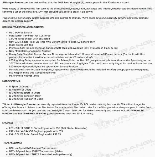

2018-jeep-wrangler-jl-dealer-system-opti
2.0 L4 DOHC

https://www.linkedin.com/in/david-james-574abbb
Design Leader for Chrysler's new GME-T4-M & GME-T4-D also was Base engine design leader on Tigershark Engine Program of the New D.O.H.C and Multiair 4 cyl engines
It's obvious what means GME T4 M and GME T4 D. And which one is inside of Giulia and which will end up inside of Wrangler.
If you dig enough you will for example discover GSE N3 CNG, GSE T3 CNG and much more.
For example Brazilian naturally aspirated FireFly engines are GSE N3 and GSE N4.
