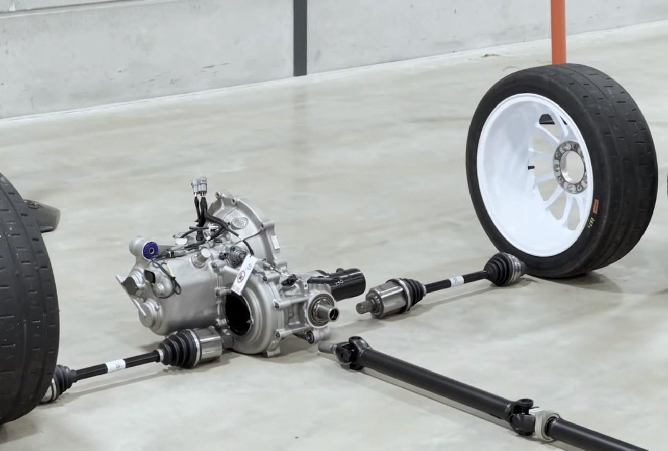

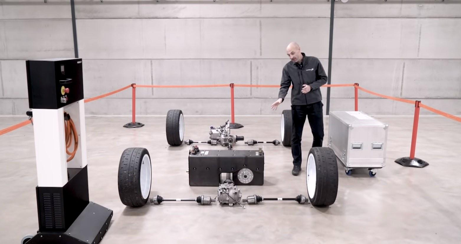

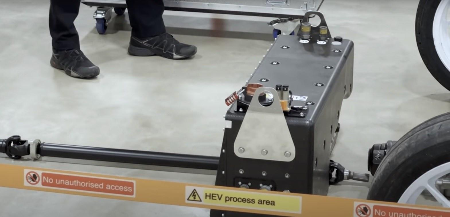

Io devo ancora capire come il modulo ibrido si interfacci al drivetrain
m-sport-reveals-the-secrets-of-the-plug-
è davanti, va in spinta seriale col motore termico se acceso, se spento muove le 4 ruote lui
15 minuti fa, Matteo B. scrive:
La macchina elettrica sembrerebbe all'interno del box di fronte alle ruote posteriori
Mi sa che il differenziale posteriore ha due ingressi
310321_FIA-Hybrid-2021_001_24ce9_frz_140
Modificato da maxsona
Adesso è chiaro
https://www.autoevolution.com/news/m-sport-reveals-the-secrets-of-the-plug-in-hybrid-drivetrain-on-2022-wrc-cars-179059.html
The electric motor delivers its resources to the rear wheels through a separate driveshaft that connects to the rear differential. The one seen in the video below, as well as in the photo gallery, is one from the Rally2 class of vehicles, and we are told that the unit is different from the Rally1 models.
Mind you, the rear differential has to be different, as it gets two driveshaft inputs that need to be managed while still having two driveshaft outputs, along with its limited-slip and other key features.
