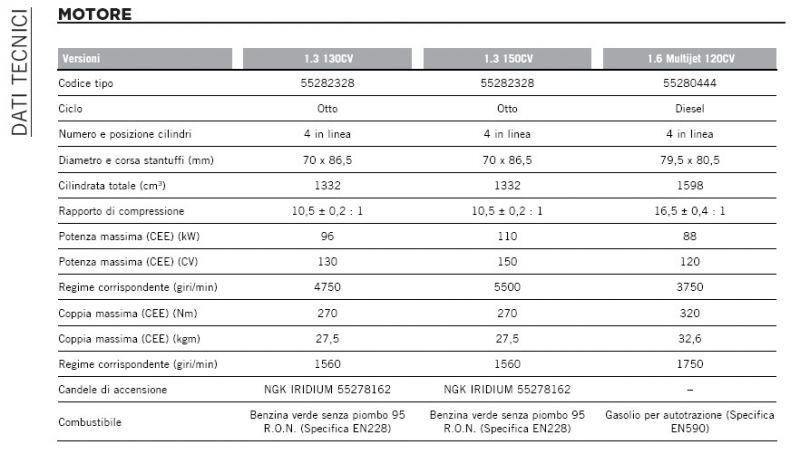

26 minutes ago, AlexMi said:
Qui la scheda tecnica della nuova 130cv:
http://www.media.fcaemea.com/it-it/download-model-document/150
It seems that the new 1.3 liter 130 PS engines is the same one as the new 150 PS engine. Both have maximum torque at just 1560 rpm
Previous version with 150/180 PS had maximum torque at 1850 rpm.
Are they using smaller turbo on these new engines?
