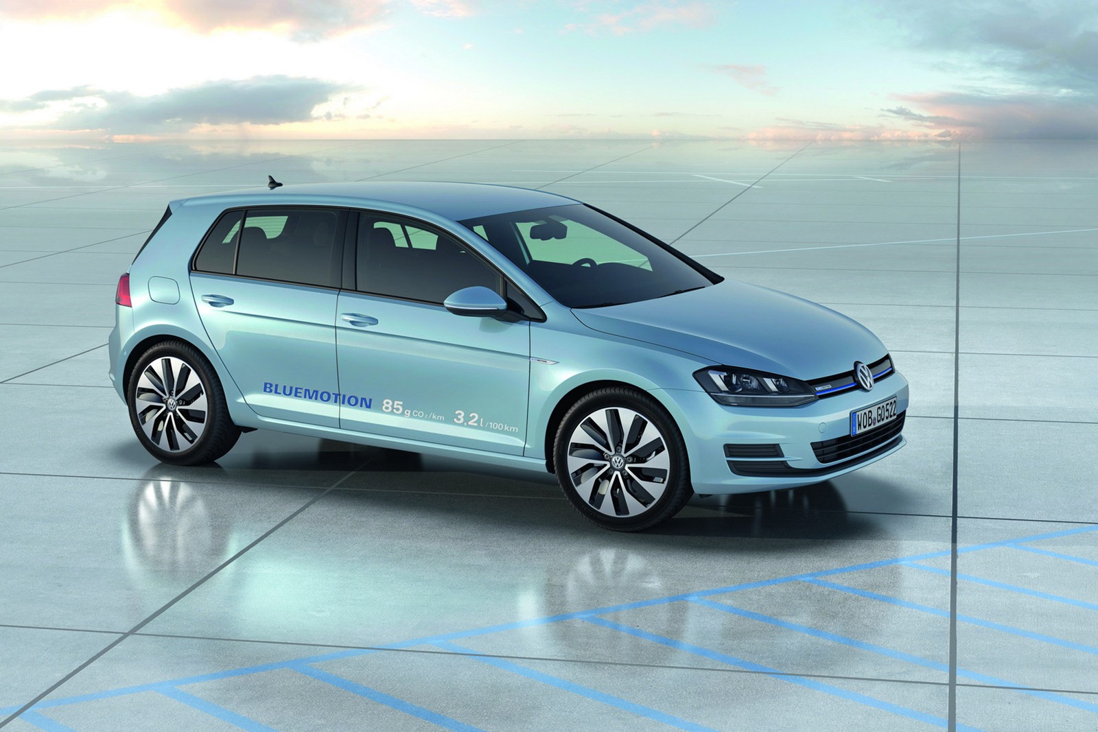

[h=3]Golf BlueMotion concept car – initial facts[/h][h=4]Premiere of the most fuel-efficient Golf ever:
New Golf BlueMotion consumes just 3.2 l/100 km
Volkswagen achieves top CO2 value of 85 g/km in Golf BlueMotion concept car
Fuel economy improved by another 15 per cent compared to previous model[/h]Wolfsburg / Paris, 26 September 2012 - At the Mondial de l'Automobile in Paris, Volkswagen is revealing one of the world’s most fuel-efficient cars: a concept of the new Golf BlueMotion. This Golf - powered by another new 1.6-litre TDI (turbodiesel) - consumes just 3.2 l/100 km; this value equates to CO2 emissions of a mere 85 g/km. Nonetheless, the 81 kW / 110 PS Golf BlueMotion is a five-seat well-rounded vehicle that is capable of 202 km/h and can accommodate an entire family safely and comfortably throughout the year. This third generation Golf BlueMotion will be launched into the market in summer 2013.

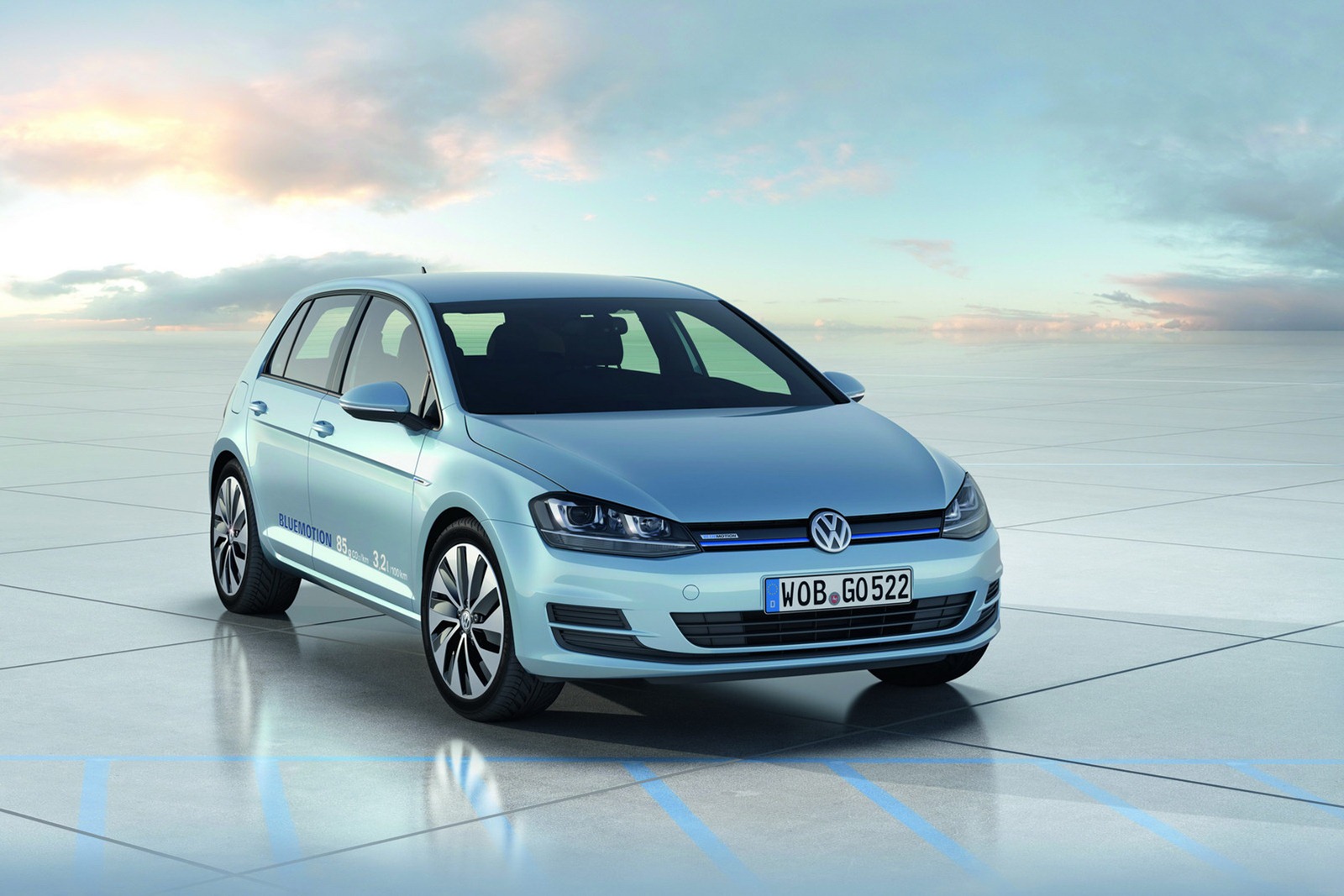

Weight, aerodynamic drag and rolling resistance reduced
Lighter, leaner, more efficient. The car’s combined fuel consumption - the lowest ever attained in a conventionally-fuelled Golf - was enabled by innovative lightweight design (including 26 kg less weight in the chassis and 37 kg less in the superstructure), engine-related modifications and a collection of other measures. These include super low rolling resistance tyres with higher air pressure, longer gear ratios (5-speed manual gearbox), the Stop/Start system and battery regeneration mode that are standard in all new Golf cars and specific aerodynamic modifications.
Aerodynamics. In the area of aerodynamics, the frontal area of the new Golf was reduced by 0.03 m2 and aerodynamic drag (cD x A) by nearly 10 per cent. Compared to other Golf models, the aerodynamics of the BlueMotion were also refined by a lowered chassis (by 15 mm), a roof spoiler, lateral air guide elements on the rear window, a radiator grille that is closed to the outside, partially closed air inlet screens, optimised cooling airflow, special underfloor panels, optimised brake cooling channels and a C-pillar spoiler. These measures take the Golf BlueMotion to a cD value of 0.27, making it one of the most aerodynamic vehicles in its class.

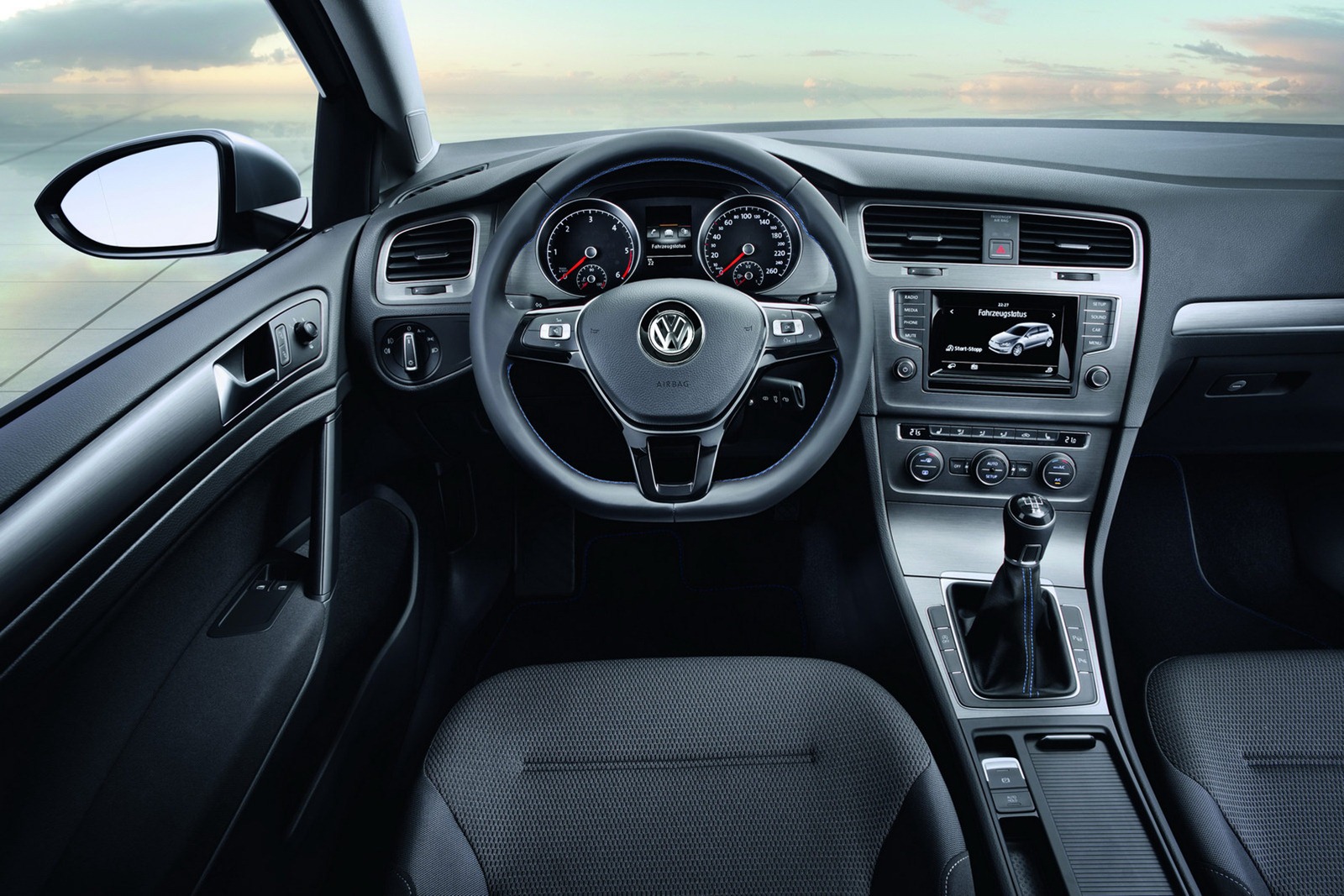

Golf BlueMotion 1.6 TDI Trendline. Like all seventh generation Golf cars, the entry-level model to the BlueMotion world is equipped with such features as seven airbags and Electronic Stability Control (ESC); the car can also be ordered as a two-door or four-door. Additional standard features in the Golf BlueMotion 1.6 TDI Trendline include a touchscreen with 5-inch TFT display, filler neck with guard against use of the wrong fuel, luggage compartment cover, ECO-HMI (display of fuel efficiency and tips on improving it in the multifunction display), the multicollision brake, electronic parking brake with Auto Hold function, XDS limited-slip differential, tyre pressure indicator and variable cargo floor.
Also standard: daytime running lights, green heat-insulating glass, air conditioning, locking glovebox, chrome rings around the interior air nozzles, Easy Entry (two-door), asymmetrically split folding rear seatbacks, electric door mirrors, electric windows, rear wiper with intermittent function, electromechanical steering, height and length adjustment of steering column, height adjustable driver’s seat, dust and pollen filter, central locking with RF remote control, height adjustment and belt tensioners for the front seatbelts, disc brakes at all wheels and safety-optimised head restraints.
Golf BlueMotion 1.6 TDI Comfortline. The even more extensively equipped Comfortline level adds 16-inch alloy wheels, ParkPilot front and rear, a more exclusive instrument cluster, sliding drawers under the front seats, the new Composition Touch radio system including SD card interface and a fatigue detection system. Also included are front comfort seats with lumbar supports, cargo pass-through option and centre armrest on the rear bench seat, chrome look for the rotary light switch and mirror adjustment switches, storage pockets on the backrests of the front seats, a storage bin with lid in the roofliner, a 12V accessory outlet in the boot, illuminated vanity mirrors, fabric floor mats and leather-trimmed steering wheel and leather gear shift grip.

Bella la mascherina chiusa con il filo blu. 85grammi di emossioni è praticamente un record...sicuramente non veritieri ma avrà agevolazioni fiscali in molti paesi...
Ah bene' date=' finalmente anche una foto con la radio "barbona" di serie su tutte.[/quote']
Alla faccia del "barbone" fa una scena incredibile, bruttini invece i sedili barboni-:)

Quello che volevo intendere... non c'è bisogno di mettere il super navigatore per avere una plancia completa. I sedili mi pare siano quelli della passat base, mi sanno di vecchio, ma devono essere molto ampi (cosa che non mi piace granchè).

La mascherina anteriore mi piace, me la immagino con il listello cromato, farebbe un figurone. Devo dire che se mantengono quest'estetica sul modello di serie hanno fatto centro, è la prima BlueMotion della Golf che mi piace e noto che stavolta non hanno messo le rotelle dei passeggini "Chicco" come nelle precedenti versioni.
