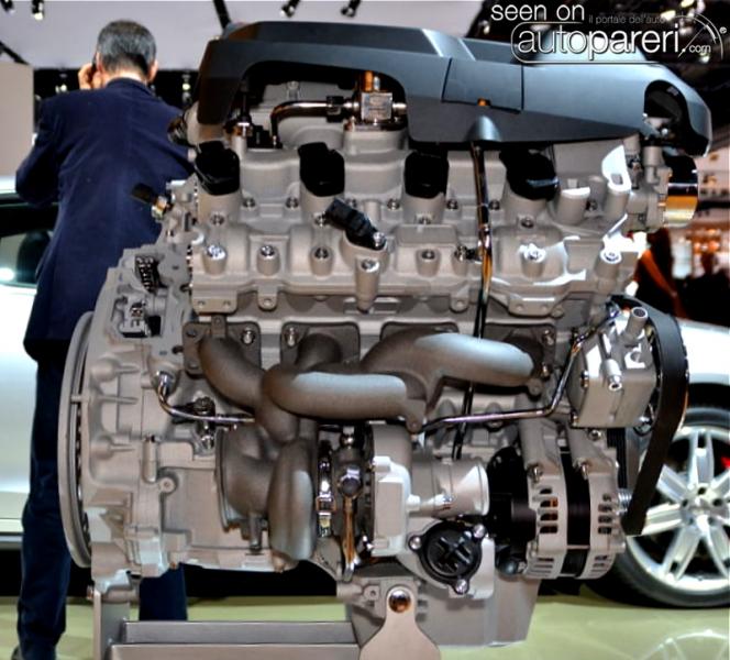

3.0 V6 DI Bi-Turbo
V6 TWIN TURBO ENGINE AND PERFORMANCE
The Quattroporte's all-new V6 twin turbo engine is a close relation of the V8, sharing most of its core components.
With 301 kW (410 hp) of power at 5500 rpm, it still provides a tremendously powerful driving experience, especially with 550 Nm of flat torque between 1500 rpm and 5000 rpm. In Normal mode the torque is smoothed at 500Nm in the lower rpm range, reaching the 550 Nm threshold at 5000 rpm to guarantee the 301 KW of maximum power.
The engine shares the V8's bore and combustion chamber design, the same valves control technology (i.e. roller finger followers and four cam phasers), the same twin turbocharging approach and direct injection-ignition system. The engine auxiliaries are identical (alternator, starter motor and power steering pump) or very similar (variable displacement oil pump).
Nonetheless it has a character of its own, revving to a lower 6500 rpm maximum speed and delivering its torque level of 500 rpm sooner than the V8.
While its specific power output is slightly lower than that of the V8, at 137 hp per litre, its specific torque is actually higher than the larger-engined car's standard specific torque, at 183 Nm per litre.
It is also a lighter car, with 1860kg in its rear-wheel drive configuration (+70 kg in all-wheel drive).
In rear-wheel drive mode, it accelerates to 100 km/h in 5.1 seconds, while the all-wheel drive V6 twin turbo manages the sprint in 4.9 seconds.
Both cars are still as fast as people would expect from the Maserati brand, with the rear-wheel drive's 285 km/h (177 mph) top speed matching the outgoing Sport GT S and the all-wheel drive V6 twin turbo reaching 284 km/h (176 mph).
The rear and all-wheel drive models are also very similar in their fuel consumption, with both cars posting 10.5 l/100 km on the combined cycle, with the rear-wheel drive car claiming 244 grams of CO2/km and the all-wheel drive 246 grams.
1760d1360890646-maserati-v6-e-v8-bi-turbo-id-e-nuova-4x4-magna-steyr-maserati-3.0-v6-di-bi-turbo-autopareri.jpg

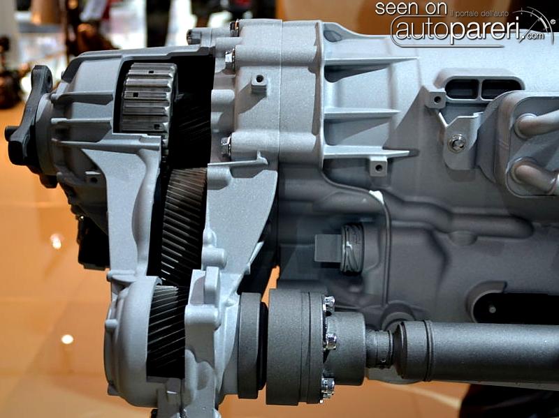

La trazione integrale utilizzata sul V6 viene prodotta da Magna-Steyr.
Comporta un aggravio di 70kg.
In 150 ms è in grado di ridistribuire la coppia dal 100% al posteriore a 50-50, simmetricamente sui 2 assi.
1758d1360890352-maserati-v6-e-v8-bi-turbo-id-e-nuova-4x4-magna-steyr-magna-steyr-transfer-case-4x4-maserati-quattroporte-2013-autopareri.jpg
