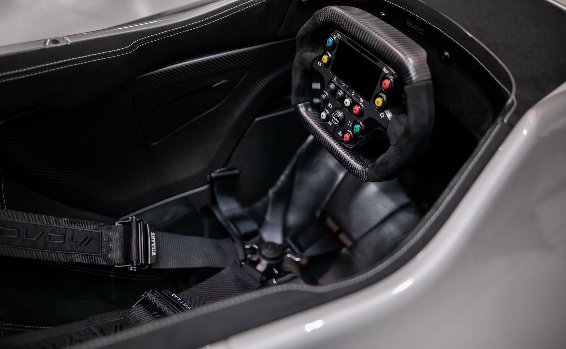

The use of additive manufacturing on the new Mono is more extensive than ever for BAC with over 40 components being 3D printed, including the front and rear light surrounds, mirror arms and mirror housing, front hatch hinges, the front hatch latch mechanism, engine inlet components and more.
Lighter AP Racing brake calipers and a new carbon floor are successfully carried over from the Mono R, while optional carbon-ceramic brakes (which save 2.55kg of unsprung mass per corner) further contribute to weight saving.

BAC has lowered the car’s centre of gravity and improved weight distribution to near-perfect proportions, thanks in part to increasing the volume and lowering the fuel tank. The battery has also been repositioned to the centre of the car underneath the driver for optimum balance.
