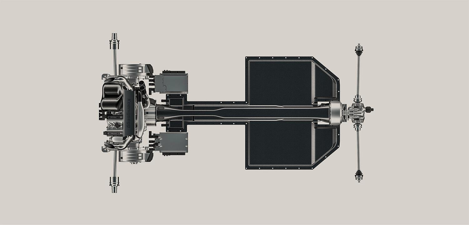

TECHNICAL SPECIFICATIONS
PROPULSION
INTERNAL COMBUSTION ENGINE (ICE)
• Koenigsegg Tiny Friendly Giant Twin Turbo Freevalve 3-cylinder Internal Combustion Engine (ICE) with dry sump lubrication
• Compression: 9.5:1 - Bore: 95 mm - stroke: 93.5 mm
• Closed-loop combustion control with in-cylinder pressure sensing
• 440 kW (600 bhp) at 7500 rpm, red line at 8500 rpm
• Torque: 600 Nm from 2000 rpm to 7000 rpm
• ICE is mounted midship and powers the front axle together with one E-motor through a propshaft
• Engine weight: 70 kg
E-MOTORS
• Three Electric Motors: One for each rear wheel with 500 bhp and 1000 Nm each and one E-motor on the crankshaft 400 bhp and 500 Nm to power the front wheels (together with the ICE)
ENGINE MANAGEMENT
• Koenigsegg Engine Control Module
• Flex fuel capability including E100, Methanol and sun fuel
• High power ion sensing coil-on-plug ignition system
OUTPUT
• Total output 1700 bhp - 3500 Nm, including Hydracoup
• Max wheel torque: 11,000 Nm at ICE 4000 rpm
• 1100 bhp of combined electric power (counting E-motors separately – 1400 bhp)
RANGE
• ICE only range: up to 950 km
• Electric range: up to 50 km
• Total range: up to 1000 km
TRANSMISSION
FRONT AXLE
• Midmounted Koenigsegg ICE + E-motor Hydracoup Direct Drive transmission powering the front axle. The front axle has torque vectoring capability and can be disconnected to save energy in EV only mode
REAR AXLE
• Independent E-motors with independent transmissions enabling torque vectoring and reverse. The rear transmission are equipped with wet clutches for decoupling, for range mode.

9 minuti fa, Sarrus scrive:
prima auto con motore termico posteriore (a sbalzo)
Nella scheda tecnica però c'è scritto "mounted midship", che interpreto come "montato al centro", ma in effetti lì ci sono i sedili posteriori. Possibile abbiano optato per una soluzione in stile Lotus Evora?
5 minuti fa, GL91 scrive:
nel video di Shmee si vede (ad esempio a 5:30), è in posizione posteriore centrale montato longitudinalmente dietro i sedili davanti al bagagliaio. Questo poi è collegato all'anteriore invece che al posteriore.
Modificato da 8coibaf
11 minuti fa, GL91 scrive:
Dicono sia montato dietro l'abitacolo, assieme ad un elettrico da 400 CV.
Tale "powertrain" da 600+400 CV, va a collegarsi alle ruote anteriori tramite un'albero ed un differenziale a 2 frizioni, per realizzare un torque vectoring. Una scelta pazzoide! :D
Al posteriore poi ci sono 2 elettrici da 500 CV ciascuno, uno per ruota.
Quindi sono riusciti a contenere il motore "dentro" l'asse delle ruote, senza montarlo a sbalzo. Il lavoro fatto dal punto di vista tecnico è davvero impressionante.
yes, posteriore centrale scusate, avevo considerato che i motori elettrici posteriori fossero direttamente collegati ai semialberi, invece mi pare che il motore elettrico anteriore sia montato proprio prima del differenziale anteriore
