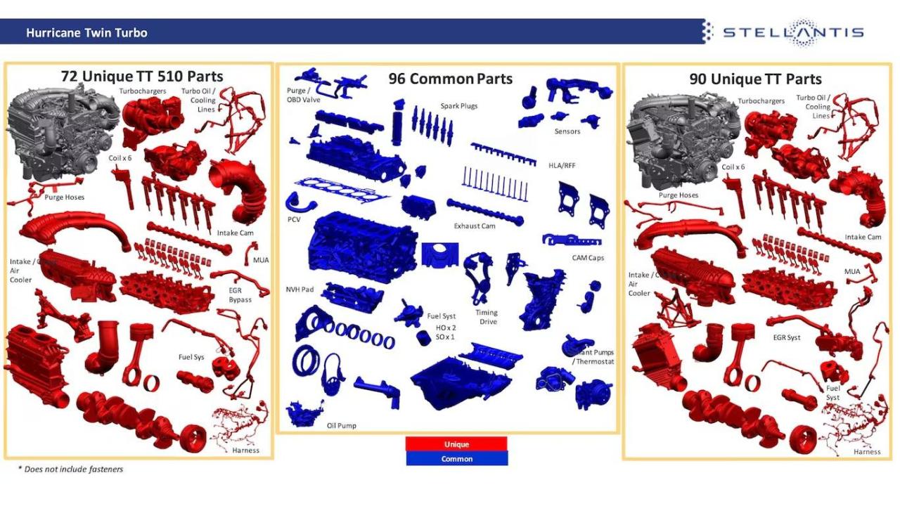

The new powerplant will fit into any vehicle currently sold that has a longitudinal engine. When the Hurricane arrives under the hood of various Stellantis-brand vehicles within the next year, the double-overhead-camshaft, direct-injected inline-six will have bore and stroke measurements of 84.0 millimeters and a 90.0 millimeters. Its cylinders are spray bored using a plasma transfer wire arc process that adds a thin iron coating to the cylinder walls, which Stellantis claims saves three pounds versus using a more traditional iron sleeve. Those bore and stroke figures are identical to BMW’s potent S58 3.0-liter inline-six that powers the M brand and also follows the same approach of having each turbo fed by three cylinders to minimize turbo lag. The Hurricane will be offered in standard-output and high-output variants.
Stellantis says the standard-output engine will deliver more than 400 horsepower and 450 pound-feet of torque, with the final output figures to be determined by the individual brands utilizing the new mill. The lesser-power version has a 10.4:1 compression ratio, and its intake charge is pressurized by the twin turbos with up to 22.4 pounds of boost before being chilled by a water-to-air intercooler. The junior 3.0-liter will rev to 5800 rpm and operate on 87 octane, though 91 is recommended.
The high-output version is set to deliver more than 500 horsepower and 475 pound-feet of twist, putting it on par with BMW's strongest six-cylinder offering. The compression ratio is lowered to 9.5:1 to accommodate the 26.0 psi delivered from the larger turbos through a dual-inlet intake. The high-output engine features its own cylinder head, crankshaft, larger water-to-air intercooler, and forged aluminum pistons (vs. the standard-output's cast pieces) and will rev slightly higher, to 6100 rpm, although well off the glorious 7200-rpm wail of BMW’s singing six. To generate all this wonderful power, 91 octane will be required.

  • Le differenze tra la versione SO e quella HO:
  • "cosa vuoi che sia, hanno solamente taroccato la centralina..." 😜

Standard Output o High Output
L’Hurricane Standard Output, ha un rapporto di compressione di 10,4:1 and allunga fino ad un massimo di 5800 rpm. Può funzionare con benzina a basso numero di ottano, così come la regular da 95 RON.
L’Hurricane High Output ha un rapporto di compressione ridotto a 9.4:1 ed allunga sino a 6100 rpm. Esclusivamente con benzine dai 95 RON in su.
La differenza fra i due sistemi, anche in virtù del diverso RdC, è nei condotti di aspirazione, nelle valvole di diversa dimensione e nel gruppo turbocompressore con giranti del compressore differenti e diversa pressione di sovralimentazione (1.5 Bar vs 1.8 Bar) .
L’Hurricane SO eroga così 406 CV e 610 Nm di coppia e l’Hurricane HO si ferma a 507 CV e 644 Nm di coppia. Il 90% della coppia motrice è disponibile già da 2350 rpm e resta costante fino al raggiungimento del limitatore di giri. Questo per far comprendere l’area di utilizzo di questo motore.
