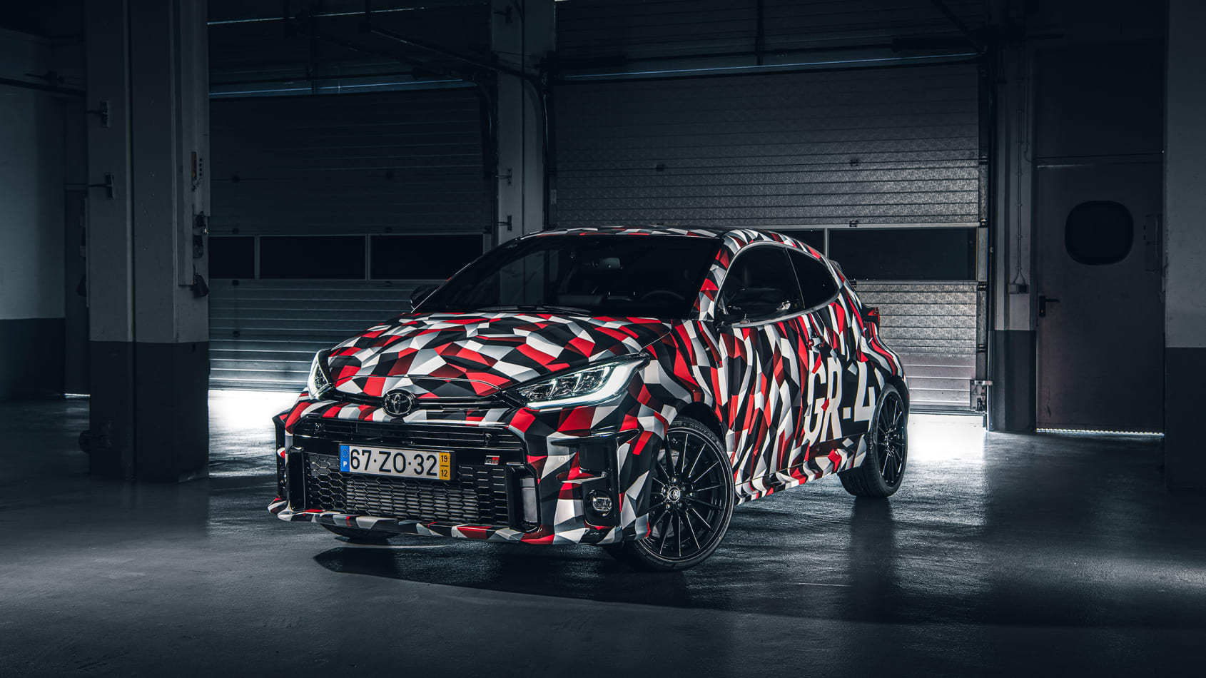

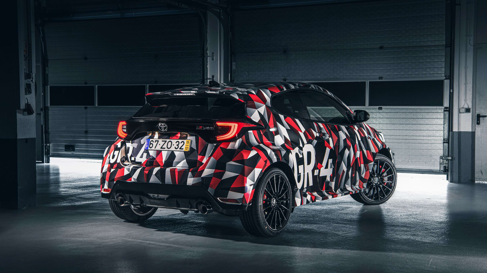

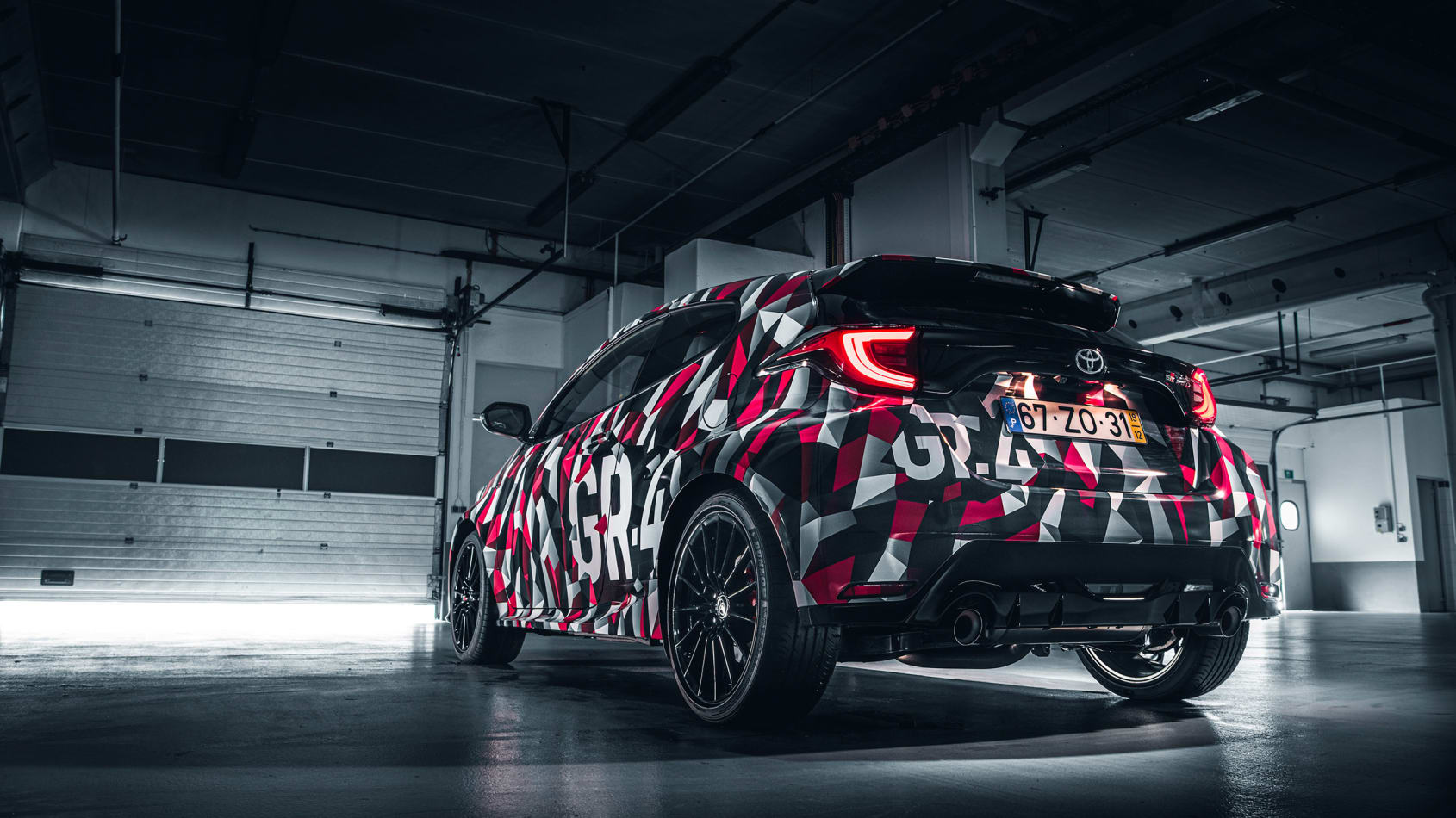

2020 Toyota GR Yaris detailed - plus our prototype drive
Spiritual successor to the Celica GT-Four is a true homologation special – and we’ve driven it
Four-wheel-drive performance cars are common today, but four-wheel-drive performance cars homologated for motorsport are much less frequent – making next year’s Toyota GR Yaris something rather special indeed.
That’s because the hot hatchback, due to be unveiled in full at the Tokyo Auto Salon in January, is a homologation special, just like the Subaru Impreza WRXs and Mitsubishi Lancer Evolutions of old, and will inform Toyota’s next WRC Yaris.
While the car itself is under wraps, evo has been able to drive a prototype of the GR Yaris, as well as quizzing the car’s engineers. While Toyota is being coy on exact specifications for the car, we’ve still been able to glean plenty of information about it, and it looks like being one of the most exciting performance cars of 2020.
Body and chassis
It makes sense to cover the GR Yaris’s structure first, as it’s one of the areas most important to the car’s status as a homologation special. Gazoo Racing set several goals for the car, including aerodynamics, weight, stiffness and weight distribution, and many of these were decided upon based on requests by Tommi Mäkinen, who for the last few years has served as team boss of the Toyota world rally team.
To this end, the three-door shell is almost completely different from that of the new five-door Yaris we’ve already seen. For one, it uses a carbonfibre structure, while individual elements including the roof, tailgate, bonnet, doors and front wings are aluminium, for further weight savings. In all, the body in white weighs 263kg, 38kg lighter than on a regular Yaris. If that seems insignificant, consider also that the carbon does wonders for structural stiffness, important for a car designed for the stages.
The shape itself is also significantly different. The roofline is 95mm lower than a regular Yaris’s (apparently, Mäkinen wanted it even lower, to benefit the rally car’s aero further) while the three-door shell is stiffer, lighter, and allows greater aero freedom than a five-door equivalent. There’s also further structural stiffening with side members under the car, while the engine is mounted 21mm further back, improving weight distribution.
Rear suspension has changed from a torsion beam to double wishbones (in part, allowing space for the driven rear axle), springs and dampers are passive rather than active, while the front and rear tracks are wider, by as-yet unspecified amounts. Extended bodywork covers this wider track front and rear.
While the car hasn’t yet been officially unveiled, some aspects of its design are still clear through the camouflage: a large lower front grille directs air to an intercooler, while a grille above the number plate supplies the radiator, and large vents to either side direct air to the front brakes. The rear window is so small it doesn’t even get a wash/wipe (on the prototype at least).

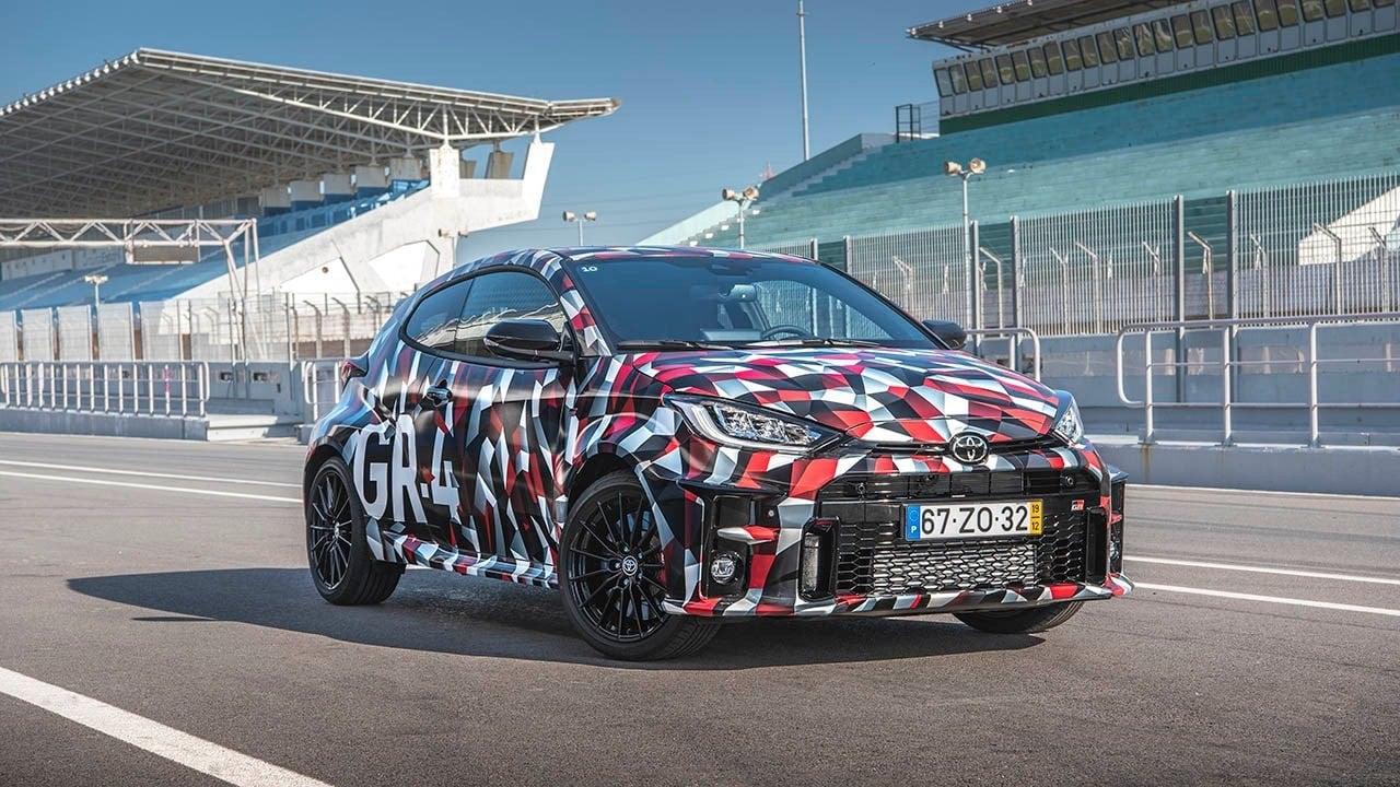

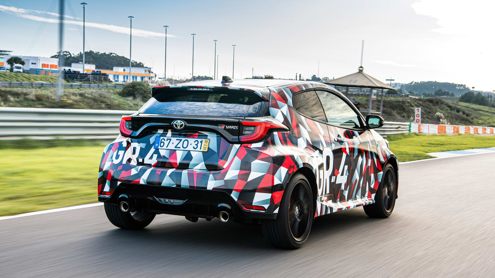

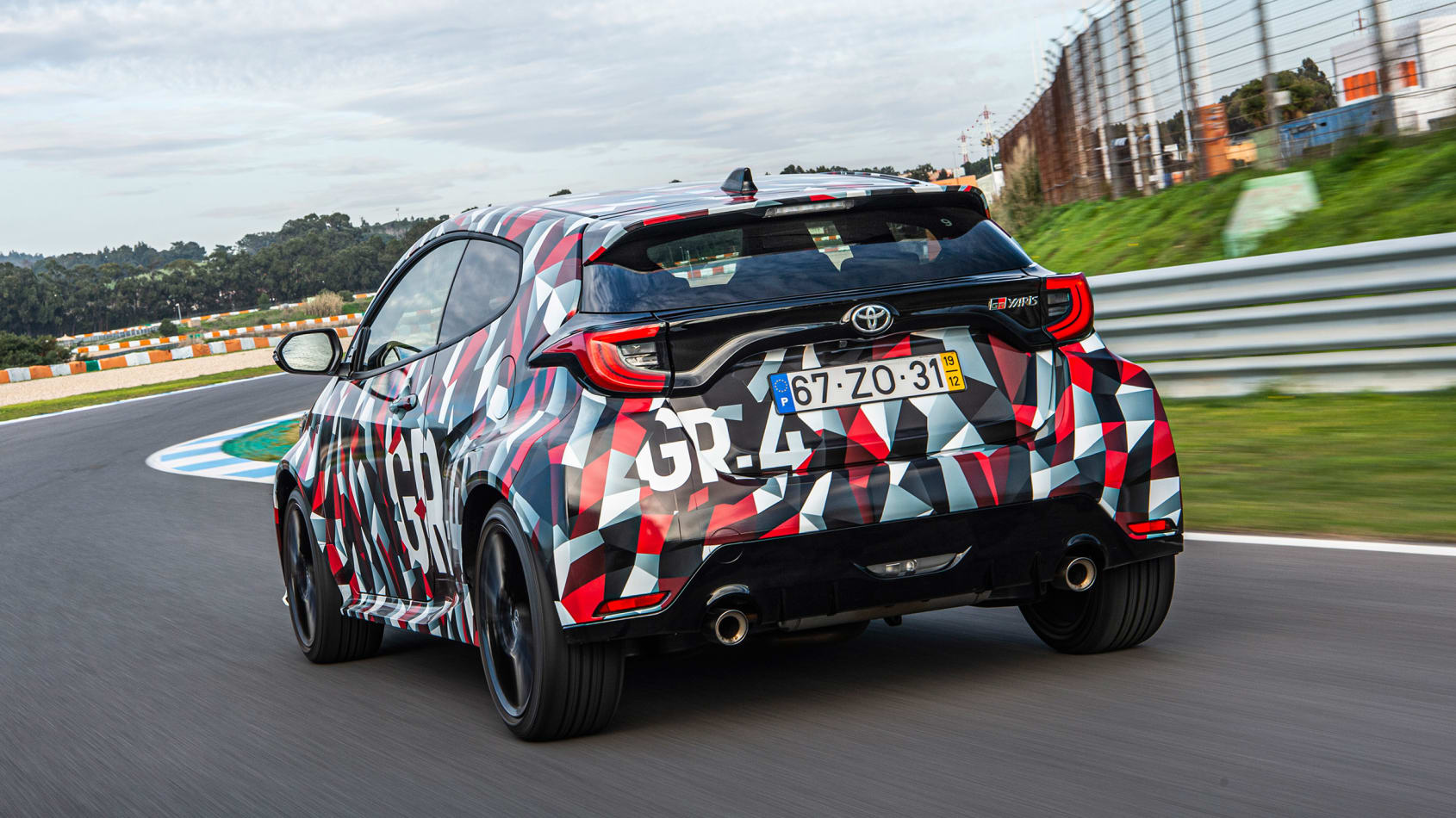

A few caveats first. Our drive of the GR Yaris was of a disguised prototype car, with several changes still to be made before it reaches production. In addition, neither the Portuguese road route nor our laps around the Estoril race circuit were what we’d call ideal – the former was a little too heavily trafficked and short on truly testing sections, while the latter was just too fast and open for a car designed for much tighter tarmac.
Still, there’s plenty of promise. There’s not much we can say on the cabin, given most of it was under sheets, but aside from a relatively high driving position, everything else seemed about right – seat comfort, control spacing and weights, instrument clarity.
The engine is certainly interesting. It sounds like a triple at start-up and when ambling around, but the gruff noise elsewhere is quite unlike any other three-cylinder we’ve tried. There seems to be a complete absence of artificially enhanced sound or even any real exhaust tuning. Instead, the sound is mechanical and purposeful – not unlike that of old Evos and Celica GT-Fours, which were more businesslike than they were tuneful.
13
There’s no doubting its performance, certainly. Exposure to modern performance cars means it’s not as startling as those earlier homologation cars were in context, but in the lower gears it really moves, and only really runs out of steam 500rpm or so from the 7k red line. Response is good too – at anything over around 2000rpm it picks up cleanly and has relatively little lag, while slotting through the six-speed feels not unlike the short, notchy shifts of a GT86.
Throttle and clutch are light, and the brakes are a treat – there’s certainly motorsport influence in the firm and progressive pedal, and there was no sign of fade on track despite hopping into the car after other journos had been round in five-lap stints.
As previously mentioned, road conditions made it difficult to determine some of the car’s characteristics, but on track it seemed to be nicely balanced, turning in positively and resisting understeer even around longer corners, though a slippery surface meant it wasn’t beyond washing wide if you used too much power too soon. We drove cars with and without the circuit pack, which brings forged wheels and Pilot Sport 4S tyres as well as a pair of LSDs, and both grip and steering feel seemed improved with the pack equipped.
What the road route did illustrate is a car with surprising maturity to its ride. The stiff structure means even a relatively firm set-up seems less punishing, as bumps don’t result in those subtle but perceptible creaks and noises that make a car seem stiffer than it is. Its ability to handle bumps feels closer to a Golf R than a Focus RS, in this respect.
