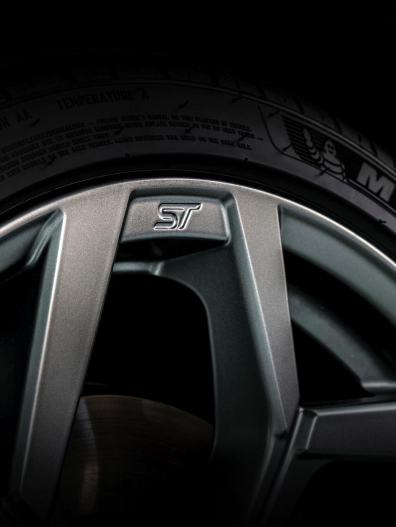

Ford Performance worked alongside Michelin to develop a bespoke tyre specification to complement the Puma ST’s enhanced chassis, without sacrificing the refined ride quality – one of the most compelling SUV attributes.
The Michelin Pilot Sport 4S tyres can fully exploit the additional traction offered by the optional Quaife mechanical limited-slip differential, delivered as part of the available performance pack.

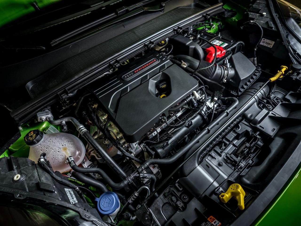

Ford’s sophisticated 200 PS 1.5-litre EcoBoost petrol engine – first introduced for the multi-award-winning Fiesta ST – features advanced turbocharging and high-pressure fuel injection technologies alongside Twin-independent Variable Cam Timing to deliver sports car performance with optimised fuel efficiency.
The all-aluminium engine’s three-cylinder architecture provides naturally high torque at low rpm, and performance is enhanced by a radial-axial turbocharger and an integrated exhaust manifold that minimises the distance exhaust gasses travel between cylinders and turbocharger – both helping build boost pressure faster and minimise lag.
Peak power is available at 6,000 rpm, with peak torque increased to 320 Nm between 2,500 rpm and 3,500 rpm, contributing to linear acceleration and enhanced responsiveness.
In addition to a bespoke air-intake and a free-flowing exhaust system for maximum performance, the Puma ST also features new roll-restricting engine mounts that minimise unwanted movements particularly during hard cornering, while supporting everyday refinement.
Active exhaust valve technology amplifies the naturally sporty three-cylinder engine sound to enhance the driving experience. Ford Performance tuned the exhaust note to better suit the Puma ST’s more refined SUV character – the model is approximately 1 decibel quieter than the Fiesta ST for a more composed cruising experience.
Industry-first innovation further enables the 1.5-litre EcoBoost engine to be as sensible as it is sporty. Ford’s cylinder deactivation technology was the first to feature for a three-cylinder engine and can automatically stop fuel delivery and valve operation for one of the engine’s cylinders in conditions where full capacity is not needed, such as when coasting or cruising with light demand on the engine.
The technology can disengage or re-engage one cylinder in 14 milliseconds – 20 times faster than the blink of an eye – saving fuel and seamlessly contributing to anticipated 6.0 l/100 km fuel efficiency and 134 g/km CO2 emissions NEDC (6.9 l/100 km and 155 g/km WLTP).1 A rapid light-off gas particulate filter also reduces soot emissions.

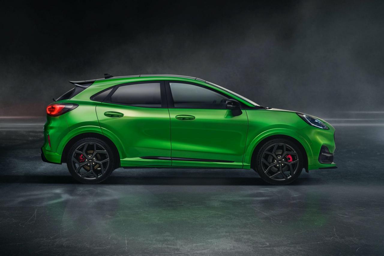

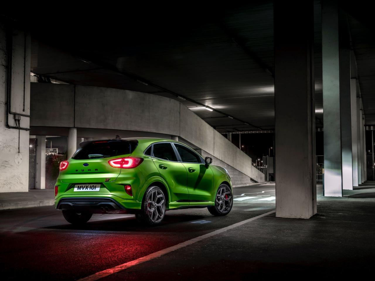

Puma’s sporty styling – including a sloping roofline silhouette and pronounced wheel arches – lends itself to a more extreme Puma ST design that combines form and function.

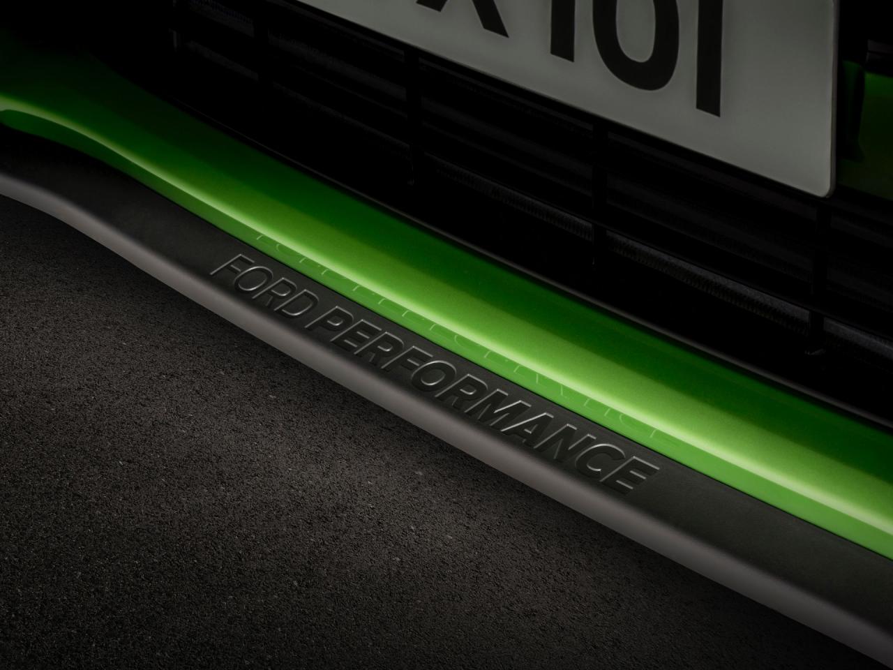

A Ford Performance-embossed splitter is integrated into the front bumper to increase front end downforce by almost 80 per cent for greater stability and traction. The large rear roof spoiler also supports optimised aerodynamics, with a distinctive diffuser incorporated into the rear bumper. Signature ST upper and lower grilles are designed to deliver increased engine cooling capability.
The Puma ST offers Magnetite or machined metal finishes for the standard 19-inch alloy wheels, and six available exterior body colours include Agate Black, Desert Island Blue, Fantastic Red, Frozen White, Magnetic and bold, ST-exclusive Mean Green. A gloss black finish for the roof, grille surrounds, side spears, door mirror caps and rear roof spoiler are all standard, making the model even easier to identify.

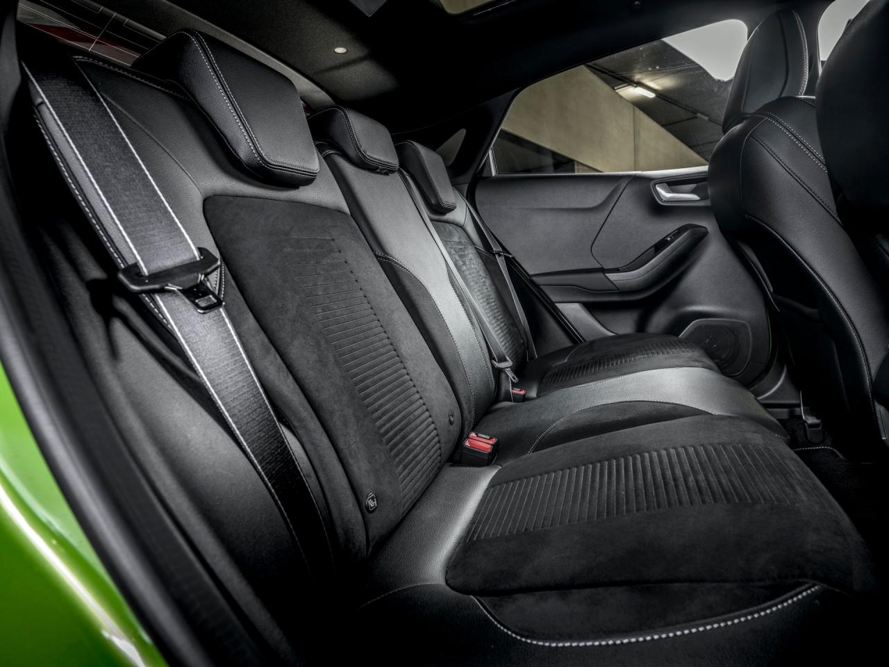

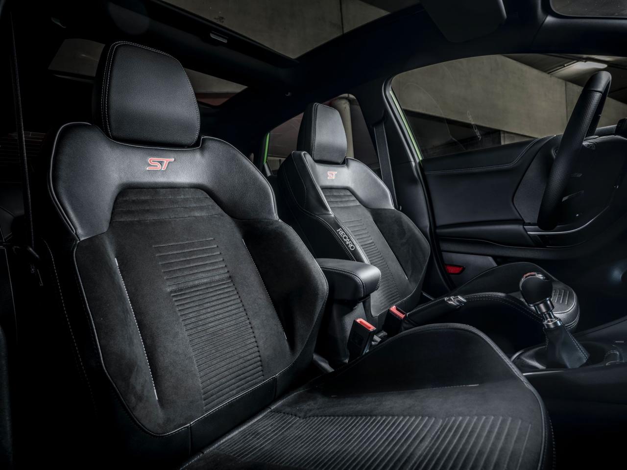

Inside, heated, bolstered Recaro sports seats – embossed with the ST logo and finished in grippy Miko Dinamica material – hold driver and front passenger firmly in place. Ford Performance skid plates, a flat-bottomed leather steering wheel and ST gear knob also feature. Seats, gear lever gaiter and ST-branded floor mats are finished with Metal Grey stitching.
The exclusive Puma ST interior continues to offer best-in-class uncompromised loadspace of 456 litres,3 supported by the innovative Ford MegaBox. The adaptable storage solution provides a deep, versatile, 80-litre storage space beneath the boot floor – capable of comfortably accommodating two golf bags in an upright position.

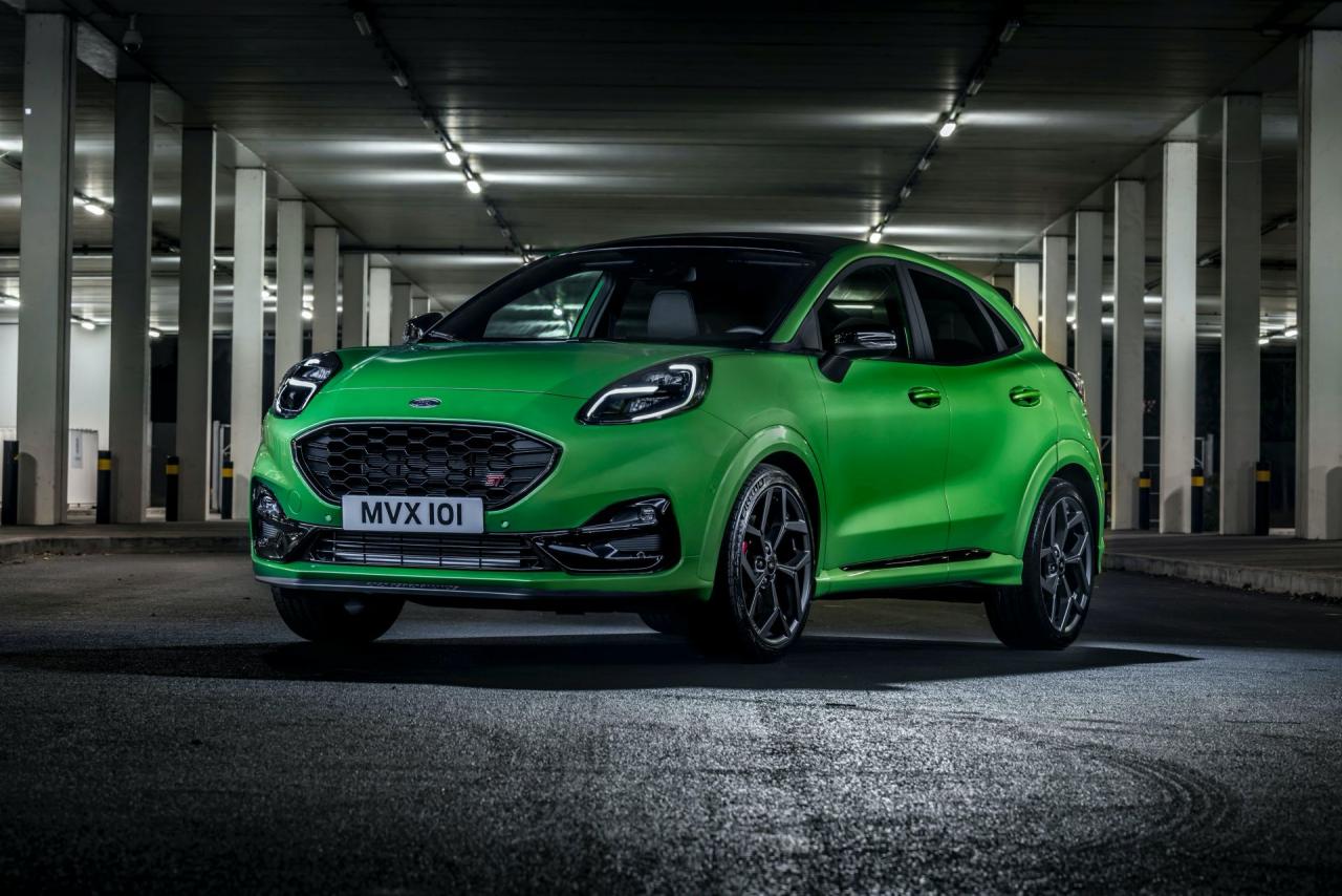

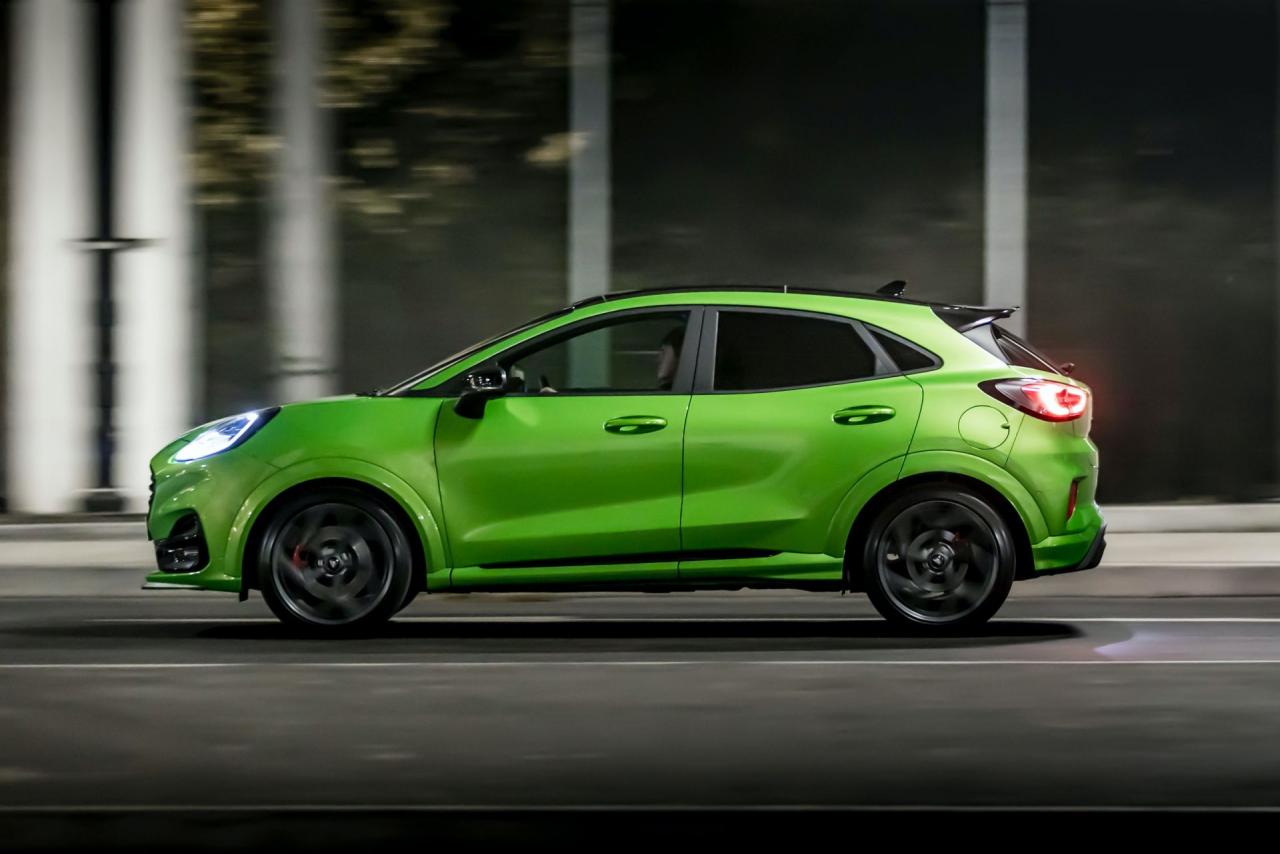

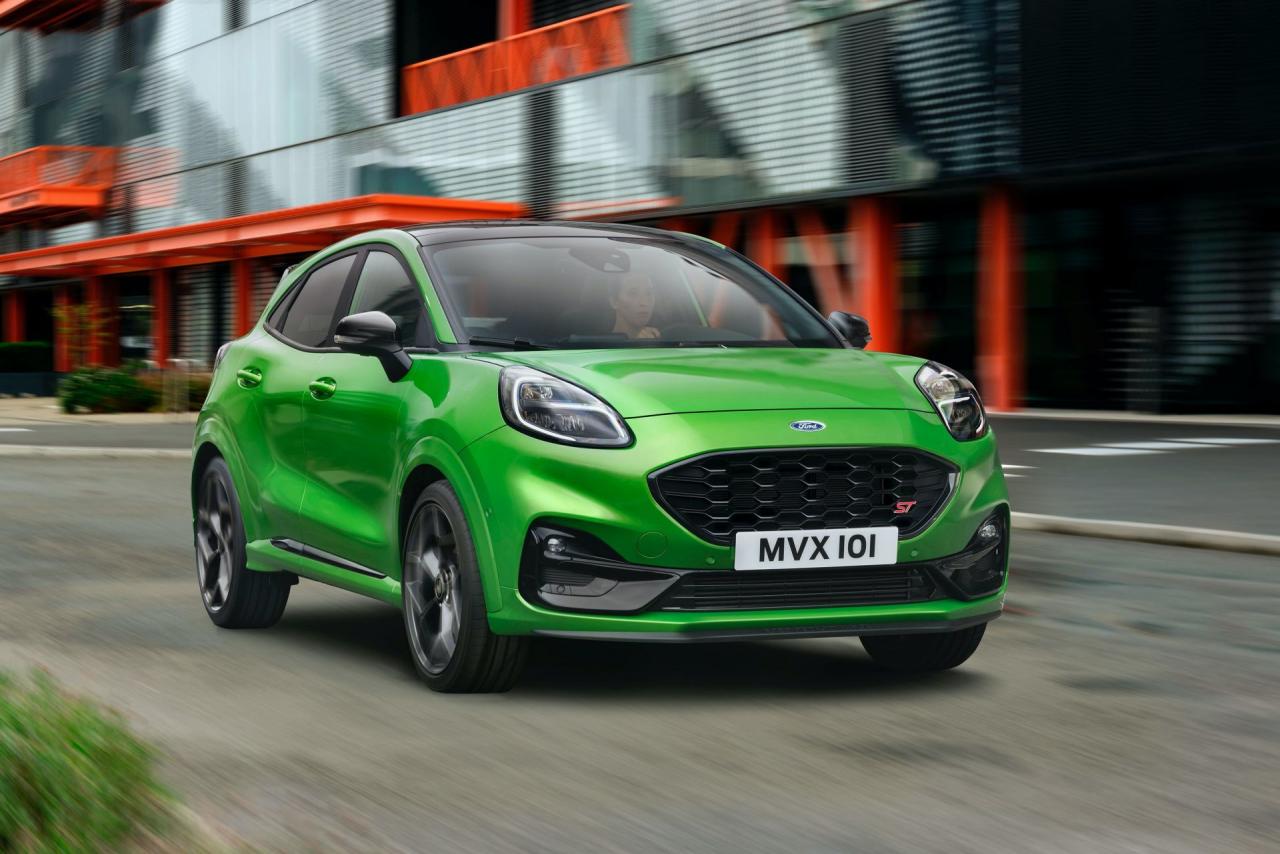

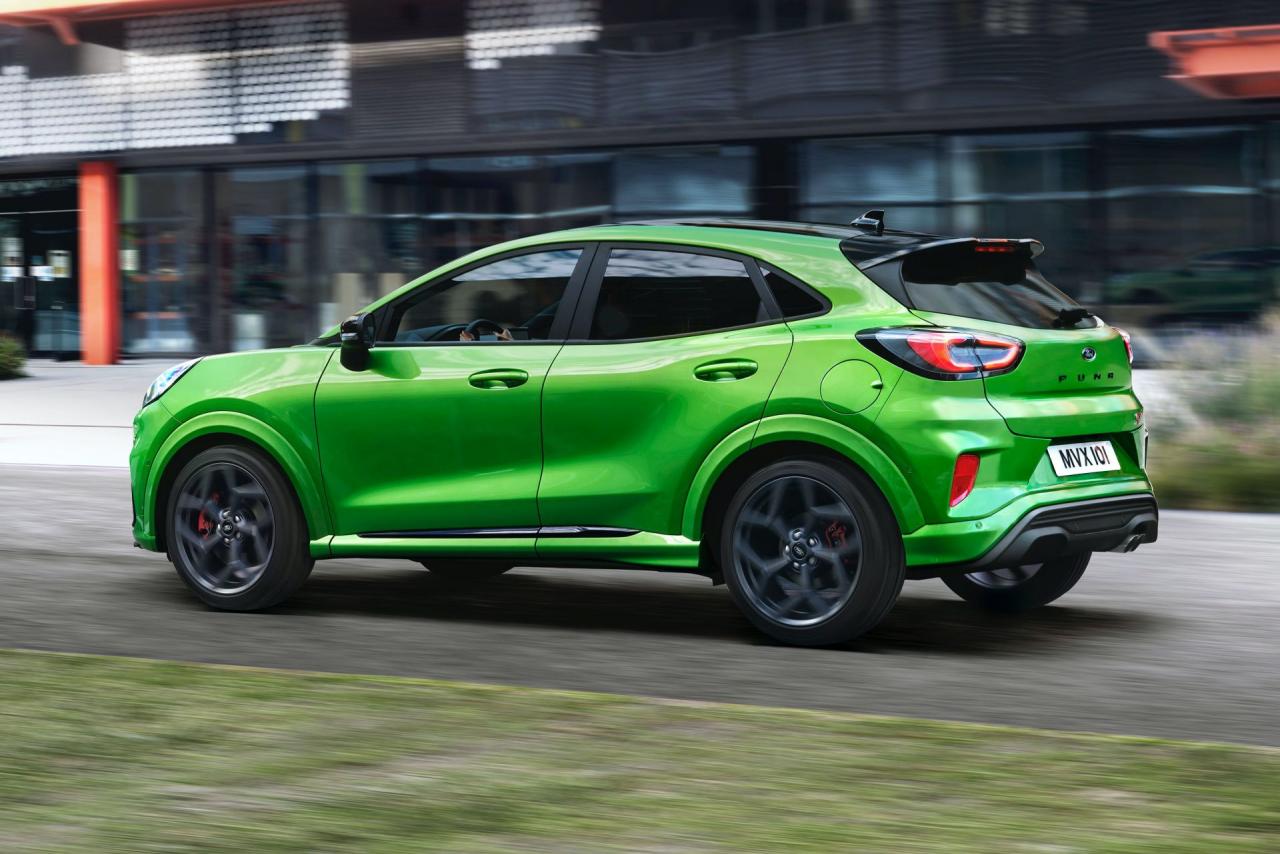

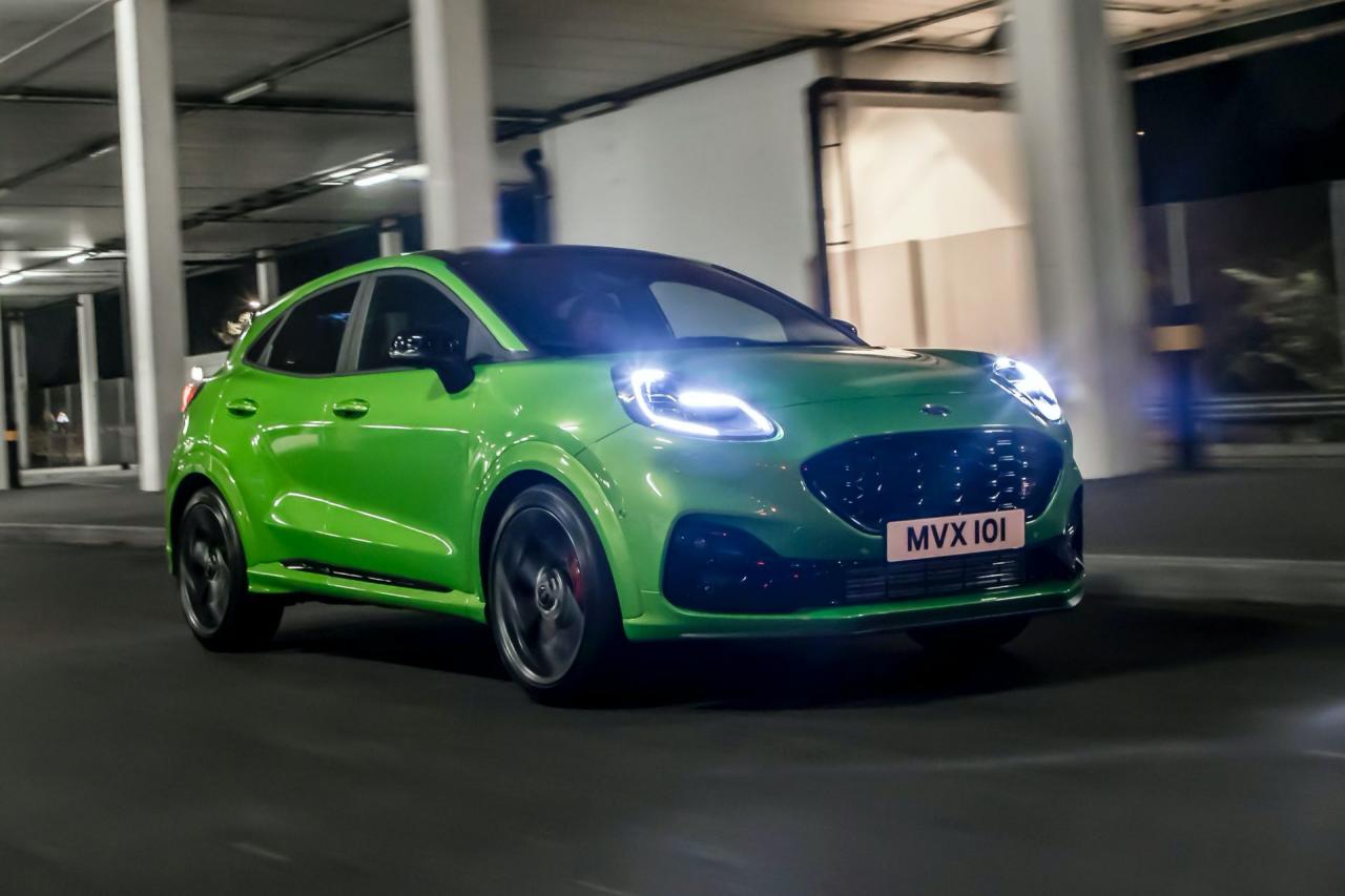

A me piace molto e sono contento che l’allestimento sportivo non abbia snaturato l’aspetto sognante e coccolone che ha.
È oggettivamente la trasposizione automobilistica di un Quokka.
41 minuti fa, Cole_90 scrive:
Visto il colore e gli "occhi" sporgenti pensavo più a una rana :D
Then go racin' in the street
bella la nuova Maserati Grecale!
Non mi dispiace, ma mi ha sempre dato l'impressione di due auto incollate insieme. L'anteriore di un SUV e il posteriore di una hatch. Probabilmente a causa del muso visivamente molto alto e della linea di cintura che risale. Boh, non riesco ad abituarmici
Il muso con i fari alti e verticali continuo a trovarlo sproporzionato, anche se dal vivo è meno terribile di quanto pensassi. A parte questo mi piace molto, le recensioni che ho letto sono tutte positive, soprattutto per la guidabilità, e anche con questa versione ST mi pare abbiano fatto un bel lavoro. L'unica "critica" che posso fare è per la mancanza di un cambio doppia frizione: va benissimo il manuale per gli appassionati, ma con un robotizzato optional avrebbe attirato una clientela più ampia.
Su strada trovo già la "normale" ST-Line molto carina... questa è proprio bellina... quel verde poi 💌
