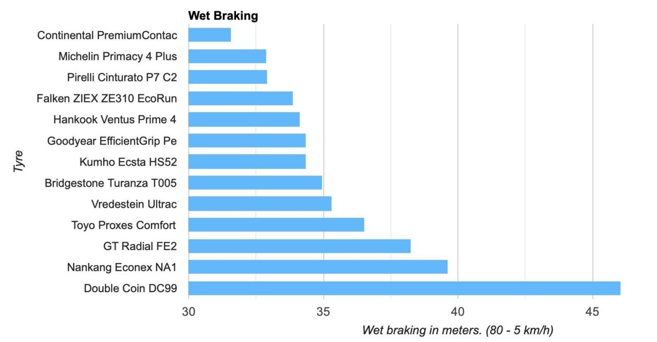

Confronto di spazi di frenata da Tyrereview. Molto interessante. Metto link in fondo ai test di confronto completi.
Estive:
___________________________________________________________________________________________________________________________________________________________________________________________________________________
Termiche (invernali):
4 stagioni:
Confronto estive: https://www.tyrereviews.com/Article/2023-Tyre-Reviews-Summer-Tyre-Test.htm
Confronto invernali: https://www.tyrereviews.com/Article/2023-Tyre-Reviews-Winter-Tyre-Test.htm
Confronto quattro stagioni: https://www.tyrereviews.com/Article/2023-24-Tyre-Reviews-All-Season-Tyre-Test.htm
