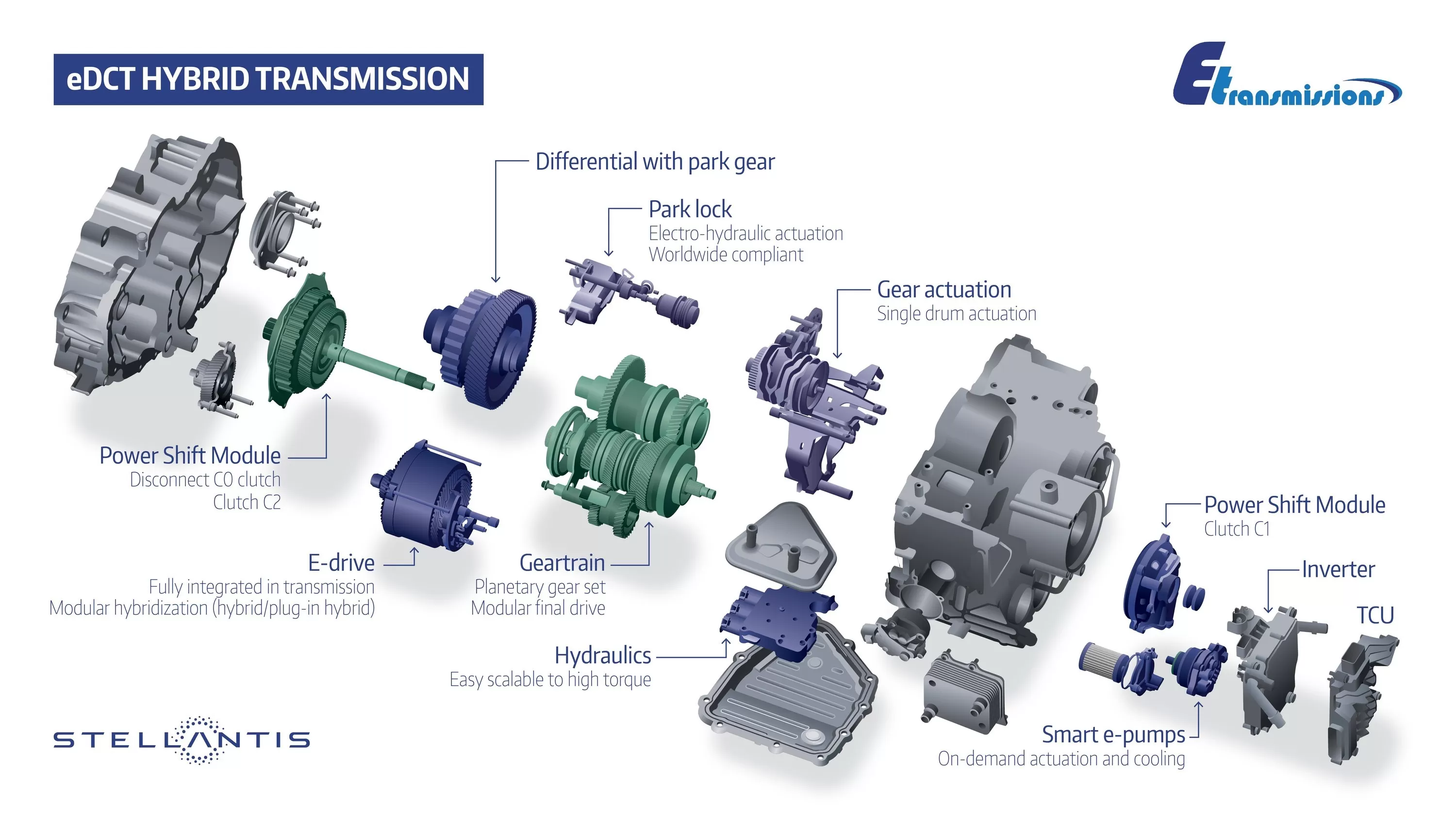

Ecco i dettagli sul motore MHEV
Announcing new HYBRID Technology
PEUGEOT is introducing new hybrid technology with MHEV 48v and we will have a strong roll out in this year with 208, 2008, 308, 3008, 5008 and 408. The PEUGEOT Hybrid 48V system consists of a new-generation 100hp or 136hp PureTech petrol engine, coupled to an unprecedented 6-speed electrified dual-clutch gearbox (E-DCS6) which incorporates an electric motor (21 kW). Thanks to a battery that recharges while driving, this technology offers increased low-end torque and a 15% reduction in fuel consumption (from 126g of CO2/km in 3008). In urban driving, a C-segment SUV equipped with the HYBRID system can thus operate more than 50% of the time in 100% zero-emission electric mode. It also allows you to drive in zero emission mode in urban use
Il concetto è interessante, ma mi aspetto un buon sovrapprezzo rispetto ai motori attuali che non sono neanche mild hybrid
Ma questo non corrisponde al sistema utilizzato anche sul FF 1,3 e 1,5? Ci sono delle differenze? Quali sono i vantaggi/svantaggi?
