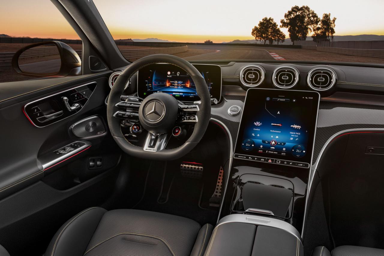

Il display che funge da cruscotto all'interno ha una grafica dedicata, mentre fa debutto - sullo sterzo - un nuovo manettino per il recupero della quantità di energia in frenata: il sistema può arrivare fino alla guida "One Pedal Feeling".

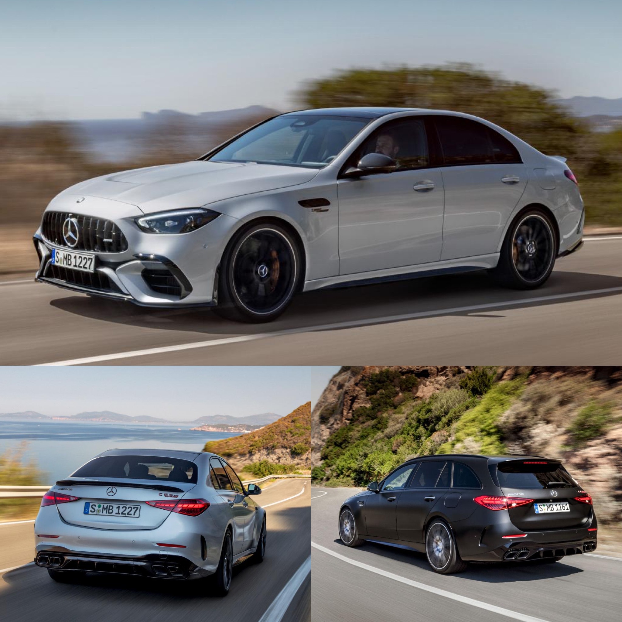

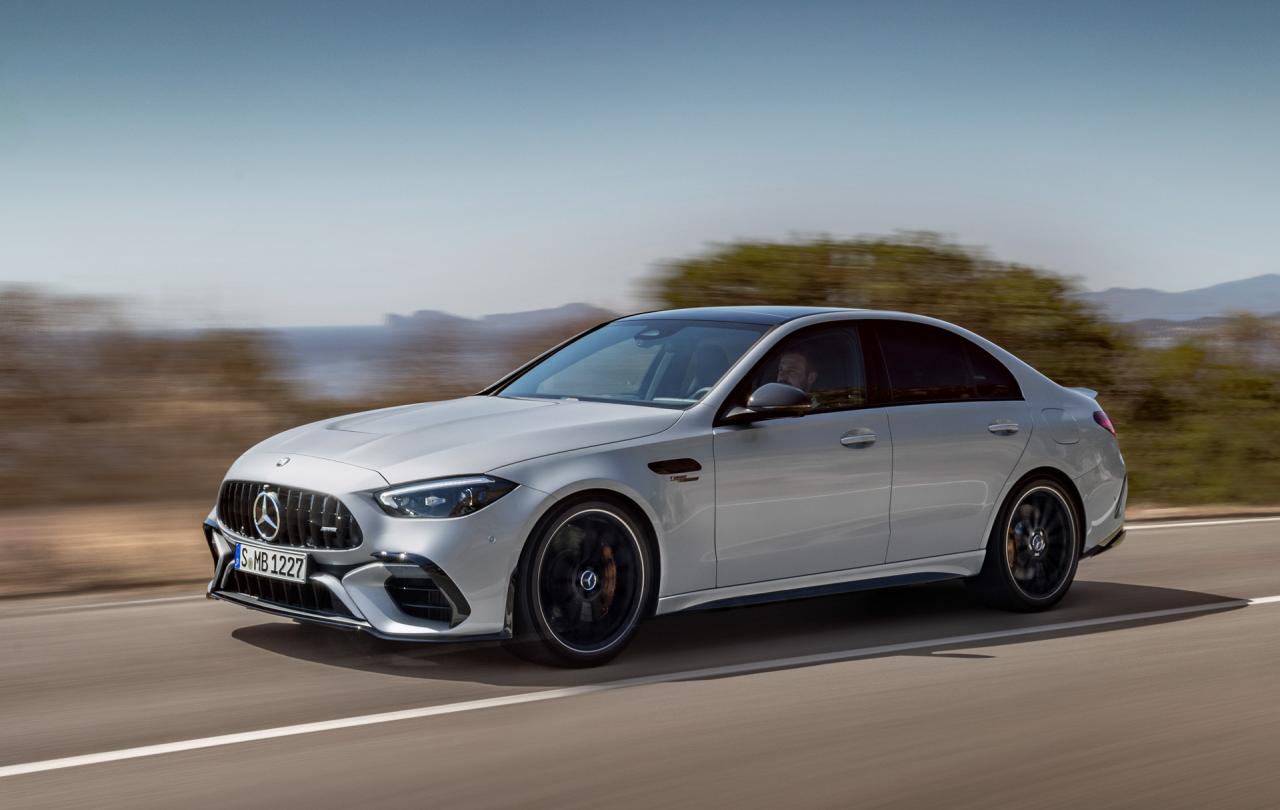

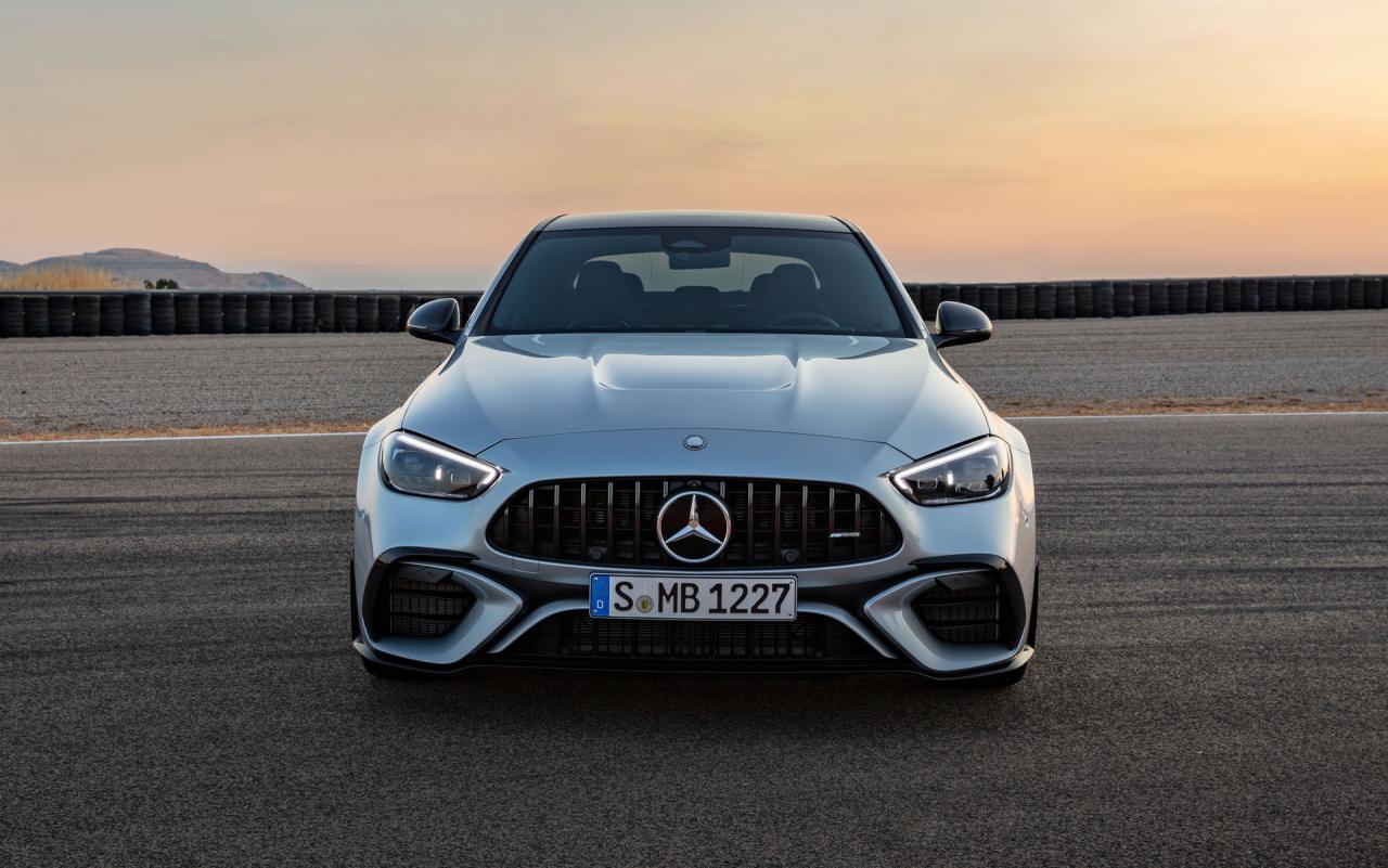

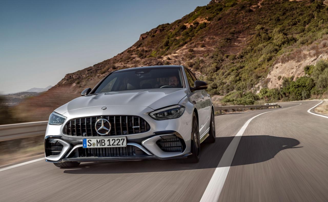

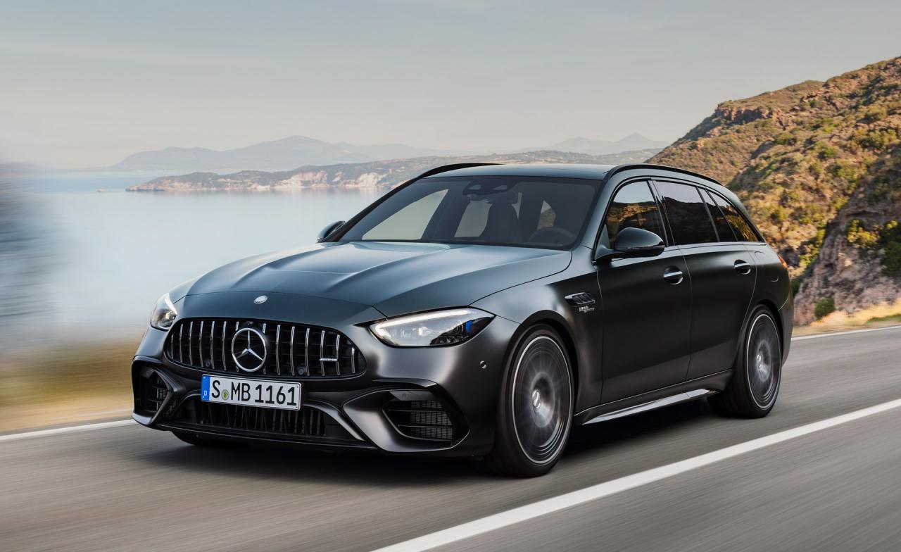

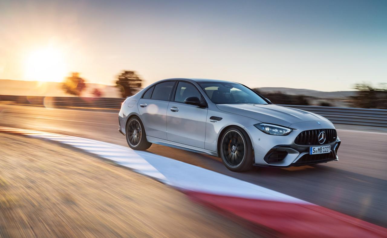

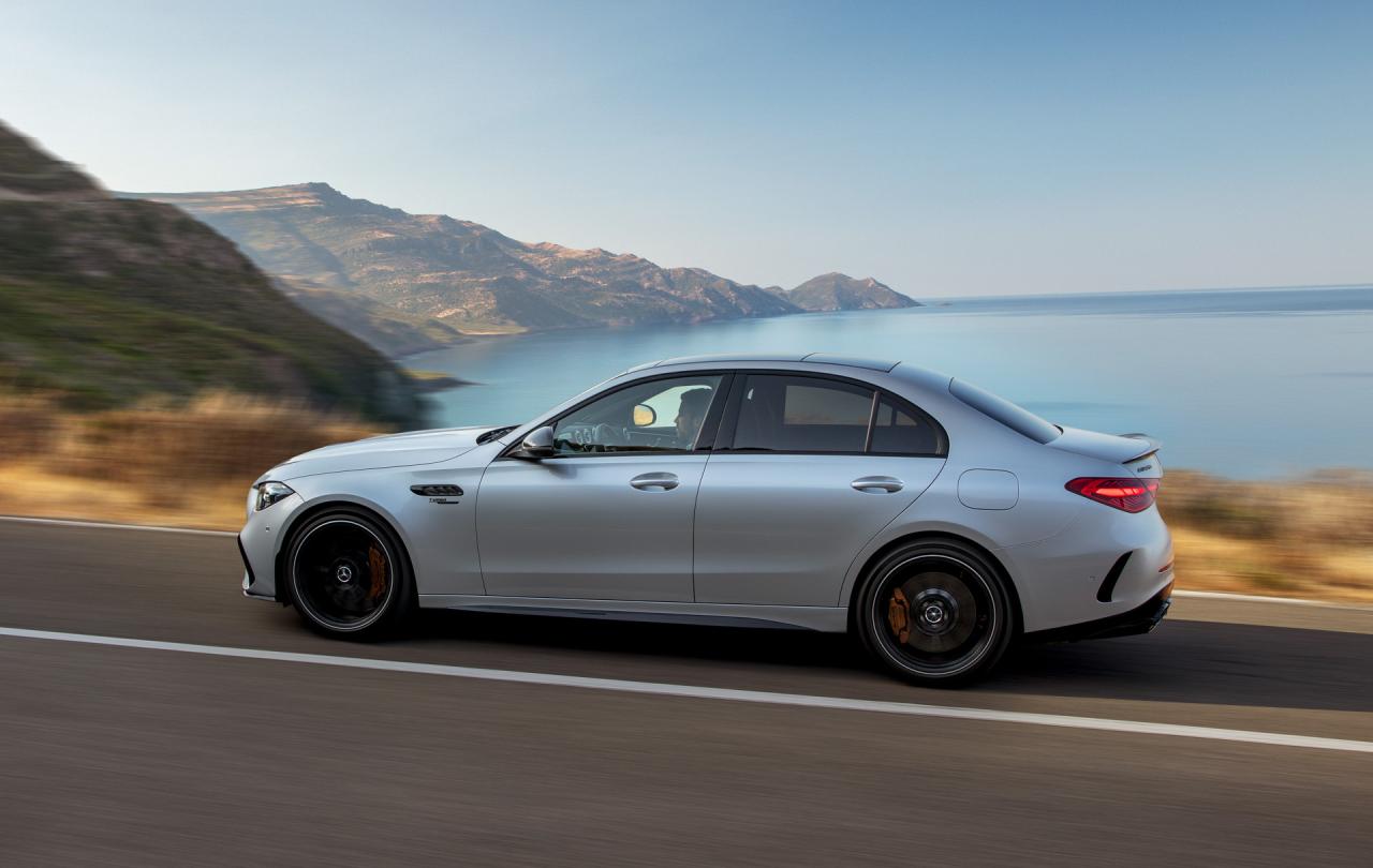

Esteticamente come la riconosciamo?

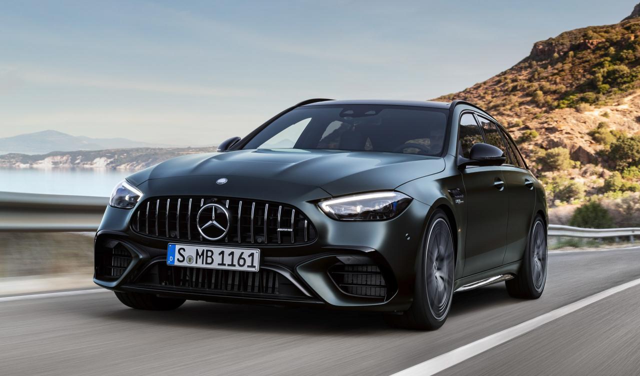

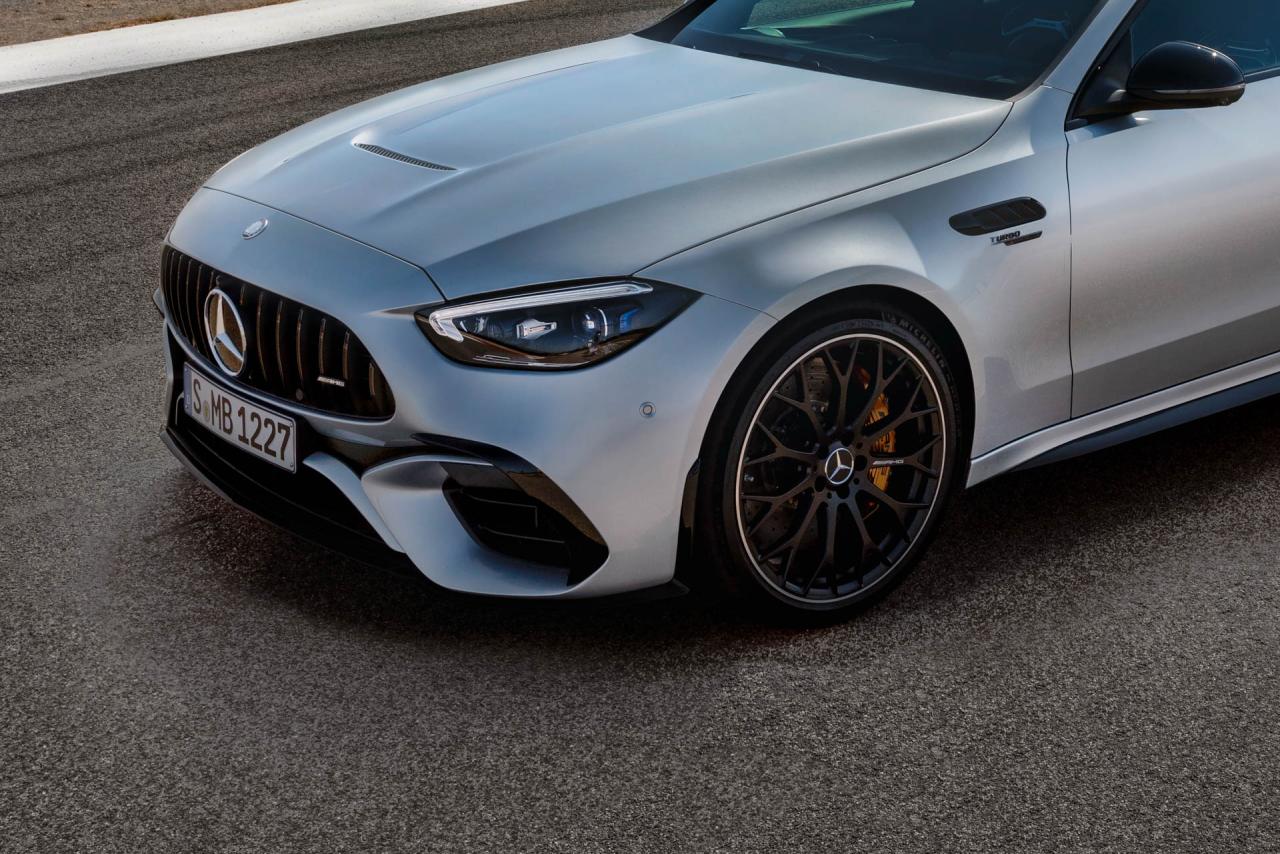

La griglia Panamericana è ormai un segno distintivo per le nuove AMG, mentre l'impronta a terra è garantita da un allargamento mostruoso delle carreggiate: + 76 mm!

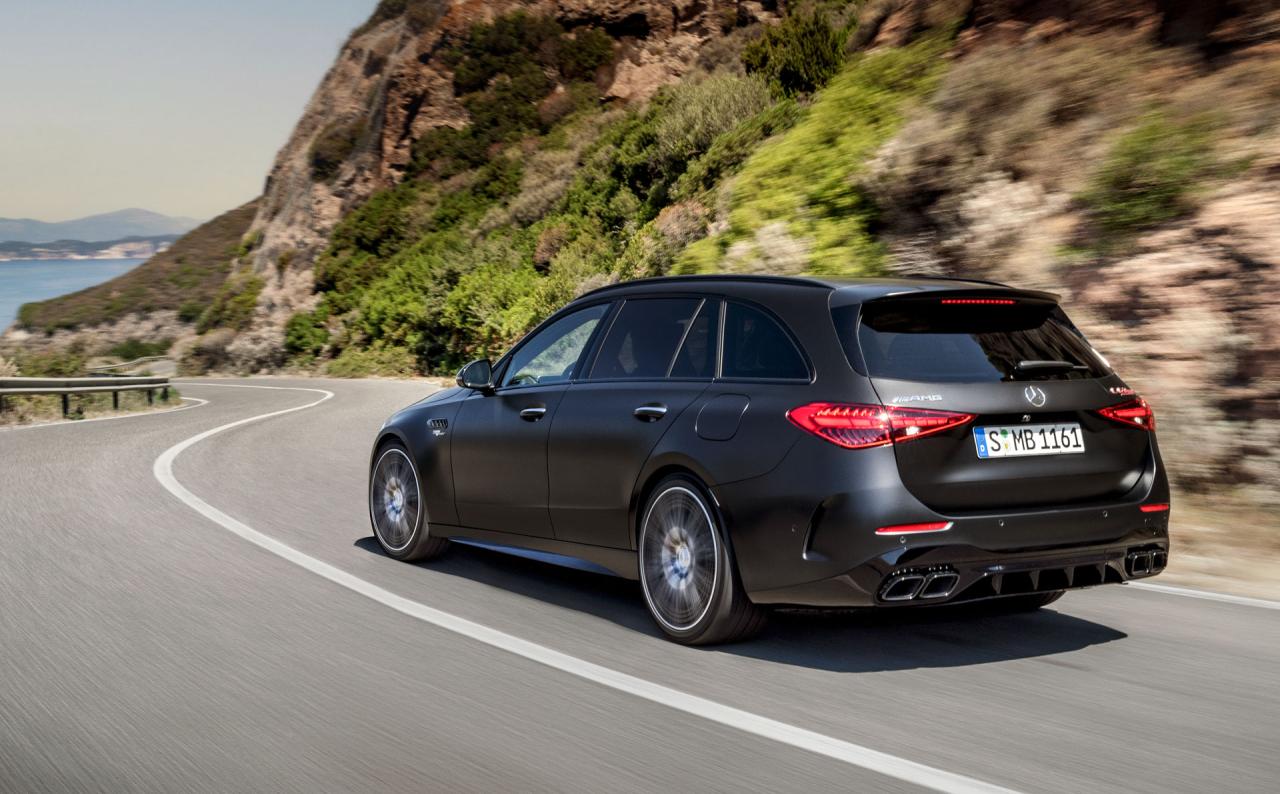

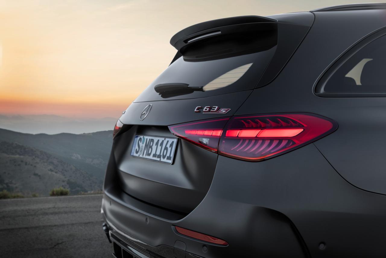

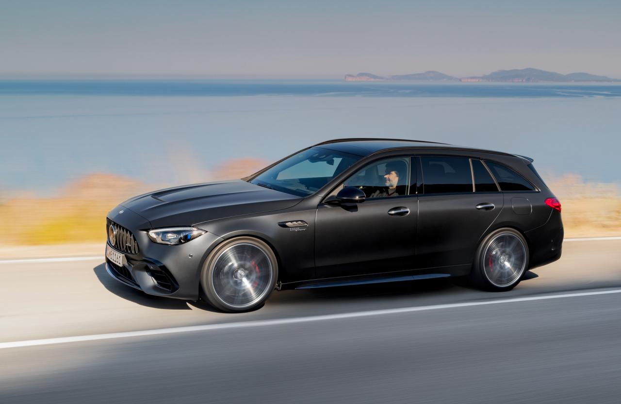

Ovviamente disponibilità anche per la Wagon, che con soli 34 kg in più della berlina, garantisce le medesime prestazioni...MA una velocità massima limitata a 270 km/h anziché a 280 km/h come per la berlina.

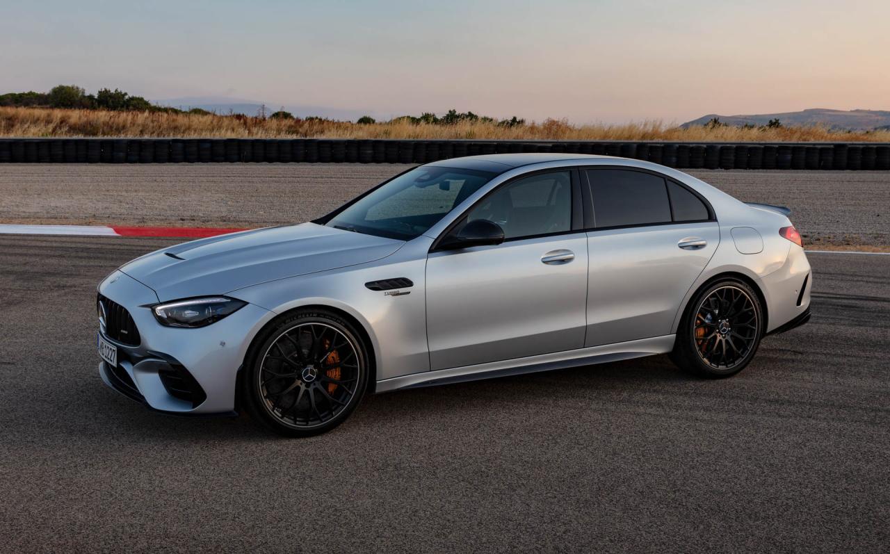

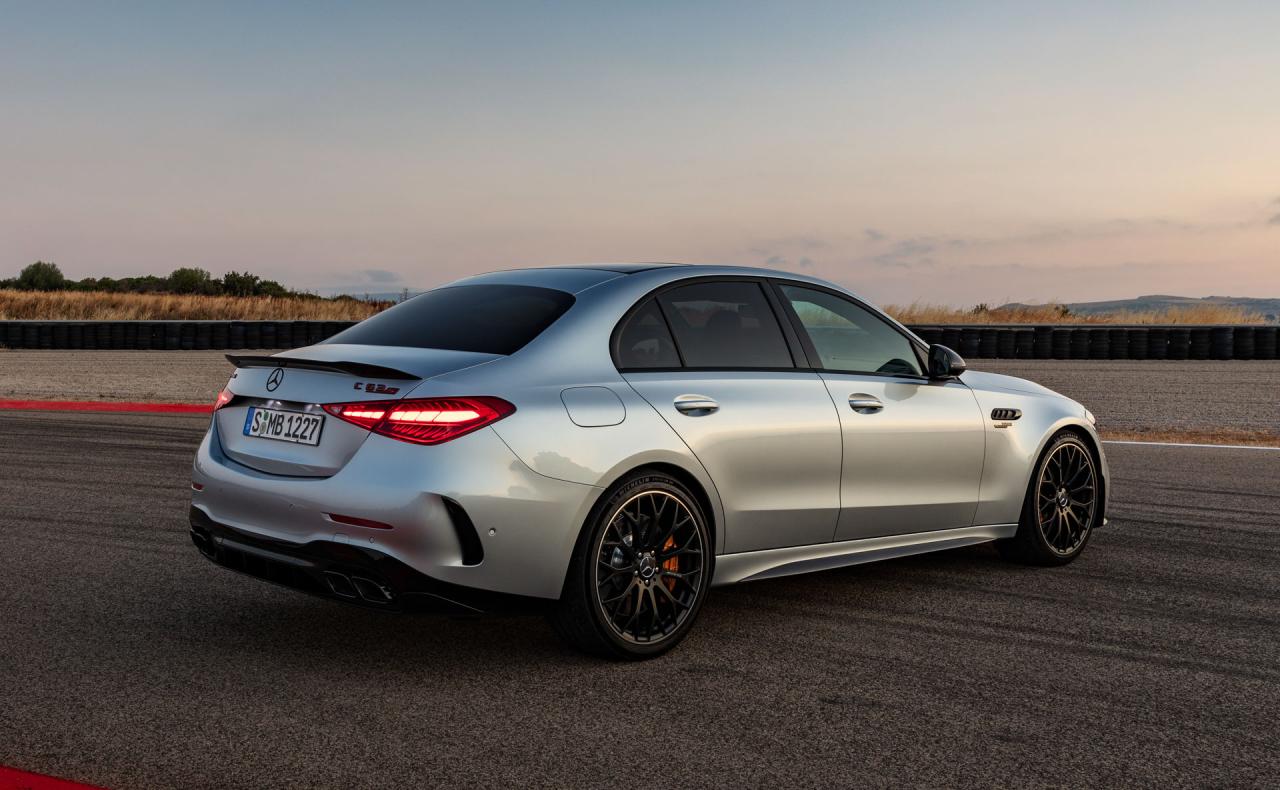

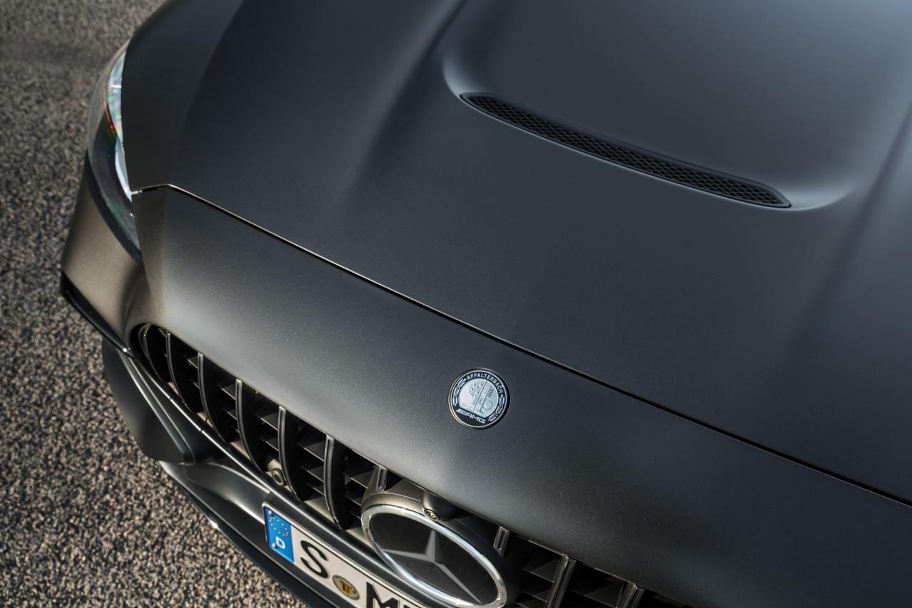

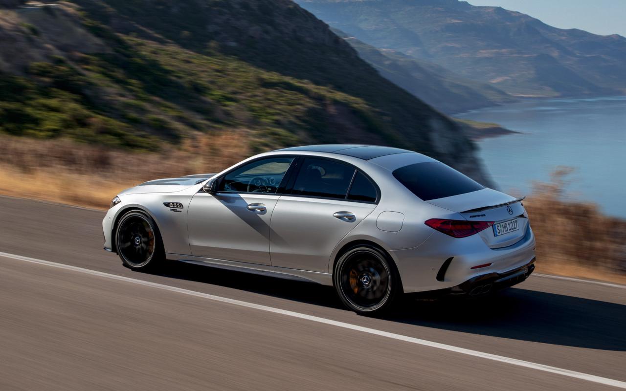

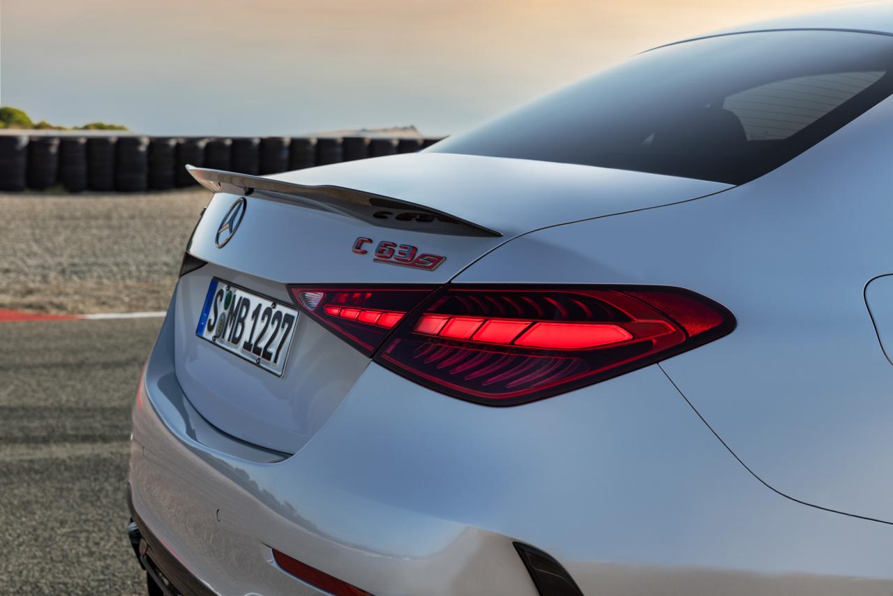

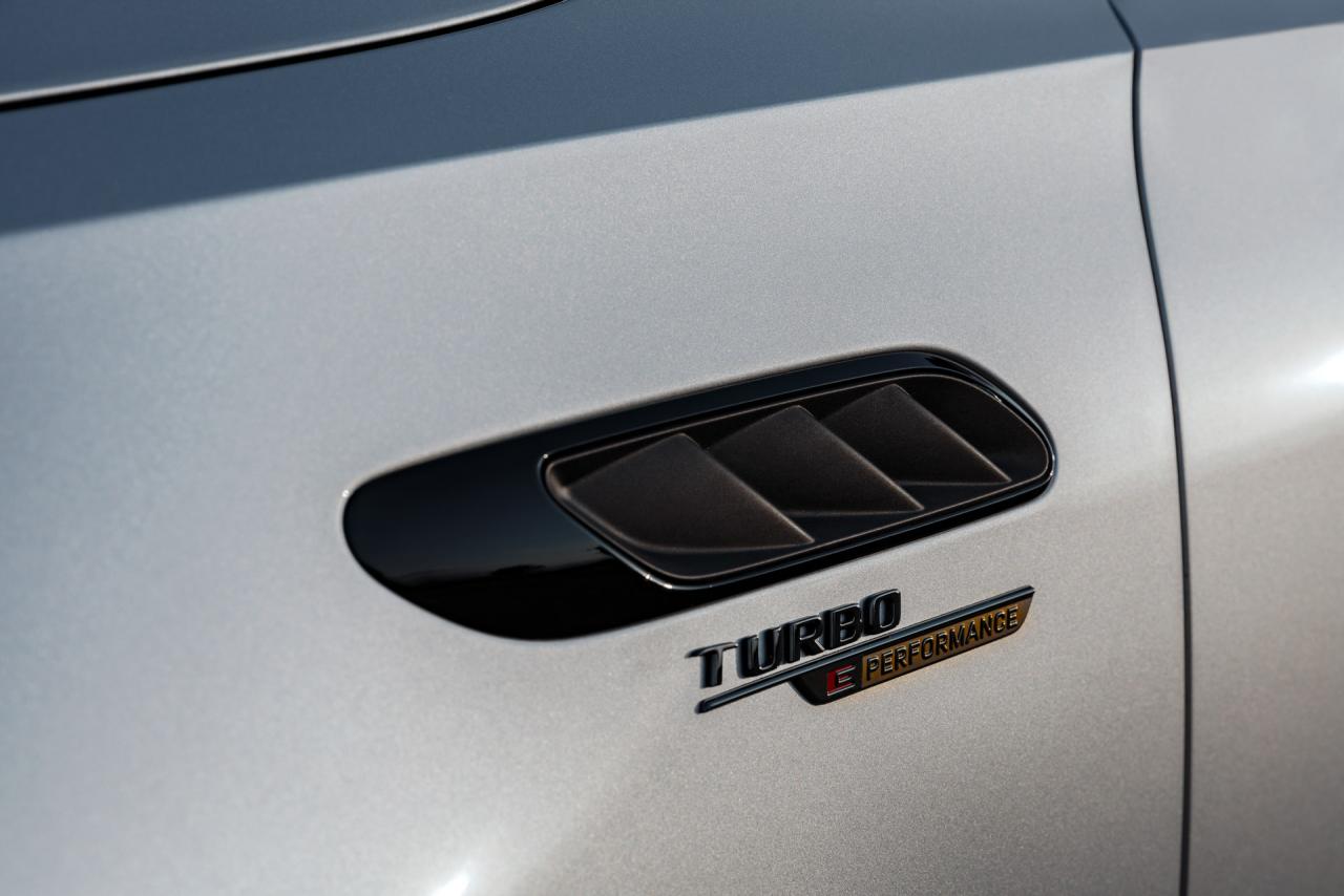

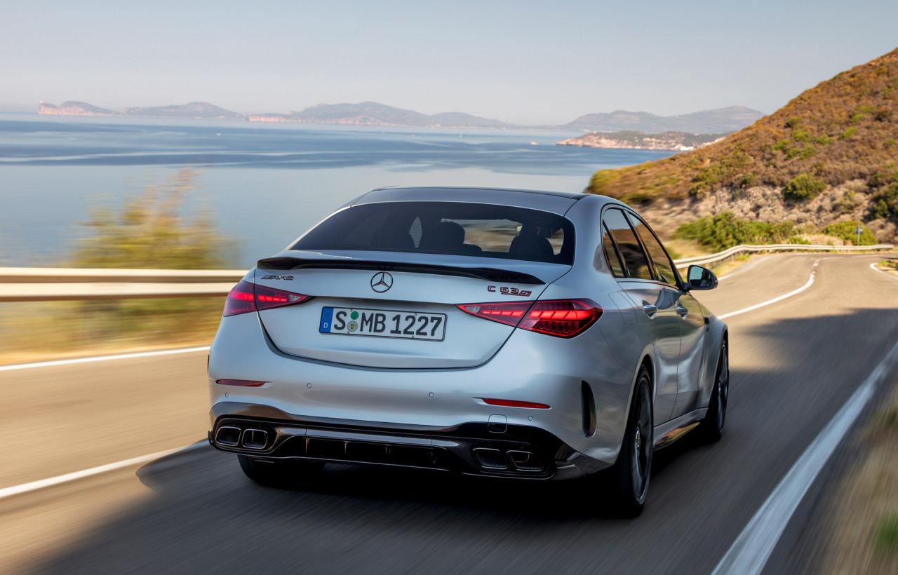

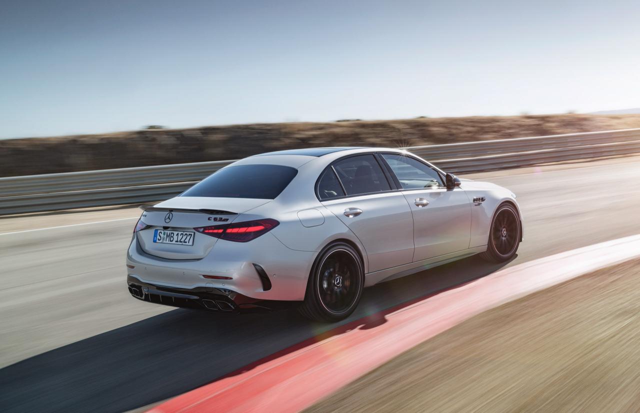

Expressive design with striking front apron
Form follows function: the design of the new C 63 S differs from that of the Mercedes-Benz C-Class in its more muscular proportions. The Saloon and Estate models are both based on an extensively modified AMG bodyshell. The front end is 50 millimetres longer and the front wings are wider. All in all, the overall exterior dimensions differ considerably from those of the Mercedes-Benz C-Class. In terms of length, the Saloon and Estate measure an extra 83 millimetres. The wider track width at the front axle results in 76 millimetres more overall width at the front. And the wheelbase has grown by ten millimetres. All in all, this results in a layout that gives the new C 63 S a powerful, stretched and muscular look.
A new distinguishing feature, and one that is exclusive to the C 63 S, is the slim air outlet in the centre of the bonnet that transitions elegantly into the two powerdomes. A small but particularly fine detail: for the first time on a Mercedes-AMG production model, a round badge with a black AMG emblem replaces the Mercedes star with laurel wreath on the bonnet. Further typical elements include the AMG-specific radiator grille with vertical struts and the AMG front apron in jet-wing design. Flics, large inlets and air curtains direct the airflow specifically to its various functions. Two electronically controlled AIR PANELS (behind the radiator grille and in the front apron) allow the air to be regulated as required.

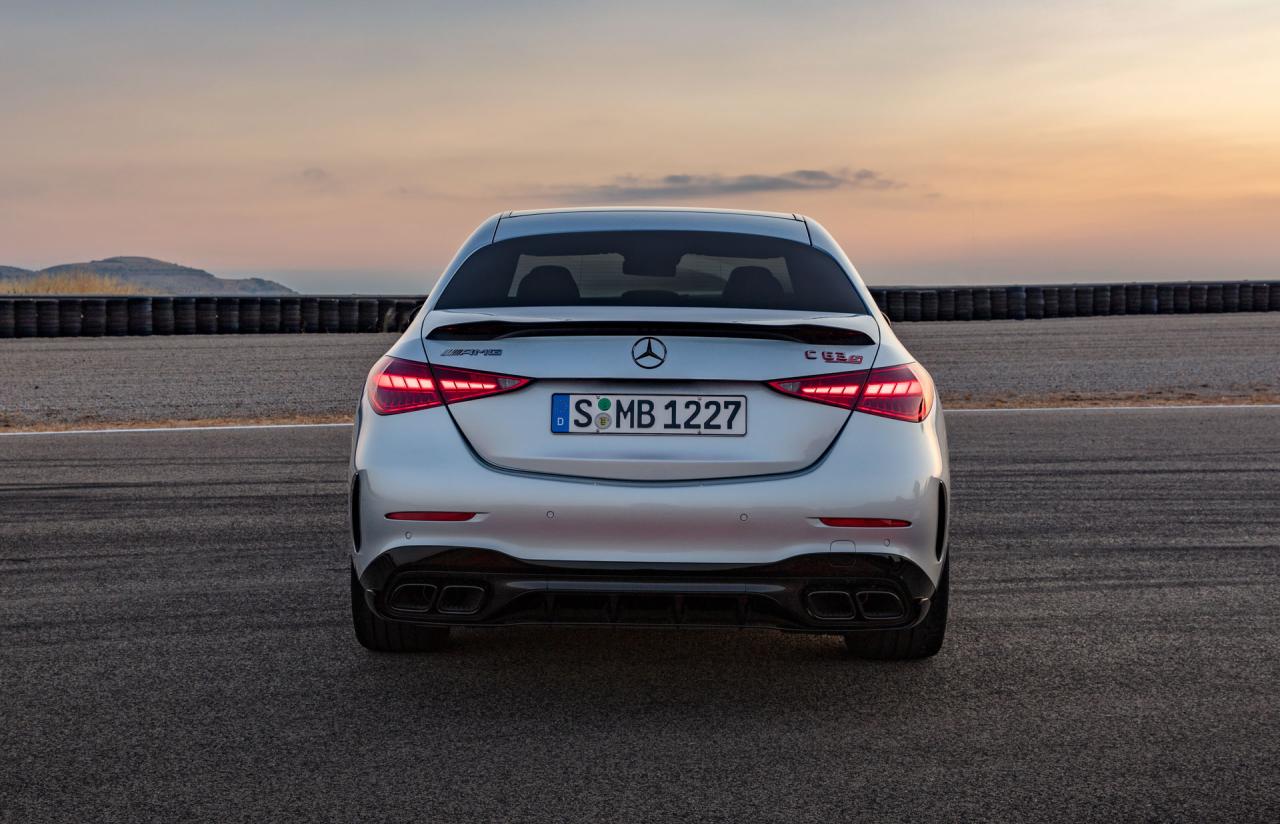

Matching side skirts, the rear apron with large diffuser as well as the two trapezoidal, externally ribbed dual tailpipe trims round off the design. Exclusive details at the rear include the special airflow breakaway edge on the boot lid (roof spoiler on the Estate), the plug-in charging flap and the model designation set against a red background. The "E PERFORMANCE" badge on the wings indicates the hybrid drive. The C 63 S rolls on 19‑inch AMG light-alloy wheels and mixed tyres as standard. Optional wheel/tyre combinations are available in 20-inch size, likewise with mixed tyres, among them a new forged wheel.
Numerous paint finishes and equipment items are also available to provide further individualisation. The AMG matt paint finish graphite grey magno is available exclusively for the C 63 S. The exterior design can be further accentuated with the AMG Exterior Carbon Fibre packages I and II, the AMG Night packages I and II or the AMG Aerodynamics Package.

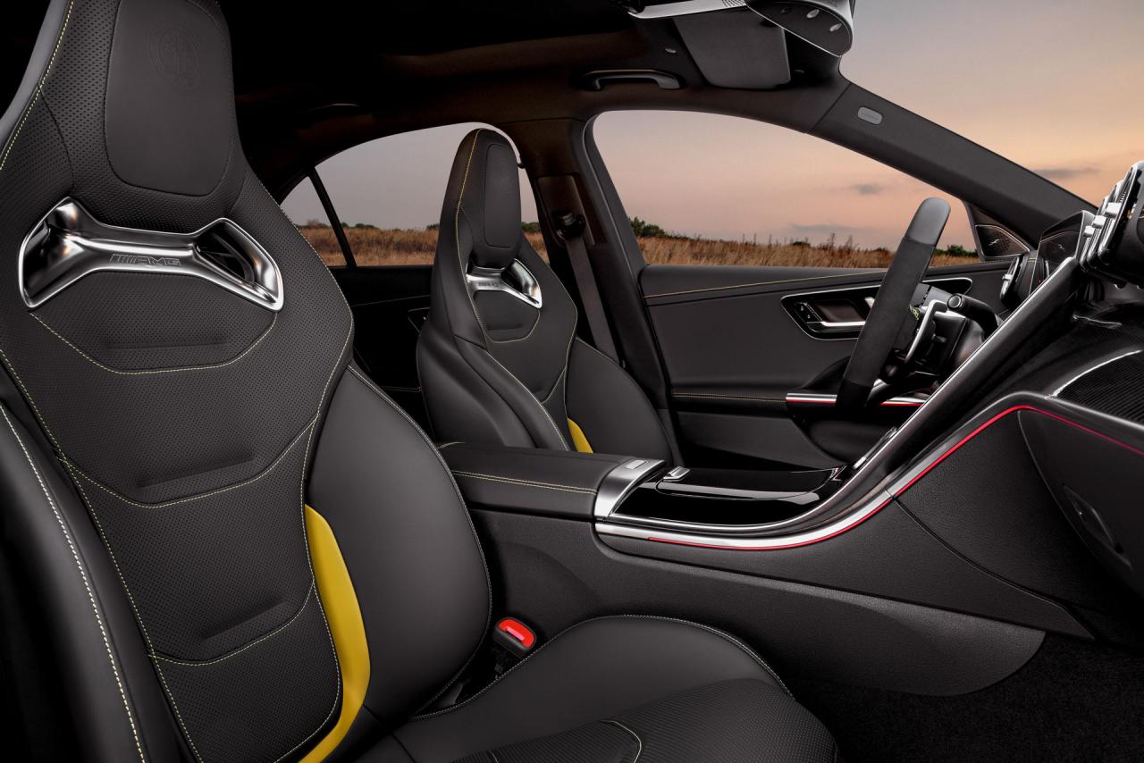

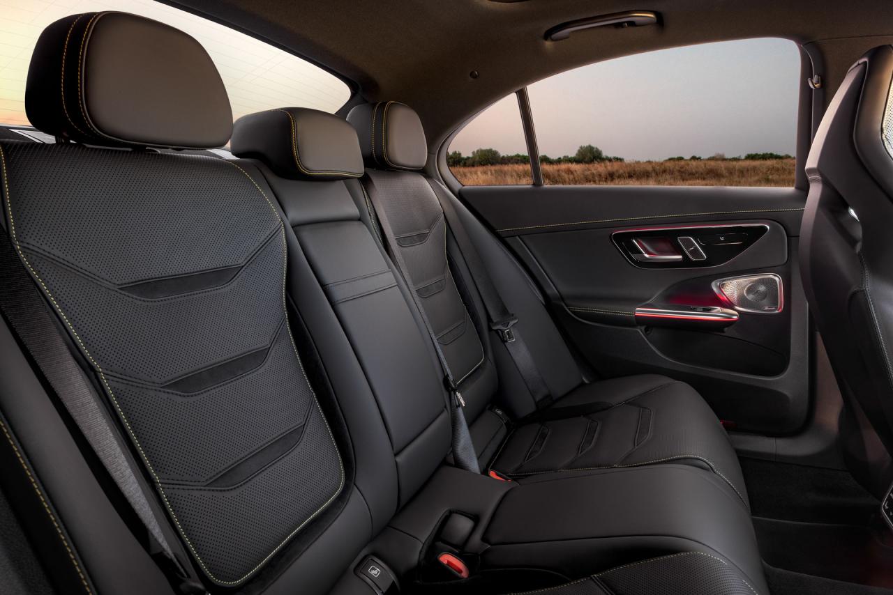

Stylish interior, new generation of the AMG Performance seat
In the interior, AMG sports seats with special upholstery layout and a distinctive stitching pattern add to the refined impression. There are also many individual choices available for the interior. Exclusive colours and various nappa leather upholsteries with an embossed AMG emblem in the front head restraints serve to emphasise either the sporty or the luxurious side of the C 63 S.
The completely redesigned second-generation AMG Performance seat is available as an option. Its special feature is the seat side bolsters with weight-saving openings that also allow better ventilation. If nappa leather upholstery is selected, these also feature a contrasting colour as an extra highlight. The shape of the backrest tapers towards the bottom. The AMG logo is now positioned between the matt chrome openings below the integrated head restraint.

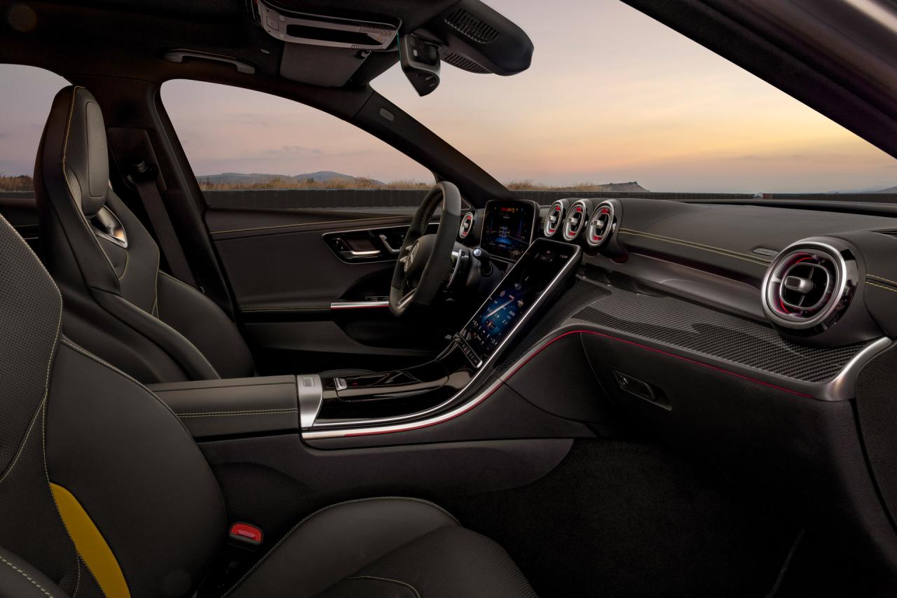

MBUX multimedia system with hybrid-specific displays
The MBUX infotainment system includes various AMG- and hybrid-specific displays and functions. These include special displays in the instrument cluster, on the portrait-orientation multimedia central display in the centre console and on the optional head-up display.
The appearance of the instrument cluster can be personalised with different display styles and individually selectable main views. The AMG-specific Supersport style offers the option of displaying various contents via a vertical menu structure. These include a menu with hybrid-specific temperatures or a setup menu that displays the current settings for the suspension or transmission. In addition, the driver can also have a navigation map or consumption data displayed in the Supersport style.
The head-up display, too, offers AMG-specific display styles such as Race and Supersport. These can be accessed via the main menu in the instrument cluster. High-quality graphics in the multimedia display also visualise in an AMG-specific manner such details as the power flow of the entire drive system, engine speed, power, torque and temperature of the electric motor, as well as the battery temperature.
Added to this is the shortcut button for the AMG DYNAMIC SELECT drive programs. AMG TRACK PACE, the data logger for use on the race track, is also integrated. The software records more than 80 vehicle-specific data such as speed, acceleration, steering angle and brake pedal actuation ten times per second while driving around a race track. In addition the lap and sector times are displayed.
AMG Performance steering wheel in twin-spoke design
The standard AMG Performance steering wheel with its distinctive twin-spoke design and seamlessly integrated control buttons also offers tangible and visible added value. The round AMG steering wheel buttons impress with brilliant displays and their perfect turn-and-press operating logic. This allows important driving functions and all driving modes to be controlled without the driver having to take their hands off the steering wheel. As a new feature, it is possible to select the regeneration levels of the hybrid drive via the steering wheel buttons.

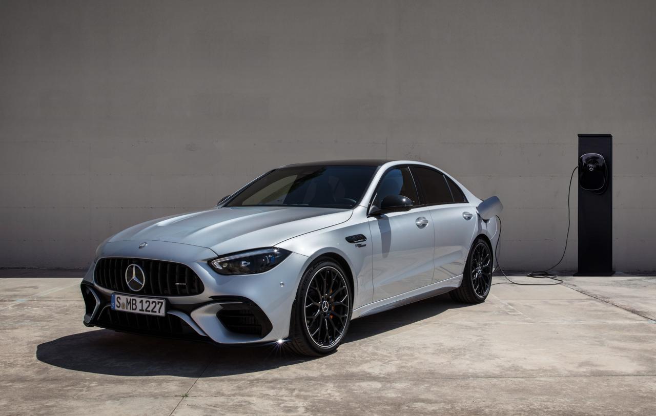

Inspired by Formula 1, developed in Affalterbach: the AMG high-performance battery
When the electrification strategy was being defined, it was clear from the outset that all essential components would be developed in Affalterbach. Among these is the AMG high-performance battery (HPB). The development of the lithium-ion energy storage system is inspired by technologies that have already been proven in the Mercedes-AMG Petronas F1 Team's Formula 1 hybrid racing cars. In the course of development, there was a lively exchange of expert knowledge between the High Performance Powertrains (HPP) Formula 1 engine shop in Brixworth and Mercedes-AMG in Affalterbach. The AMG high-performance battery combines high power that can be called up frequently in succession with low weight to increase the overall performance of the vehicle. Added to this are the fast energy draw and the high power density. This means that during a brisk drive in hilly terrain, for example, drivers can immediately call on the full power potential on uphill stretches, while recuperation is strong when driving downhill.
70 kW continuous output and 150 kW peak output
The high-performance battery in the C 63 S E PERFORMANCE offers a capacity of 6.1 kWh, continuous output of 70 kW and a peak output of 150 kW for ten seconds. The low weight of only 89 kilograms allows the very high power density of 1.7 kW/kg. For comparison: conventional batteries without direct cooling of the cells achieve about half this figure. Charging is via the 3.7 kW on-board AC charger, at a charging station, wallbox or household socket. The battery is designed for fast power delivery and draw, not for the longest possible range. Nevertheless, the electric range of 13 kilometres allows a practical operating radius, for example for quiet and emission-free driving from a residential area to the outskirts of the city or to the motorway.

Lo spoliler della Giulia Q ha fatto scuola…
