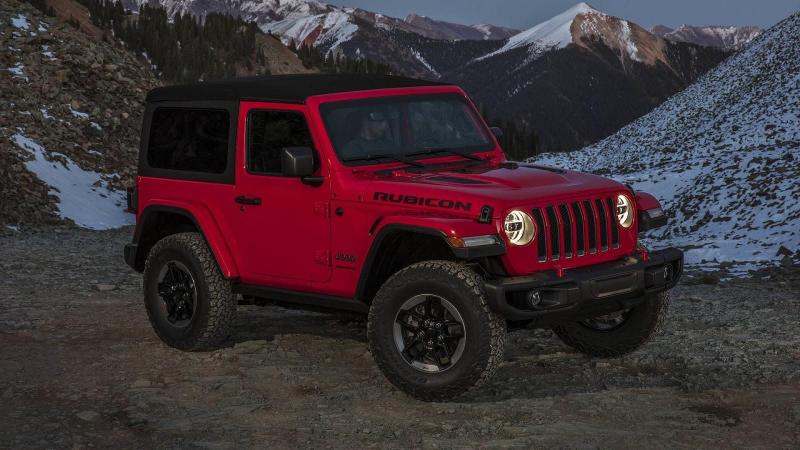

10 ore fa, Bare dice:
Here are the official specifications and wallpapers for the 2018 Jeep Wrangler JL.
ENGINE: 3.6-LITER PENTASTAR V-6
  • Available: Standard on all models
  • Type: 60-degree, V-type, liquid-cooled
  • Displacement (cu. in. / cc): 220 cu. in. (3,604 cu. cm)
  • Bore x Stroke: 3.78 x 3.27 (96 x 83)
  • Valve System: Chain-driven DOHC, 24 valves and hydraulic end-pivot roller rockers
  • Fuel Injection: Sequential, multiport, electronic, returnless
  • Construction: Aluminum deep-skirt block, aluminum alloy heads
  • Compression Ratio: 11.3:1
  • Power (SAE net) (hp / kW@rpm): 285 hp (209 kW) at 6,400 rpm
  • Torque (SAE net) (lb.-ft. / N•m): 260 lb.-ft. (353 N•m) at 4,800 rpm
  • Max. Engine Speed (rpm): 6,600 rpm (electronically limited)
  • Fuel Requirement: Unleaded regular, 87 octane (R + M)/2
  • Fuel Tank Capacity (gallons): 18.5 (2-door), 21.5 (4-door)
  • Oil Capacity: 5.0 quarts (4.7 liters)
  • Coolant Capacity: 10 quarts (10.1 liters)
  • Emission Controls: Dual three-way catalytic converters, heated oxygen sensors and internal engine features
  • Max. Gross Trailer Weight: 2,000 lbs. (2-door), 3,500 lbs. (4-door)
  • EPA Fuel Economy mpg (city/hwy/combined): 18/23/20 (automatic); 17/23/19 (manual)
  • Assembly Plant: Saltillo South Engine Plant, Saltillo, Coahuila, Mexico

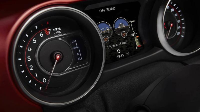

TRANSMISSION: 850RE AUTOMATIC, EIGHT-SPEED OVERDRIVE
  • Availability: Standard — 2.0-liter I-4; Optional — 3.6-liter V-6
  • Description: Adaptive electronic control or Electronic Range Select (ERS) driver-interactive manual control and electronically modulated torque converter clutch
  • Gear Ratios:
    • 1st - 4.71
    • 2nd - 3.13
    • 3rd - 2.10
    • 4th - 1.67
    • 5th - 1.28
    • 6th - 1.00
    • 7th - 0.84
    • 8th - 0.67
    • Reverse - 3.53

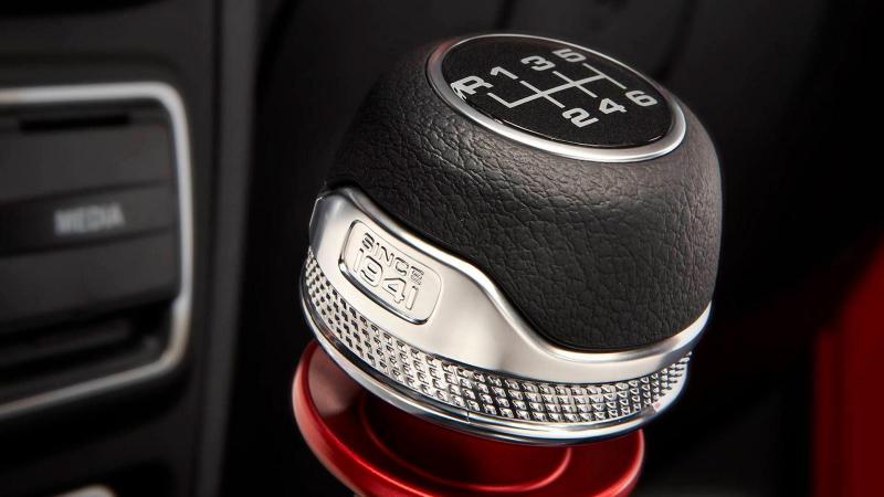

TRANSMISSION: D478 MANUAL, SIX-SPEED WITH OVERDRIVE
  • Availability: Standard — 3.6-liter V-6
  • Description: Synchronized in all forward gears and Reverse, multi-rail shift system with top-mounted shift lever
  • 50% shorter throws
  • Gear Ratios:
    • 1st - 5.13
    • 2nd - 2.63
    • 3rd - 1.53
    • 4th - 1.00
    • 5th - 0.81
    • 6th - 0.72
    • Reverse - 4.49
    • Final Drive ratio - 3.45 standard, 3.73 optional (4.10 Rubicon)

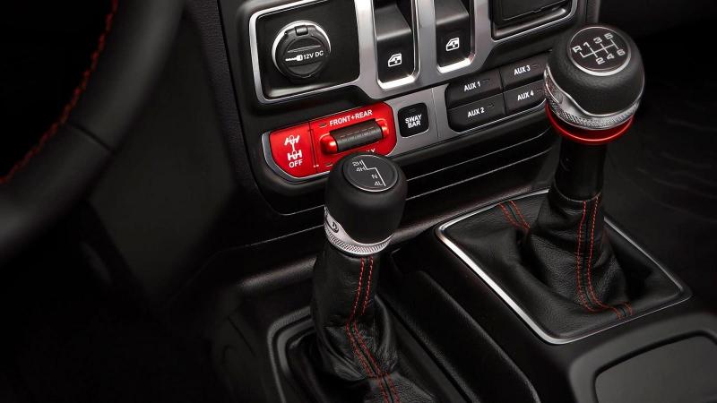

TRANSFER CASE: NV241 COMMAND-TRAC
  • Available: Standard on Sport and Sahara
  • Type: Part-time
  • Operating Modes: 2WD High; 4WD High; Neutral; 4WD Low
  • Low Range Ratio: 2.72:1
TRANSFER CASE: NV241OR ROCK-TRAC
  • Available: Standard on Rubicon
  • Type: Part-time
  • Low Range Ratio: 4.0:1
TRANSFER CASE: MP3022 SELEC-TRAC
  • Available: Optional – Sahara
  • Type: Full-time

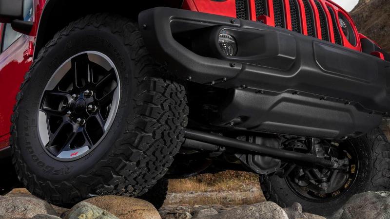

  • Front: Dana 30, Dana 44 on Rubicon models
    • Differential Type: Open (Dana 30) or Tru-Lok electronic locking (Dana 44)
    • Axle Ratios: 3.45, 3.73, 4.10
  • Rear: Dana 35, Dana 44 on Rubicon models
    • Differential Type: Open (Sport and Sahara) with available Trac-Lok anti-spin, Tru-Lok electronic locking (Rubicon)

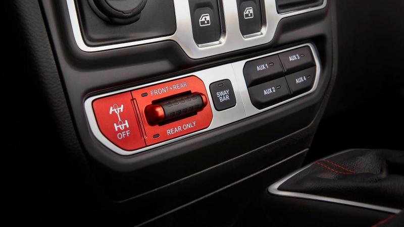

    • Stabilizer bar: Electronic sway-bar disconnect system — standard, Rubicon

  • Rubicon (Standard)
    • Painted pocket with Mid-Gloss paint and polished cast-aluminum
    • Size 17 x 7.5 in.
  • Rubicon (Optional)
    • Size 17 x 7.5 in.
TIRES
  • Sport (Standard)
    • Size and Type: P245/75R17, on/off-road, black sidewall
    • Mfr. and Model: Michelin LTX MS2, Bridgestone Dueler HT 685, Bridgestone Dueler AT RH-S, Goodyear Wrangler Adventure AT
    • Revs per Mile (km):
      • 665 (413) – Michelin LTX MS2
      • 661 (411) – Bridgestone Dueler HT 685 & AT RH-S
      • 668 (415) – Goodyear Wrangler Adventure AT
  • Sahara (Standard)
    • Size and Type: P255/70R18, on/off-road, OWL
    • Mfr. and Model: Bridgestone Dueler HT 685, Bridgestone Dueler AT RH-S, Goodyear Wrangler Adventure AT
    • Revs per Mile (km): 649 (403)
    • Size and Type: LT285/70R17C, on/off-road, black sidewall
    • Mfr. and Model: BF Goodrich KO2 All-Terrain
    • Revs per Mile (km): 645 (401)
